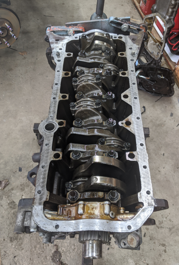

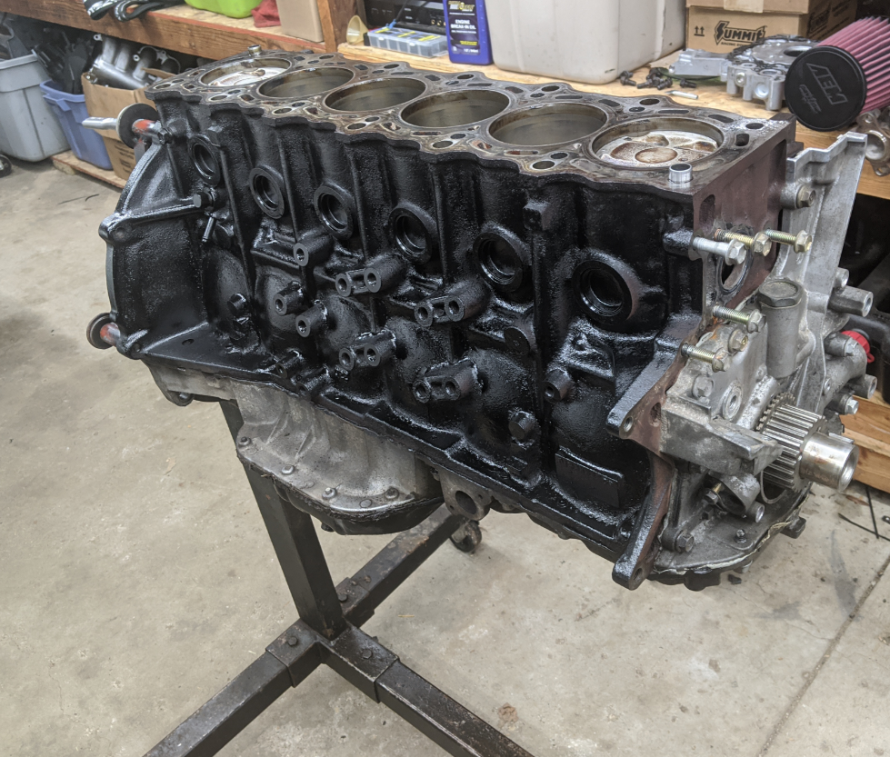

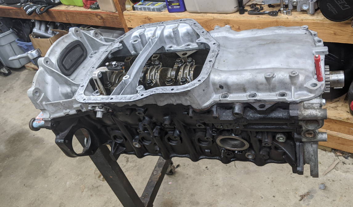

Almost got the pan's cleaned up, just need to finish up the lower pan then i can button up this underbelly.

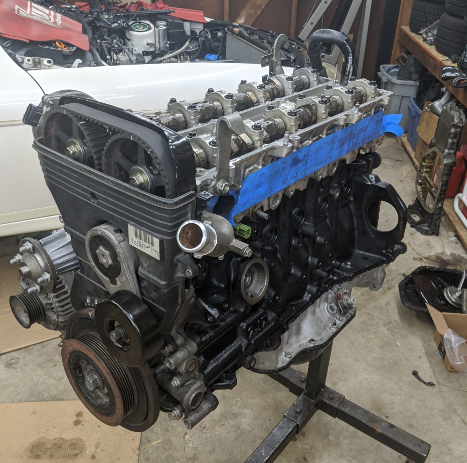

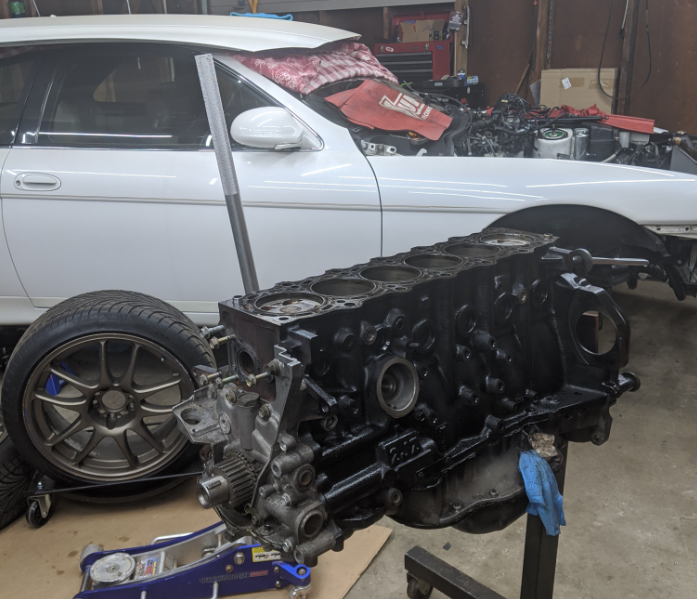

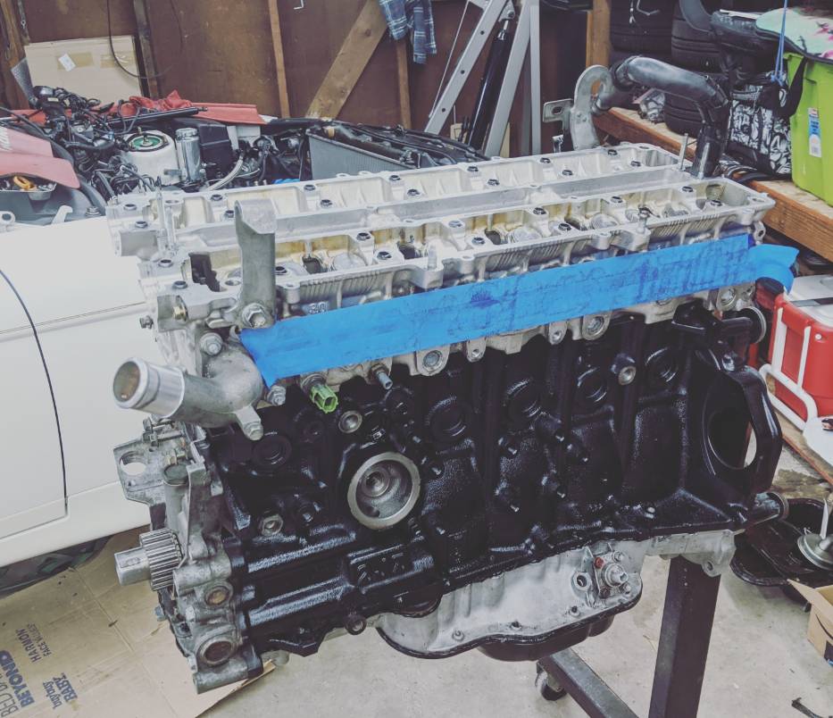

Just need to put it on the ground, setup the bellhousing/flywheel and throw it in the car.
