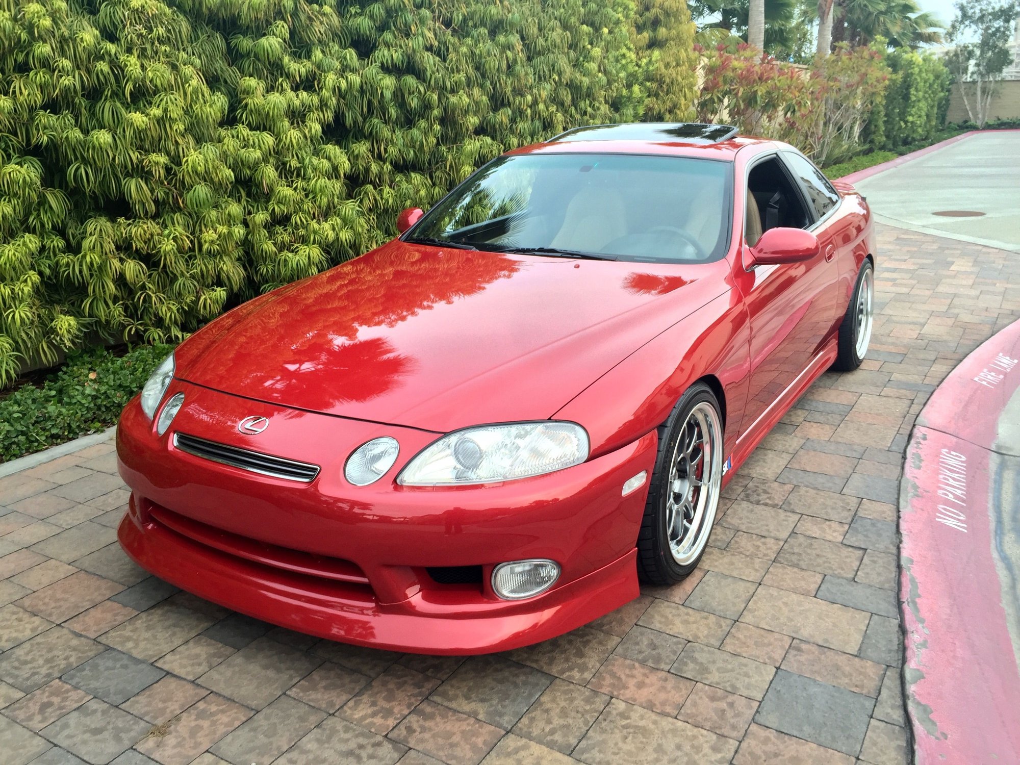

The Tanabe NF210 with KYB is a great set up for that person seeking to keep that smooth stock ride. I had the same setup before I switched to CX Racing coolers.
I just wanted to be able to control my ride height and damper settings thus why I changed to coilovers.
The Tanabe and KYB setup is really nice though.
My old setup:
Old Jun 10, 2015 | 11:06 PM

FSUsucks1,
Thanks for sharing your experiences and the pictures. BTW, what sizes were those wheels and tires shown in your pictures. Did you use spacers to fill out the wheel wells?
Also when changing the coil and shocks, did you replace the strut mounts (top? hats), the bumpers and strut bellows?

Originally Posted by lem321
FSUsucks1,
Thanks again.
They were 18 x 8.5 +16 offset in the front, and 18 x 9.5 +20 offset in the rear. Don't recall the tires sizes. No spacers were used. We did reuse the oem top hats and bumpers.
