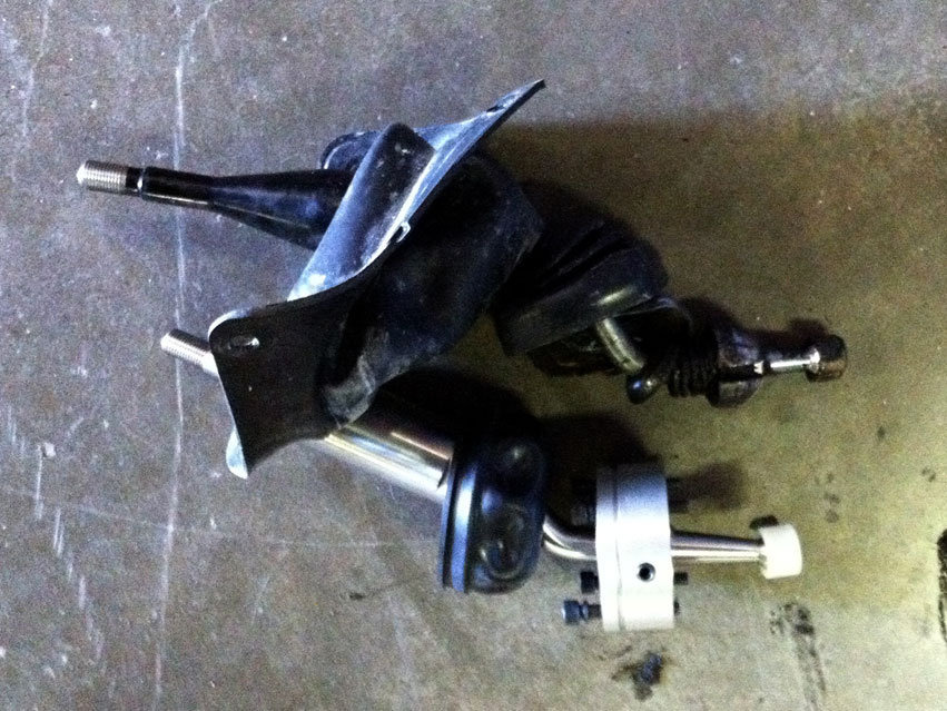

The Suprasport V3 shifter, as I mentioned before, does sit an inch too far forward compared to the SC shifter, however it still works just fine even with the stock leather boot. I thought I'd have to get a custom boot but it isn't necessary. Technically where it sits isn't dead center but it's a very minute change and all gears can be selected with ease. Nothing hits so as to prevent selection. The rubber boot on the shifter itself does hit the plastic console trim (under the upper leather boot) but it impedes nothing.
In use, I prefer the V3 over the stock shifter. If you have the older style W58 in your car I'd recommend it also. The throws are exactly where you want them to be.

And a comparison of the stock 92-94 SC300 5-speed "swan" shifter and the SupraSport V3 short shifter for MKIII Turbos. The V3 is indeed a bit too far forward to be perfect but it works flawlessly in the SC300 without any need to modify the console. The leather boot is stressed just a little but not by much.
