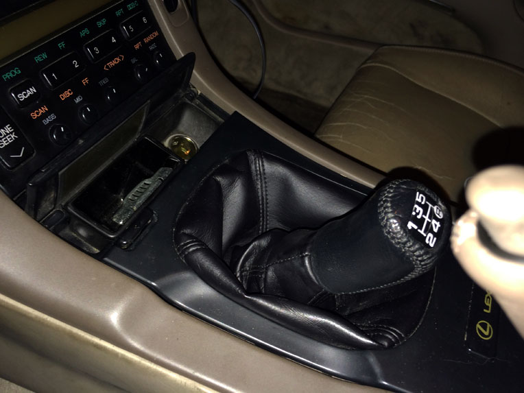

Neutral
First

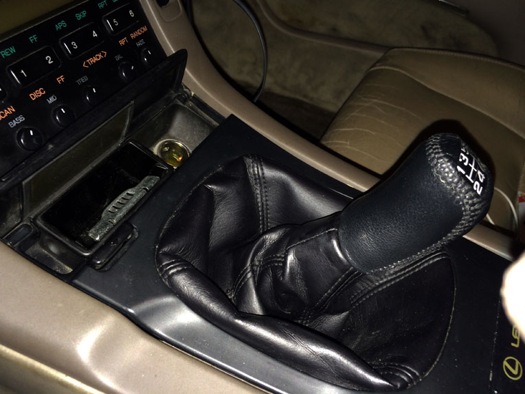

Second

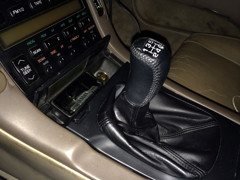

Third

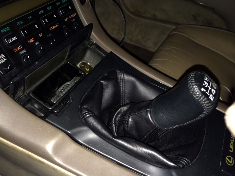

Fourth

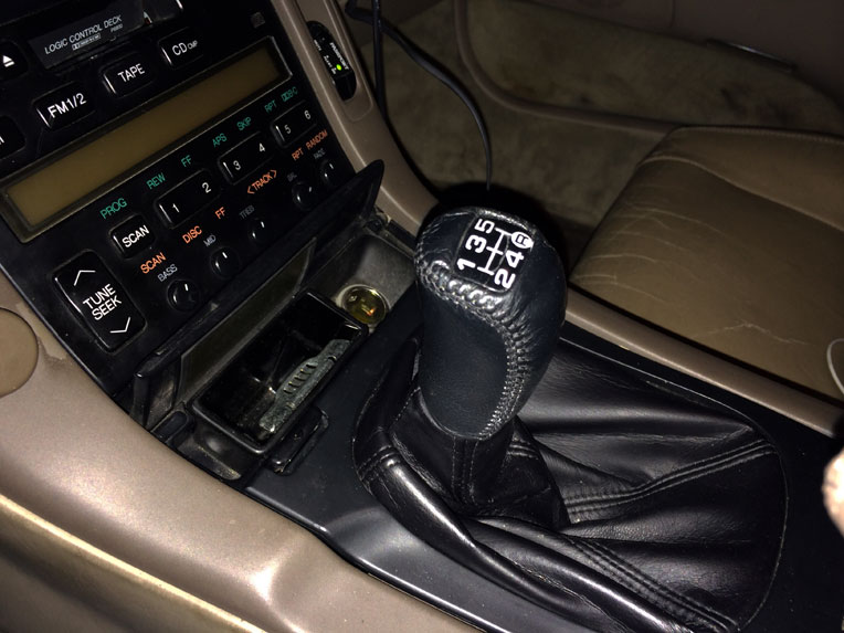

Fifth

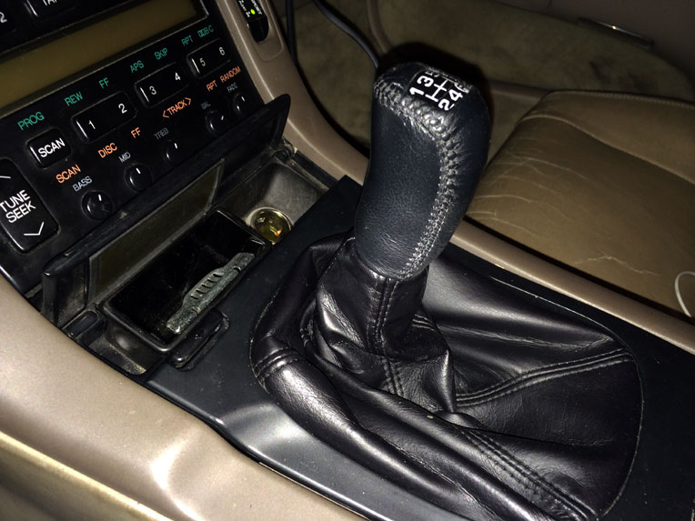

Reverse

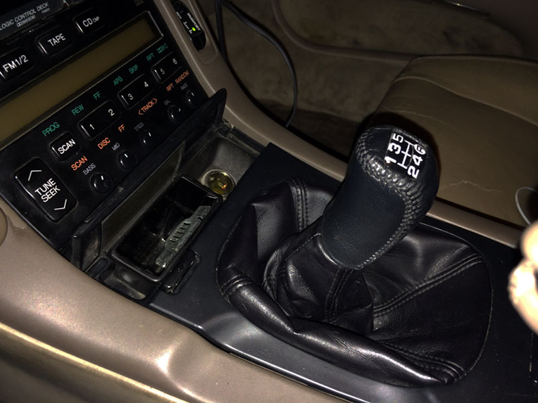

As promised, I finally took some pictures of the SupraSport V3 shifter in the car. Here is every gear change. I will post a video next.

I just had the guys at SpeedForSale in Alpharetta rebuild my JZ/SC converted Supra MKIII R154 transmission using all the Marlin Crawler parts and the Driftmotion 3-4 shift fork and install my setup for me. Jared and Brett are awesome and I highly recommend them. Thought I'd share some early impressions:
I'm still breaking in the clutch and synchros so I haven't taken it over 4,000RPM or really gotten into it. Yet. Probably by the time I get home tomorrow.
In 85 miles of driving the synchros are wearing in nicely but man, what a difference! It's a completely different feel from the W58 in a good way. Where the W58 is certainly an easier transmission to go through the gears in, I think the R154 has far more confidence. There is zero play in my shifter (a SupraSport V3) and it's like shifting a bolt-action rifle compared to the NA transmission. The sound coming from the gearbox is fantastic.
If there is one thing negative I can say about it it's that I now realize what people mean when they say you have to learn how to shift this bigger transmission. It requires a precise hand or it won't go into gear but I rather like it-- much more the muscle car gearbox the SC deserves. Actually I need to reserve judgement on that until I've gone through a few hundred miles. I'd compare it to a T-56 in general feel. Or maybe the general feel of how "precise" an S2000 6-speed is when shifting. Yes, I've driven both of those. The R154 has taken the feel and balance of my car even farther into GT muscle car territory and far, far, far away from whatever Lexus wanted it to be in the USA.
Overall I love it. I'm still on my original NA engine so it's definitely overkill without a turbo but that will come later.
Some specifics:
--The 82-85 Celica crossmember I used for my swap (being an MKIII box) was actually not a bolt-in affair as I'd hoped and required extension and welding on the passenger side of it but it was still far more of a "factory-like" solution than drilling the SC W58 crossmember or only using two bolts from the SC trans mount.
--The SupraSport V3 short shifter is FANTASTIC, however, it truly is slightly too far forward. Everything clears (I'm using a Soarer extension housing) but it doesn't sit in the same position as the SC's OEM shifter and pulls the leather of the console boot a bit in 1st and 3rd. Still, I love how it feels.
--The "Soarer" or "MKIII" front driveshaft I have works but clearly isn't the right part. I'm going to need to look for yet another "MKIII R154" front driveshaft. I'll have pictures up in a couple of days to show what I mean.
I will post some pictures after tomorrow. I can't wait for the clutch to be broken in (OEM Toyota 7MGTE parts) so I can really put it through its paces.
