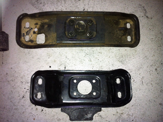

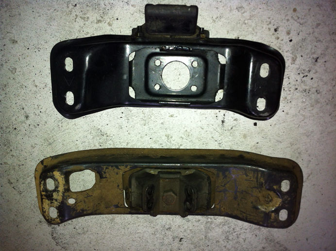

The Celica crossmember came in today. I test fitted the MKIII R154 mount and it bolted up perfectly.
Here you can see a comparison with the MKIII R154 crossmember and the 82-85 Celica W58 crossmember.
This should be the very same part 2JLEX used in his swap.
The unfortunate thing is that Toyota discontinued or sold out of these some years ago, so used is your only option if you want to do it this way. The plus side is that this should allow the use of a factory Toyota transmission mount with an MKIII R154 transmission.
