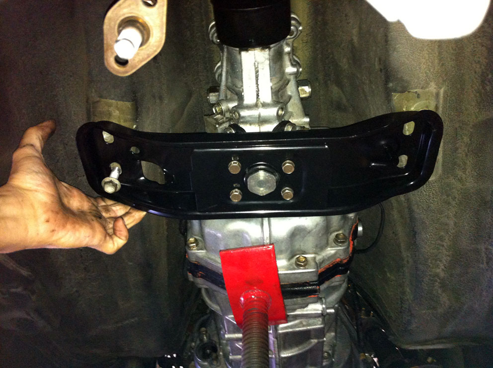

Okay, I was only partly correct about this. You DO want this crossmember for your converted MKIII R154 box because it ALMOST fits the SC.
Everything lines up perfectly but the passenger side bolt holes on the SC chassis are still an inch or so farther away so the 82-85 Celica W58 crossmember has to be cut, extended about 2 inches (if I remember correctly) and welded. THEN it will fit the SC perfectly when using a stock MKIII Supra R154 trans mount.

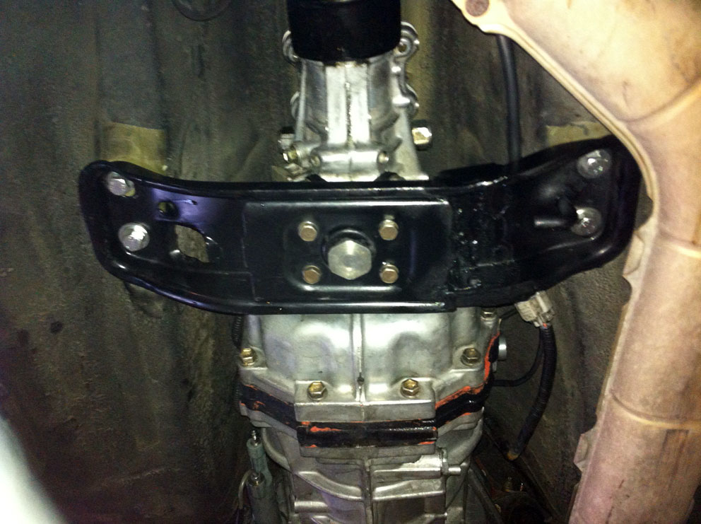

Thanks but I already used the Celica crossmember with some extension and welding. All the bolts line up and the extension was the worst of it. I've seen what you're describing in pictures from other installs (notably Shern's) but I wasn't comfortable with it personally.
I have before and after comparison pictures I will post up. Obviously welding a small extension isn't "bolt-in" but it may benefit someone in the future.
Interesting modification, would have been really nice if the celica one fit without being extended.
Not trying to sound repetitive but since it requires cutting and rewelding I would re-consider using the stock crossmember or making a one piece solution. the celica mount is probably a hard steel you can weld good enough to, but something about having a extension performed on a very old factory cross member just doesn't seem like a structurally sound idea since those metals can fatigue over time and it looks well aged already. Not saying it won't hold but it seems risky.
If you modify the mount and it breaks, the crossmember will catch your trans and motor.
If you modify the crossmember and it breaks, that would be way worse and possibly devistating to the vehile and whoever is inside it, and it wont matter whether you re-drilled a hole or 2 on the mount or not.
the crossmember encounters lots of forces including vibrations, up and down, and side to side from turning and uneven roads, and I am sure the SC generates much more forces than the celica did.
Something to consider, a 1 piece solution is the right way to do it, or even a custom mount for the existing cross member. maybe you could reinforce the modified cross member with a solid piece welded underneath it. maybe I am just being paranoid on this one but the mount is much less important than the crossmember to the car as a whole.

You make a very sound argument. I can only offer pictures of what I have done. Here is a before and after. These guys at SpeedForSale who did this welding job for me (just quick, dirty and strong I might add, so not up to their usual standard of pretty looking welds) work on MKIV's, R34 and R35 GT-R's, FD RX-7's primarily so while I wasn't expecting perfection given the tight timeframe I gave them I do trust they wouldn't let me go with a bad set of welds that wouldn't hold up.
The reason I felt comfortable with them going ahead with it is that everything else including the angle the transmission was at if only one side of the mount was bolted in was exactly where it should have been. Were that not the case I'd have gone to Plan B: using the SC crossmember with the W58 mount.

The solution (Post #22) is to cut and weld in new plate steel (I can't remember the specific length, sorry) and reinforce the hell out of those welds. I didn't do it myself. I had a Supra specialist shop do it for me.
