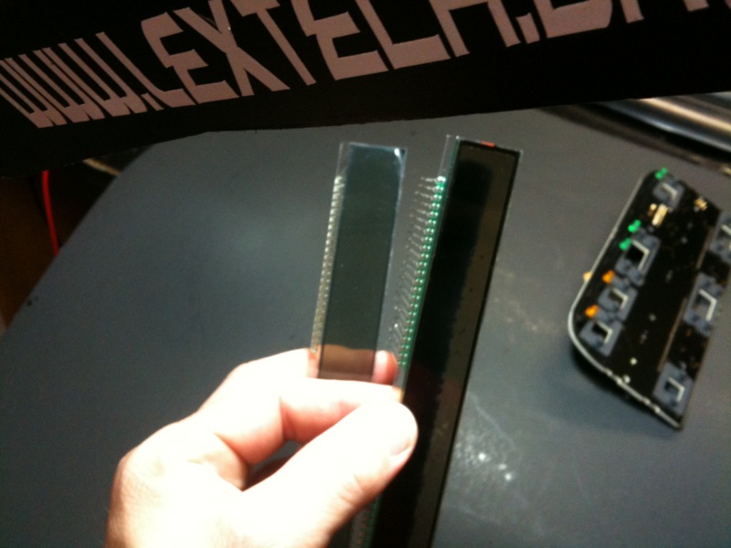

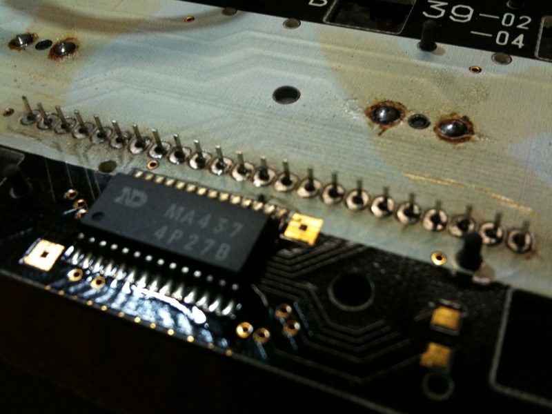

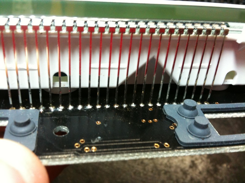

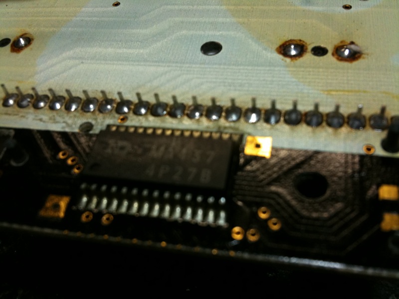

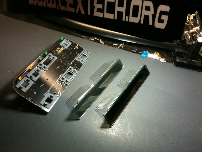

I'm not gonna say the user id for obvious reasons, but a guy sent me this and he had replaced the lcd on it. Top things to note are (a) the cold solder joints (b) the lack of solder joints on some of the pins (c) the plastic still on the LCD, (d) the bent pins (NEVER bend the pins, it cracks the seal on the LCD and dries it out much faster decreasing the lifespan). I practically do this for nothing to help people out and there is just no reason to let your nice brand new LCD end up like this and with all the problems this can cause.

This is the proper way to do it:

I do have to say those were horrible solder jobs as you said, and i will be calling on lextech fairly soon, my needles are dead...

more practice more heat. that flux will clean right up

Sorry I can't help. As you know we do not do biz in the model forums on CL. Just showing off an example of what not to do with the climate unit LCD if you DIY.
This is the only thing I have against DIY. There's a lot of people that say "hey you can do it just look at this" and they do and this is usually the end result. Sure anyone can do it, but results may vary. Just try not to make it look like this one

The LCD's have a tendency to misfire and have blank spots like a half formed number or something if they connections have any resistance in them because they are very low voltage. You have to get a nearly perfect solder joint on them to ensure low resistance. I've seen them LOOK good and still be cold joints...... much less these seen in the OP.

There are two different versions of the lcd I have posted on here in another thread. The heavier duty one of the two you have a better chance of getting away with some bending of the pins, but it is all luck of the draw like a car wreck. Sometimes everything goes ok if you just move an inch to the left on impact. With the LCD it's a matter of bending the pins without breaking the seal at the glass. The heavier duty ones has a less chance of cracking the seal. I won't bend ANY because it won't show up immediately so I won't know if I did any harm or not.
