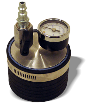

It probably isn't due to the fact you're getting RPM fluctuations. Make a leak detection end cap and find your leak.
