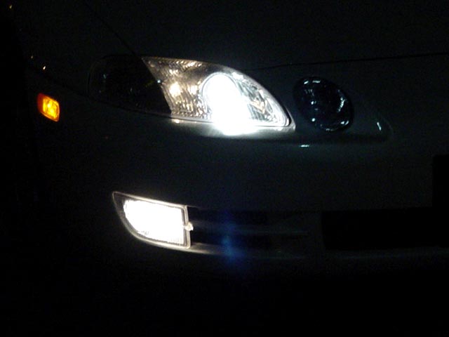

Old Mar 30, 2003 | 03:24 AM
RaynArt's Avatar
RaynArt
Joined: Sep 2002
Posts: 1,298
this is a bit old but i forgot to post pics, and didnt want to make a knew thread about an overdone topic
low beams: 9006 sylvania silverstars [$50/pair]
fog lights: H3 pilot hyper whites (temporary till i find decent yellows that wont burn out) [$18/pair]
city/parking lights: polarg 914 [$7/pair]

Old Mar 30, 2003 | 03:26 AM
RaynArt's Avatar
RaynArt
Joined: Sep 2002
Posts: 1,298
parking light, low beam off
Old Mar 30, 2003 | 03:28 AM
RaynArt's Avatar
RaynArt
Joined: Sep 2002
Posts: 1,298
same, with low beams on
