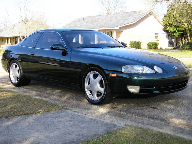

So i bought a set of TT polished Wheels and had them refinished to perfection and bought new tires.
315-35-17 for rear 17x 9 1/2 and 225-35-17 for the front 17 x 8
I bolted the wheels on and they look like ****! The front look like spare tires and rears are fine, but fronts look horrible. Im sooooo pissed i spend sooo much money on these wheels and they let me down!
What do i do to make these look good or should i just sell them?
Anyone else running TT wheels on their SC and if so what tire size you using and any spacers?
plz help .. and pics would be awesome

Why would you so grossly oversize the rear tires and then grossly undersize the fronts. You need to be running 275 or 285s out back max, and a minimum of 245 up front. I am running 245/285 and they are perfect and look great.

lmao!!!!!!! are you kidding me man? you could put those tires on the front of a civic matter a fact a dune buggy. you need 235 or 245/45!!!!/17...cocaines a hell of a drug!
buy the right size front tires then sell the baby tires they will sell very fast

I had some a few years ago, on my 94. I thought they looked sharp! Rears were 275's, ..I think the fronts were 245, or 255's.

225's up front are undersized. You need at least the factory Supra 235/45-17's up there. Or 245/45-17's. Rear should be 255-275. 285 is the highest you should run in the rear I think.
TT's look and handle far better than the stockers and cost far less than expensive and showy rims.

Ok well i got 315-35-17 in the Mickey Thompson ET Street tire so i can hook on street
the fronts i fudged up on and got the 225 =( ... I will have to fork over more money now for a set of 245's .. sigh!

tt wheels do not look horrible on the SC they are actually the best looking stock wheels you can put on SC, GS, IS.
I got a set on my car 245 frt and 275 rear Nitto NT555r , they clear BBk, they are staggered, they are 17s look ok even with stock suspension and they hook with the right tires and right size on HH cars.

Give it a shot with a better tire set up
I have 255/40 and 275/40 and its looks awesome to me
