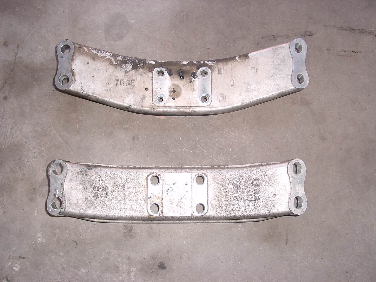

To bolt up a v160 you need the Supra TT crossmember. Some engines don't come with them.
Top of TT. Bottom is NA and what you currently have.

[/QUOTE]To bolt up a v160 you need the Supra TT crossmember. Some engines don't come with them.
Top of TT. Bottom is NA and what you currently have.[/QUOTE]
See, that's something I didn't know.....
