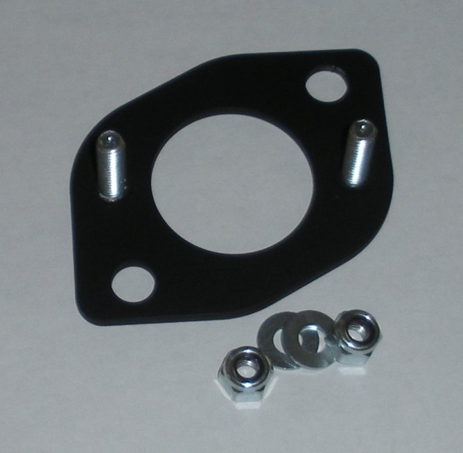

how was the install of the wilwood mastercylinder and did you use the stock clutch pedle or a aftermaket one?

My car is an auto so I had to buy the clutch/ brake pedal assembly. On the inside of the firewall you can see a "template" where you can cut out to fit the clutch pedal box. I cut the oem holes and enlarged the master hole to fit the larger wilwood master. The factory holes are diagonal and the wilwoods are straight up and down, so drilled the two additional holes in the firewall. So now I have a total of five holes. Two for the pedal box, two for the wilwood and one for the master. I noticed that the firewall seemed flimsy so I made a cardboard Template of the five holes, traced that to a 3/8 piece of aluminum and made a "firewall clutch support/reinforcement". The threads on the wilwood pushrod are 5/16 24 so I just tapped the factory pivot pin to that size.

So for anyone that is considering an auto to manual swap as well as using the wilwood master... you should do something like this:
http://www.silviav8forums.com/forum/...pic.php?t=1259
little bit easier

So nissan and Toyota use the same clutch master pattern? Interesting
