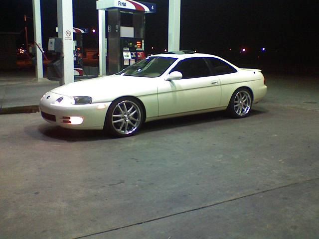

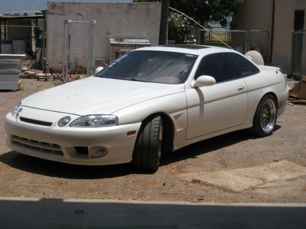

Virgin picture with my cell phone on my way home from CA.

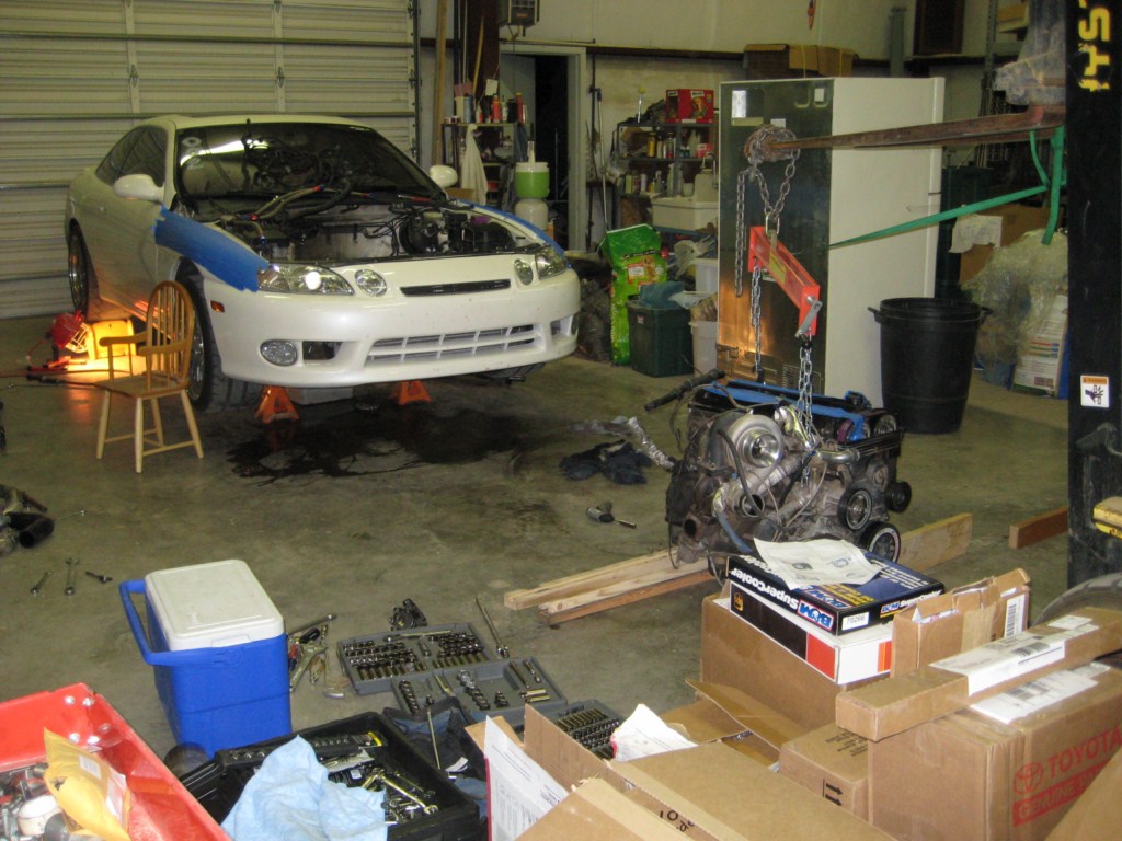

I already had the new engine just about ready and had done all the leg work so I was able to actually do the swap in just a couple days

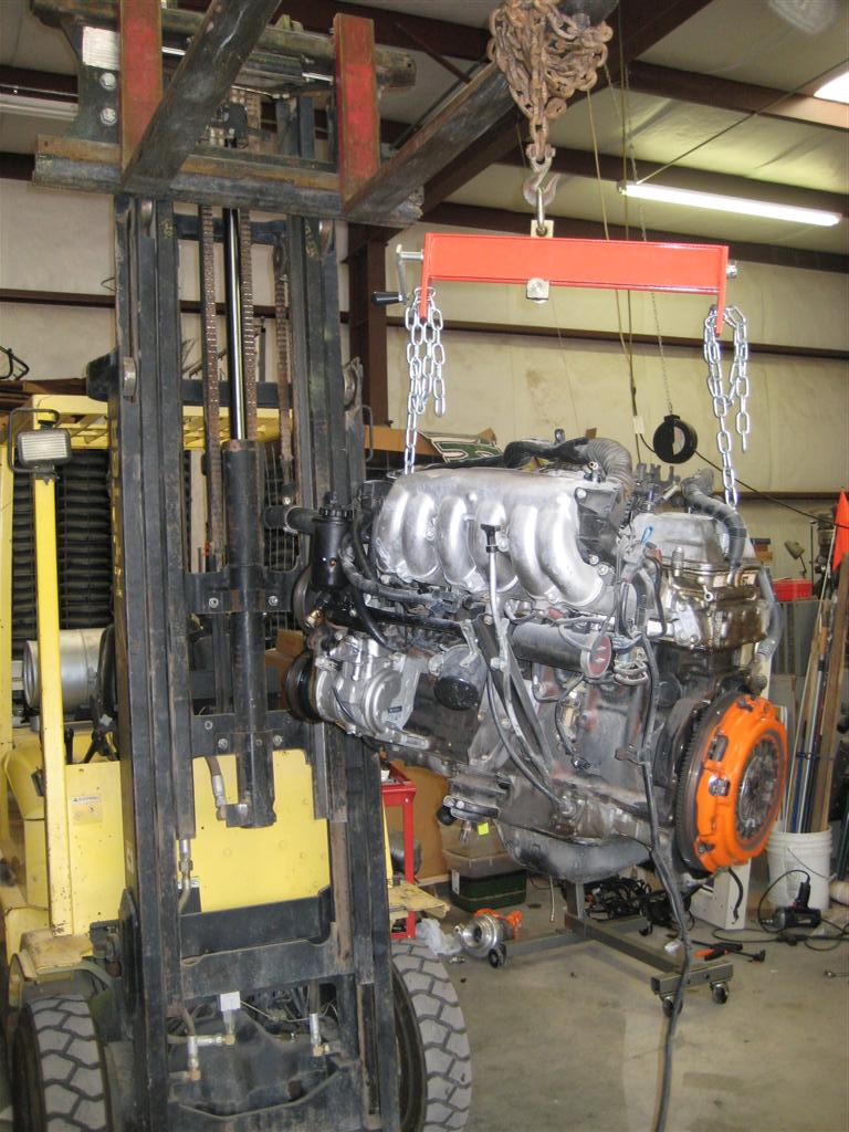

I spun my bearing at the AZRides track day back in January 2008.This is with the engine and tranny out of the car and the engine on the stand is almost ready to rebuilt.

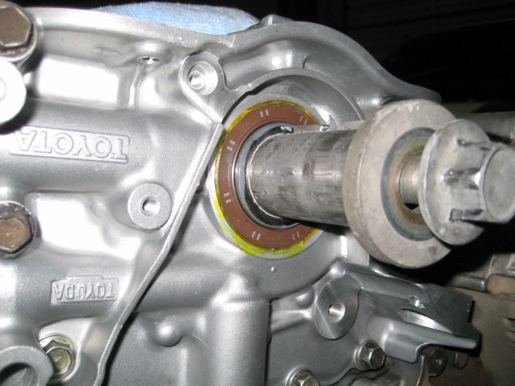

At this time because of me having blown my front main seal several times I put set screws around it and used JB weld (pretty much last resort before I would have to pull the engine to change the oil pump) and I also installed a -10 catch can. It held up good but I was never confident it would keep lasting. I also ran 100% of my wastegate/boost controller lines in -3 AN lines and fittings so there is no way one will blow off and blow my engine.

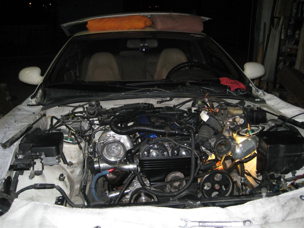

Started on my latest build May 29th. I was planing on doing all the changes real quickly but it ended up taking about two weeks working nights and weekends with very little family time.
Mods would include:
-duel valve springs (when I can I'll raise my rev to 8k)
-L19 head studs w/new stock headgasket
-GSC s1 cams
-650cc injectors
-top feed fuel rail
-Sound Performance modified intake manifold
-FPR
-Oil cooler
-PS oil cooler
-GE water pipe to keep my heater line away from my downpipe.
-stock IS300 fans
-RPS twin carbon/carbon clutch (the big dog)
-Getrag 6spd tranny (will put my SC in the company of very few others)
-One peace custom driveshaft made by snap performance in Dallas
-hood pins
-clean up some wiring issues that had been bugging me for awhile
-redo some of my IC pipes.
Now it is dark out side
Checking valve clearance for the new cams. I set the intake to .01 and the exhaust to .012.
Checking the bearings, they looked pretty good after a hard year
My new PHR modified oil pump. Changing this out was the driving force behind even pulling my engine. I think my new OEM pump was defective causing me to blow my front main seal (common problem on 2jz's) PHR's pump is an OEM one that's been blueprinted and the drain is bigger so oil pressure can't as easily build up behind the seal.
Here I'm finally putting my adjustable cam gears to work

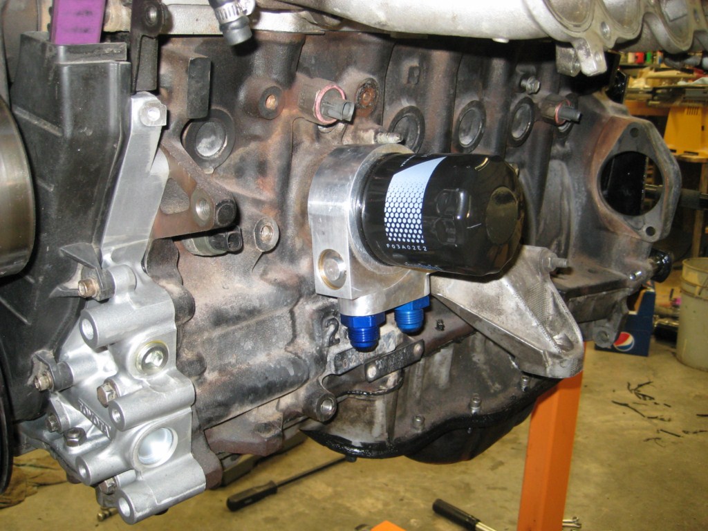

I was able to remove all of the factory oil filter housing, restrictive factory cooler, and mount the sandwich plate for my cooler directly to the block.
Here's this bad boy. I should never have to upgrade this.
Here's the mighty GETRAG. Fresh out of "The Transmission Shop"

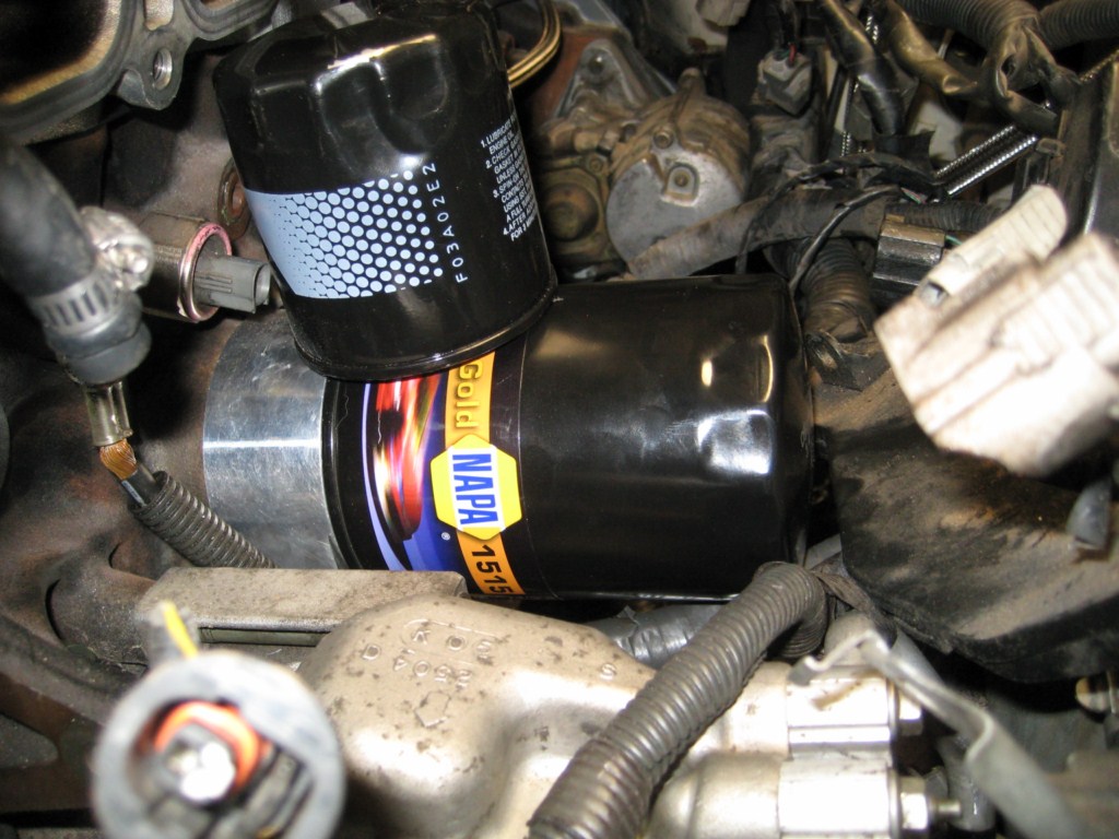

The old filter is on top. the new filter is much bigger. The new filter and the oil cooler has added about 2 quarts to my oil capacity.
new fuel rail and 650cc high imp. injectors
SP modified intake, its the same size on the outside but has 40% more volume on the inside. Some people say it doesn't give any top end horsepower but helps a little at lower RPM's it was fairly cheap. Also my FPR and I hooked up a 50 shot.
Final engine bay picture over all it looks about the same
My take on the car so far. It feels about 50WHP stronger at 17.5-18 psi boost. I built the setup for 25psi but with my 9lbs spring all I could get was 18. So I have ordered a 14lbs spring. The tranny and clutch feel great but with my final drive it is geared too low and the gears themselves are too short. A stock Supra has 3.13 gears, I have 3.76, so I ordered a GS400 rear with a 3.26 (very close) and I'll put the LSD from my 3.76 diff into the GS diff so far all problems solved. Now the bigger problem. I have the car tunned pretty good at wide open throttle. Just driving around town the tune leaves a lot to be desired and the car is no longer the gentile beast is was only a few weeks ago. Eventually I will have to go with a standalone ECU but that won't be for awhile. When I have the funds I'm going to take it up to the Supra Gods in Santa Fe (pre-racing.com) and have Ben install and tune a V-Pro ECU.
