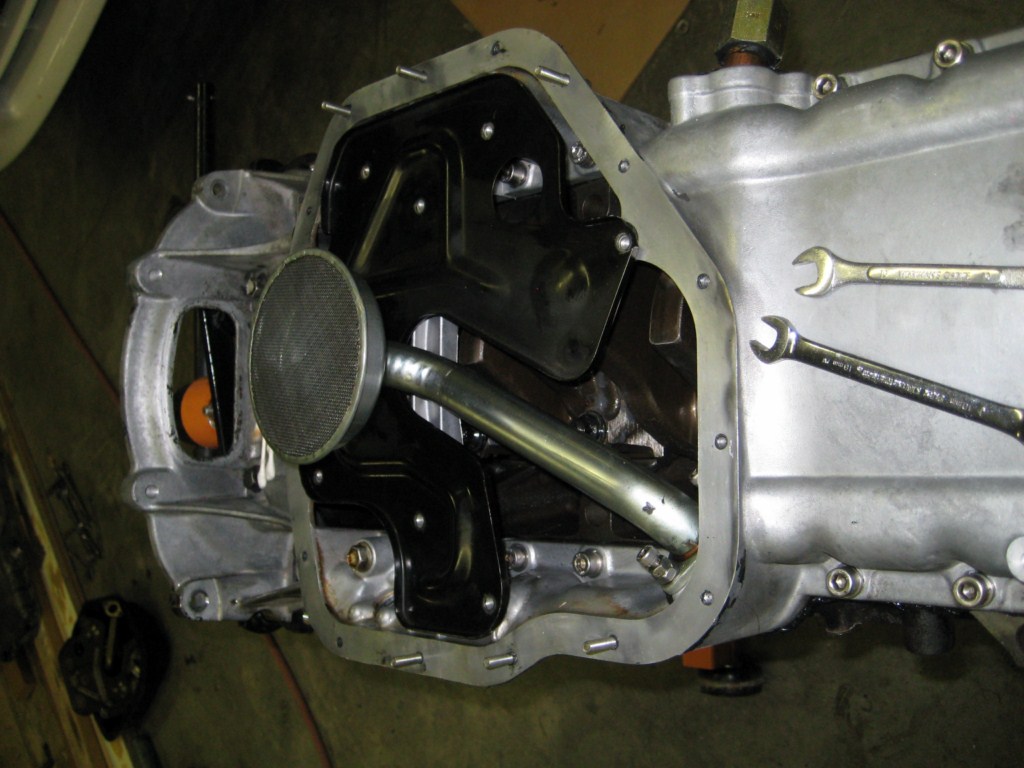

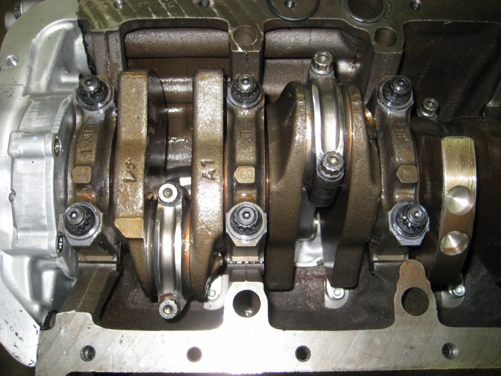

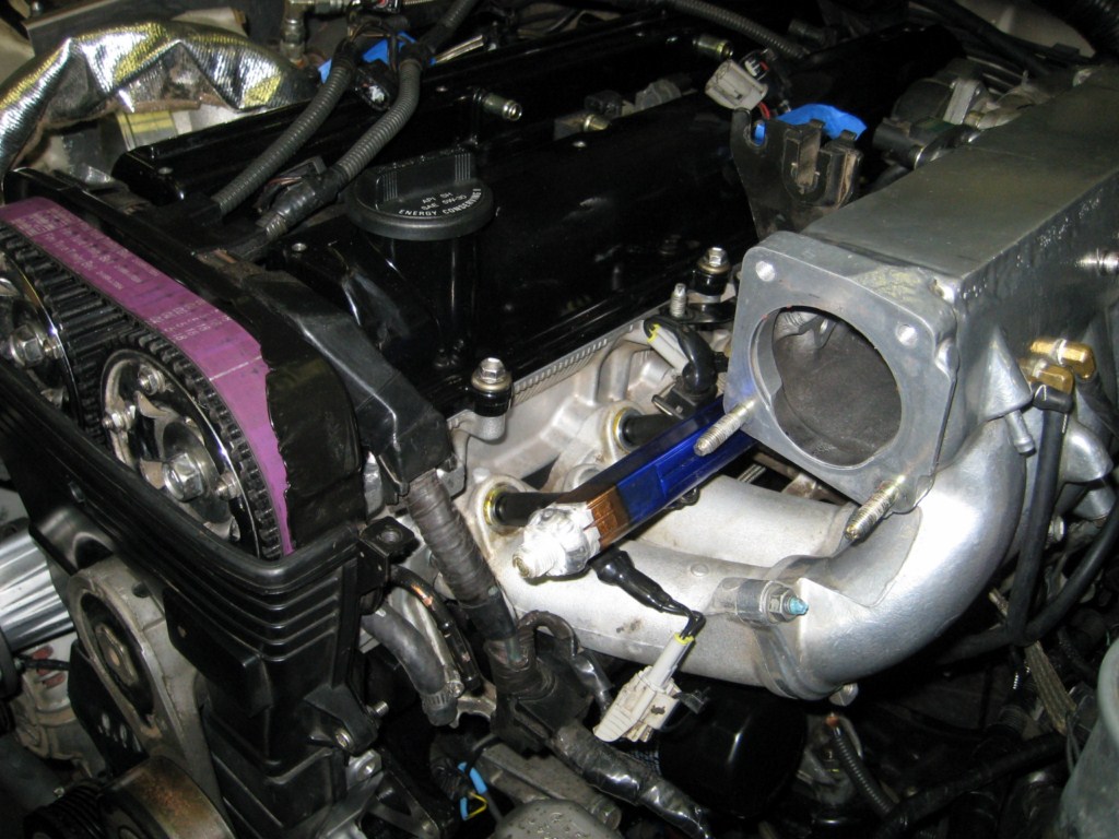

This last two week I put a built shortblock in my car. The engine was built buy CGM Motorsports. It has JE pistons that were coated and also custom CGM rods (they're suppose to be stronger than the stock ones and a lot lighter). They also did all the machine work. The pictures don't show how pretty the engine was. Also I was able to sell my differential for a good price so I was able to get a new TRD LSD and put it in a GS400 diff all and all for a really good price. I also got my fuelrail welded so I never have to worry about the fittings leaking. I also welded a fitting onto my fuel line so no more hose clamps. I also installed a B & M short shifter. I pretty much cleaned every hole with a tap and every nut and bolt with the same, or I put new bolts, It kind of drug on and on but this is the last time I hope to do this (on my car) for a long time and just didn't want to worry about the little things. I mostly did the work at night after the kids went to bed. I've put about 500 easy miles on the car so far and everything seems good. Ever since I put the 6spd in the car with the twin carbon clutch it's official the car is a beast and no longer a luxury sports car that is pretty fast. It's pretty hard to drive smooth and the sound of the clutch is hard to ignore. 90% of the time it would be better with the setup it had on the dyno day and the May super lap, but for that 10% I would say it is all worth it.
