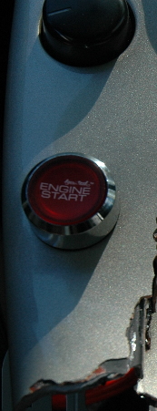

I did this about four years ago, before some $&%* broke into my car. I enjoyed the look, because it seemed more racy (not to be confused with ricey)....
