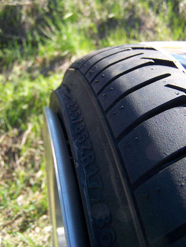

Stretching tires has many pros and cons. Yes, the look is appealing, and it will help you clear your new wheels, but you are fitting tires on a rim that it wasn’t made for. It is easier to damage the rim or pop the tire. Also, the sidewall of the tire will flex less since it is being stretched, so many drifters run stretched tires. Other than that, there is really no advantage or disadvantage performance wise, just make sure you maintain correct pressures.
Various tire stretches:
225/35/17 on 17x10
245/35/19 on 19x10.5 Falken 451
For a great thread on tire stretches you might want to check out this thread on vsc by CL member hoebag:
Consolidated Tire Stretch Thread!
Note: Not all tires will stretch the same. Some tires have more rigid sidewalls than others, that will not stretch as much.

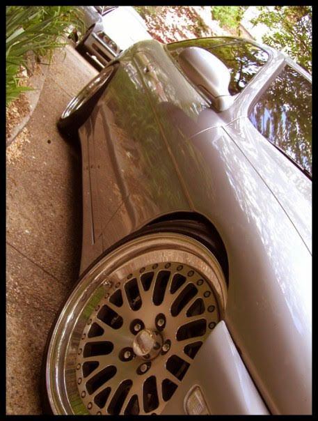

CL Member Name: newyorksc/workaholic
Rim Brand and Type: CCW Classics
Rim Size f/r: F: 18x10 R: 18x11
Rim Offset f/r: F:+24 R:+32
Tire Size f/r: F: 245/35 R: 275/35
Suspension Setup: Tein Flex
Comment On Ride: Very Tight, But Too Bouncy
Fender Modifications: Rolled
Any other comments: No rubbing when camber was not "fixed".
Pictures:
This was the rear tire after a few months (275/35 Toyo TR1 on 11" Barrell):
The overall stance of the car with the setup:

CL Member Name: TopSCecreT
Rim Brand and Type: Racing Hart CX multi-piece
Rim Size f/r: 19x8.5 Front 19.10 Rear
Rim Offset f/r: +37 Front (high disk) +42 Rear (low disk)
Tire Size f/r: 245/35 Front 275/30 Rear
Suspension Setup: Tein CS coilovers
Comment On Ride: No complaints on the ride, the SO-3 are quiet.....but overall good ride
Fender Modifications: Shaved rear fenders
Any other comments: My coilovers are set at the lowest drop, so when i turn the wheel all the way or corner pretty roughly, i rub
Picture:
Picture:
Picture:
