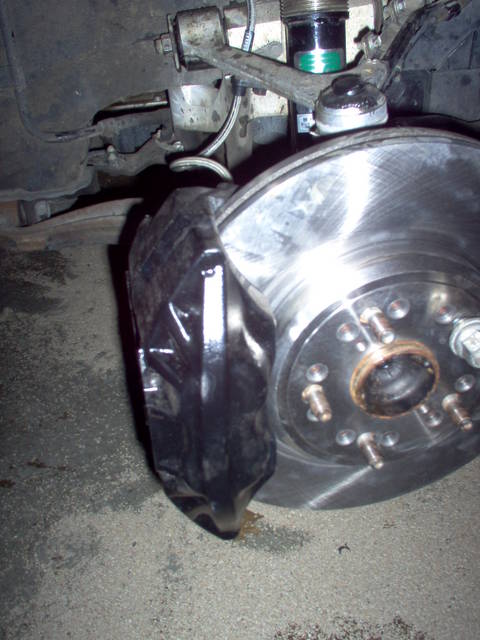

Originally Posted by Blizzy
How was the install? Did you do it yourself?
Install was crazy easy, just needed washer for the upper sc caliper bolt. Took about 55 mins, including driving to the parts store to pick up pad lube and washers.

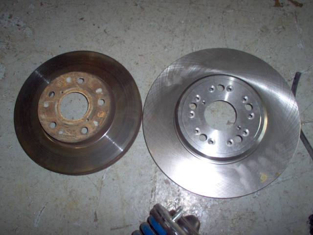

will the LS400 rotors also bolt up with no modifications??? anyone have any comparison pics of ls400 rotors to sc300 rotors? need to swap out calipers and rotors on my SC asap.

any pics? how much bigger are they?
they're over 12" in diameter, and it uses a MUCH larger, 4 piston caliper.
In order to install these, you need to trim (or do what I did- completely remove that annoying metal dust shield). I used OEM LS400 bolts, so I didn't need to use washers or spacers or anything. Also, I'd reccomend OEM sumitomo brake pads. Anything from a 1996-2000 LS400 will work.
Bleed the brakes, and you're all set I'll take pics sometime this weekend and make a thread. VERY good upgrade, it looks great, and the performance increase in stopping is tremendous.

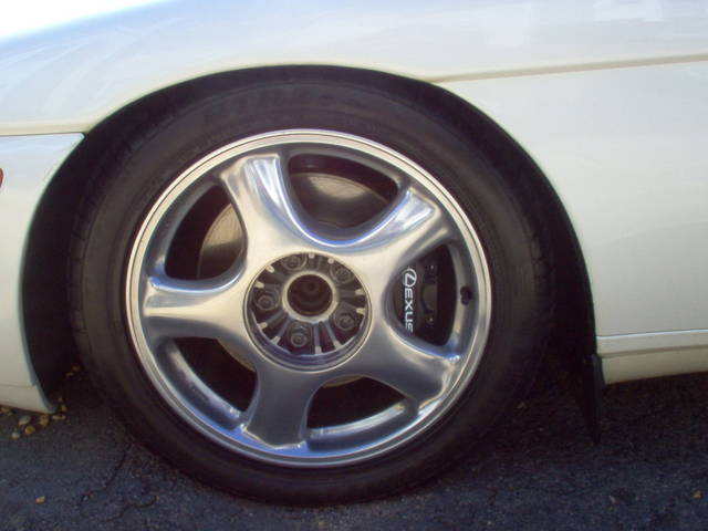

I forgot to mention the following: Due to the large size of the caliper, most stock Lexus wheels won't work. I'm pretty sure they're nearly as big as Supra TT front calipers/rotors...
so you need to make sure the wheels will clear the brakes.
Guys here are my pics from my install

i have silver supra na wheels, will the LS400 brakes clear them?
They won't clear NA wheels.

I bent the dust shield back enough where it was not touching the rotors or anything else.
Bleeding the brakes was the hardest part because you need an extra hand.
here are my pics
-hass
