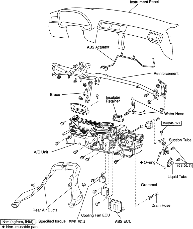

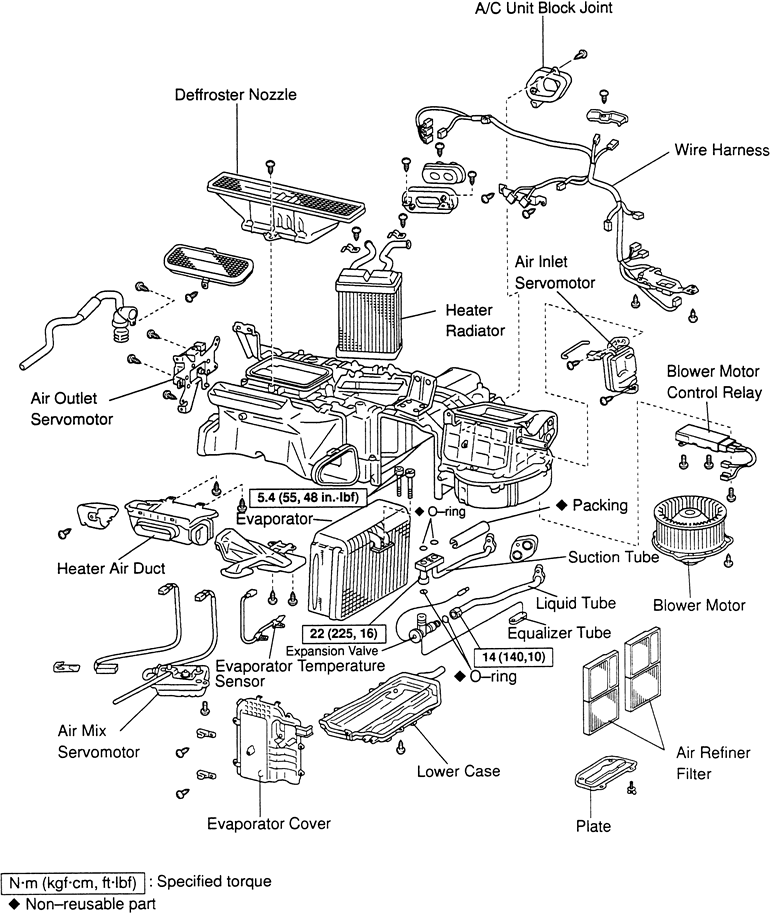

This is all I could find on Heater/Cores dont know if it will help you.

no, but thanks anyway....that is a nice diagram to have though. I guess I will attempt to take pictures so that people may understand that I'm asking for the origin of a vacuum line and they might be more inclined to walk 10ft to their car, take a look and type. Doubt it but its worth a try.

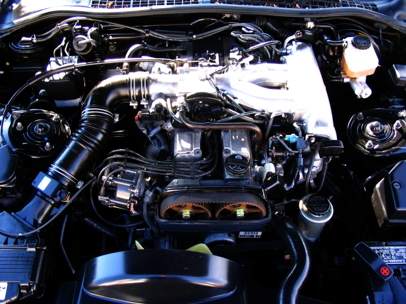

I would take pictures and circle what your talking about, or look at my motor and circle it.
I will have to try from work tomorrow, I dont have any picture editing options on my computer. Thanks for the pic though....its perfect.....if you look in the top left corner at your engine you can see the resivior tank...now go about an inch to the right and you have the hcv, on the back right side there is a vacuum line coming off of it, I can kind of see it in your pick, it comes off and looks like it runs to the right. That is the line I'm missing, there is only one on the back side.
