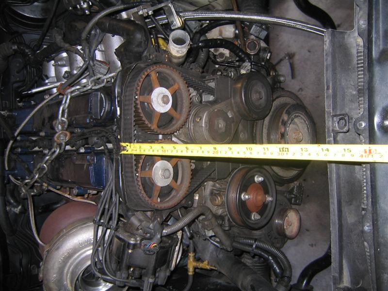

STEP 1:
With the stock transmission still installed, measure off a reference point on the 2jz motor. This makes sure when you go to mount the th400 the motor is still level.
For example, i measured from the back of the timing covers to the hood latch assembly.

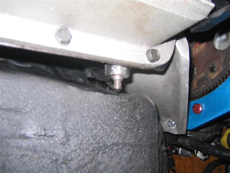

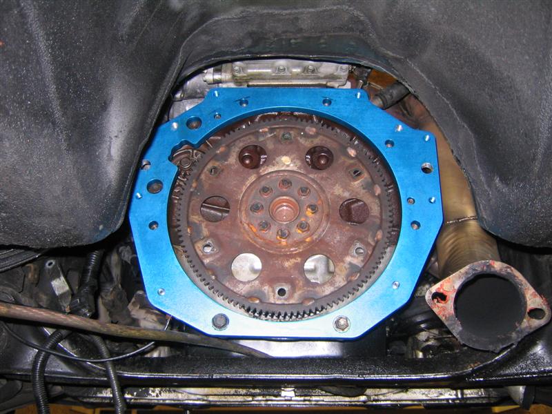

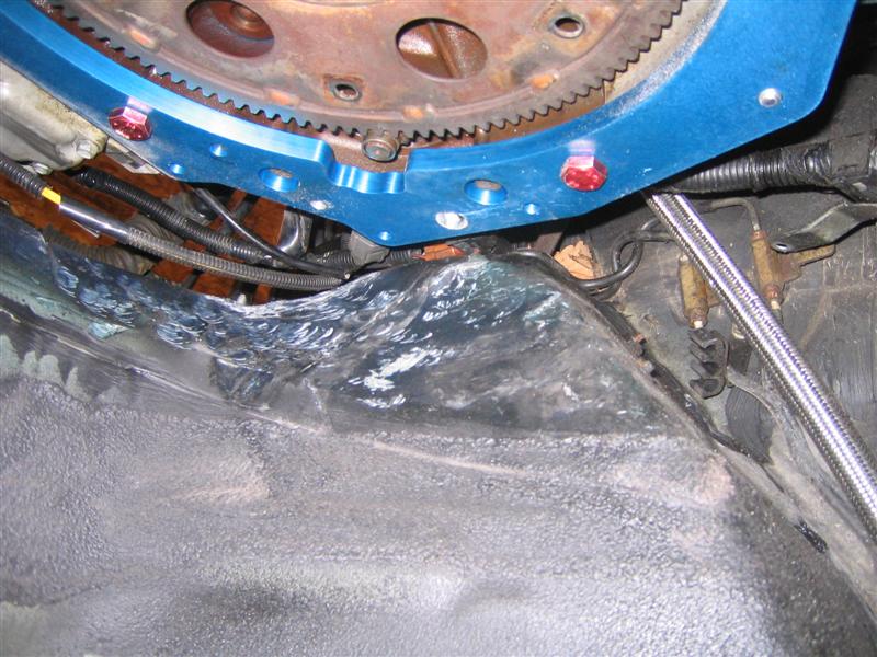

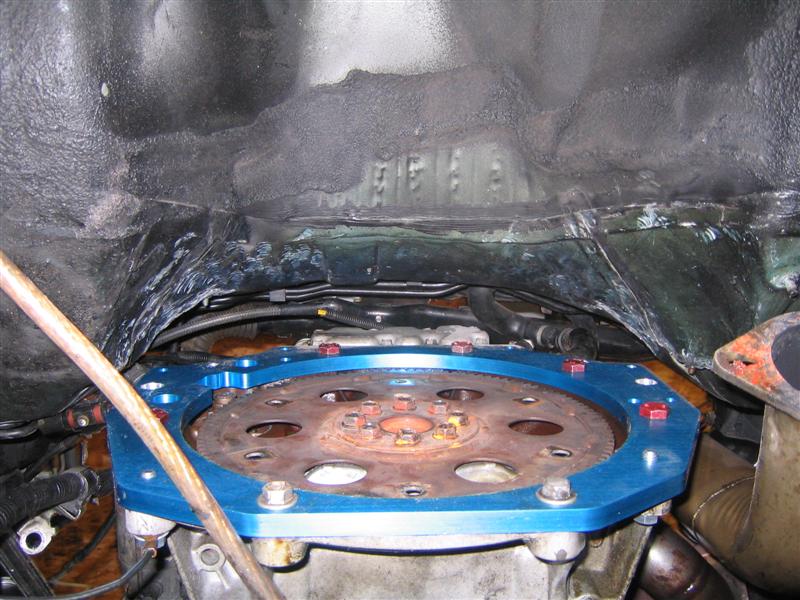

STEP 3:
Attach adapter plate and note areas where clearances are a problem.
This picture was taken after I already had pounded out the tunnel. the biggest problem areas are in the 10 oclock and 2 oclock positions.

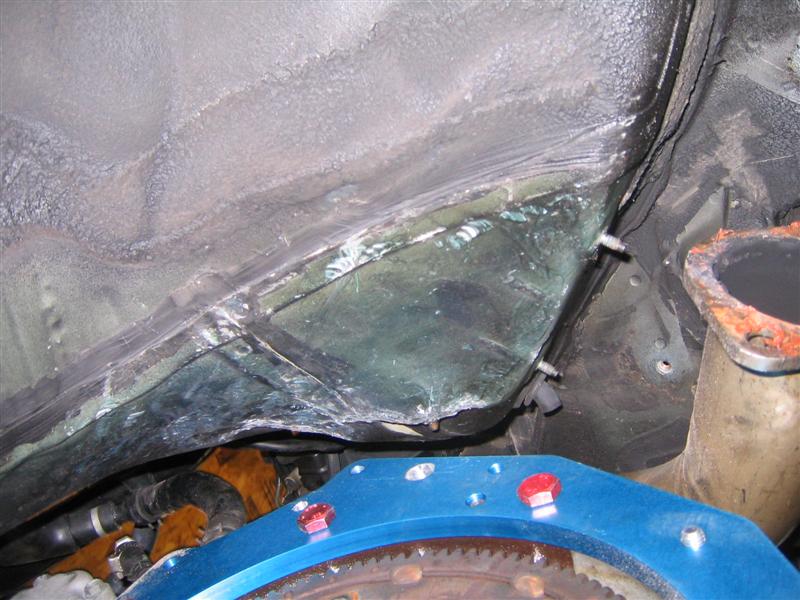

STEP 5:
Using sledgehammer, pound out the transmission tunnel to accomidate the larger bellhousing. I used a combination of 2lb and 10lb sledges to get the desired dimensions. This is basically a eyeball it and hope for the best type of situation, where it might take 2-3 tries to get the tunnel beat out enough.
From underneath
.jpg)
Drivers side
.jpg)
Passenger side
.jpg)
you will also need to pound out around the shift lever, but that can wait until we go to test fit the entire transmission.
From underneath
.jpg)
Drivers side
.jpg)
Passenger side
.jpg)

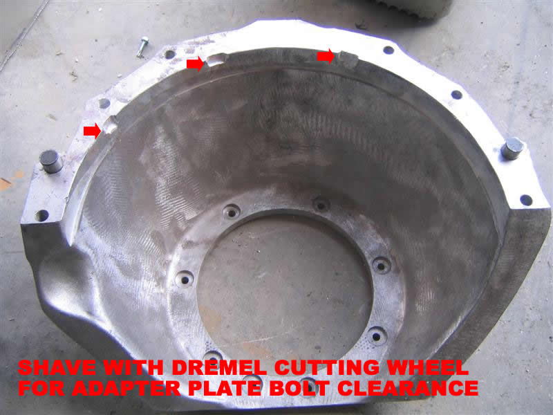

STEP 6:

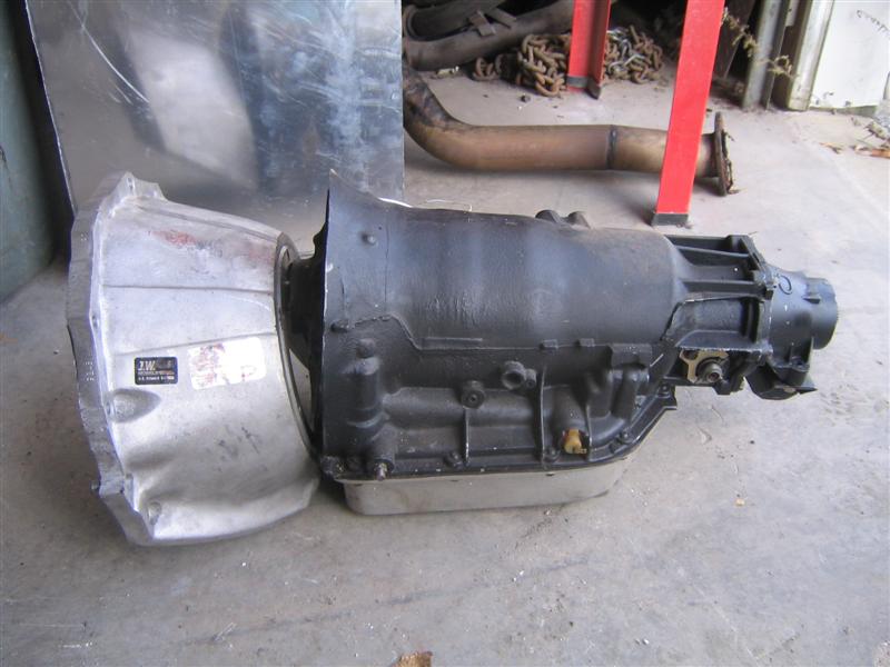

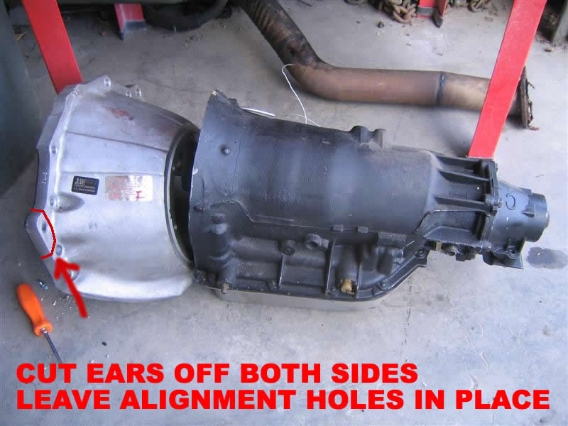

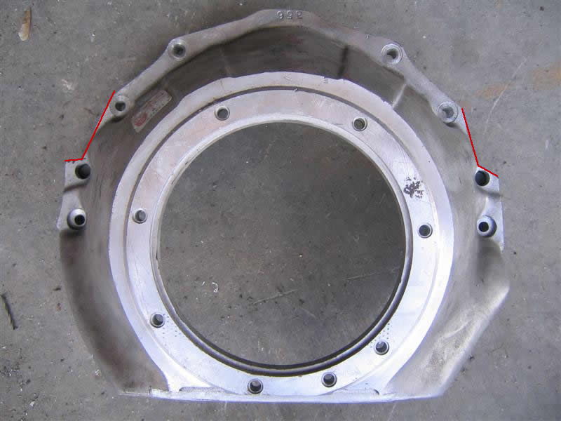

Modify the ultrabell using a sawzaw (reciprocating saw) and a dremel with heavy duty cutting wheel. this saves A LOT of hammering in the trans tunnel.
.jpg)
.jpg)
Now, the RED bolts that hold the adapter plate to the motor get in the way slightly with the ultrabell, so it needs trimmed out approx 1/4" for the bell to fit over the bolts.
notice the red bolts
.jpg)
trimmed out to fit around the red bolts
.jpg)
.jpg)
.jpg)

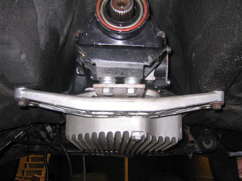

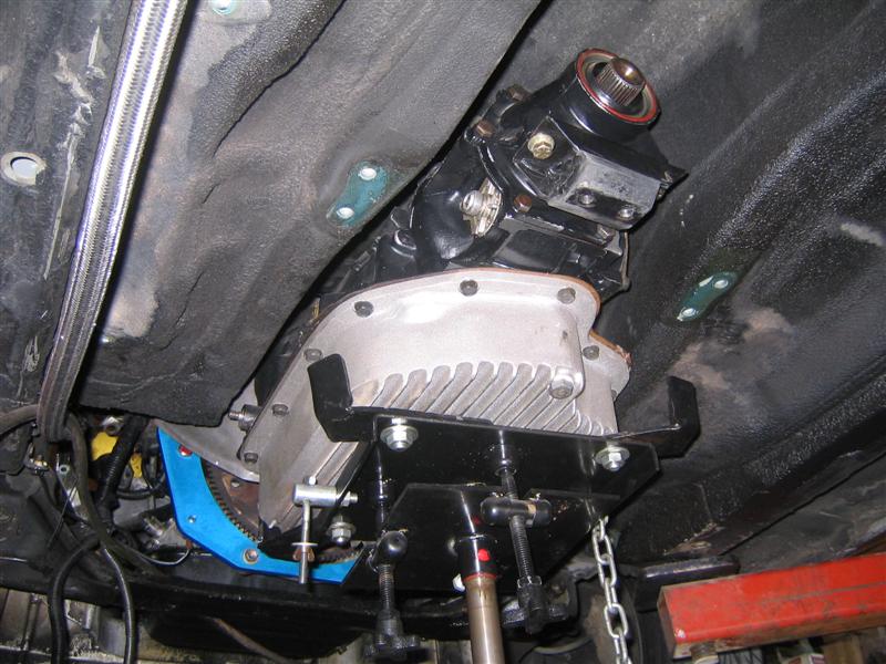

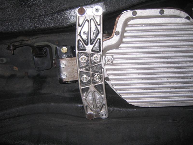

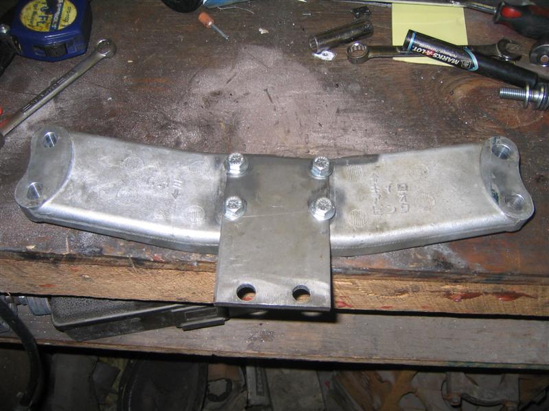

STEP 12:

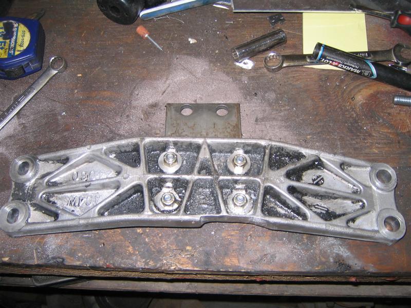

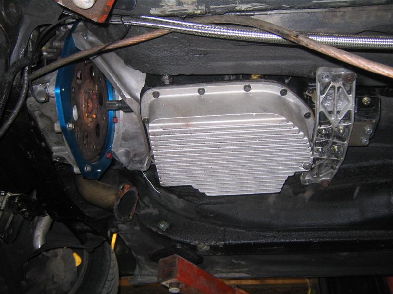

Using the stock auto crossmember / trans mount, create an adapter for the TH400 transmission.
I used a piece of 1/4" thick steel (3.5" wide by around 5" long)
.jpg)
Notice, I had to cut/grind out some of the stock lexus mount to clear my huge transmission pan.
.jpg)
.jpg)
.jpg)
To get the right height I used 4 washers to raise the transmission to match the measurement I took earlier from the timing cover to hood latch.

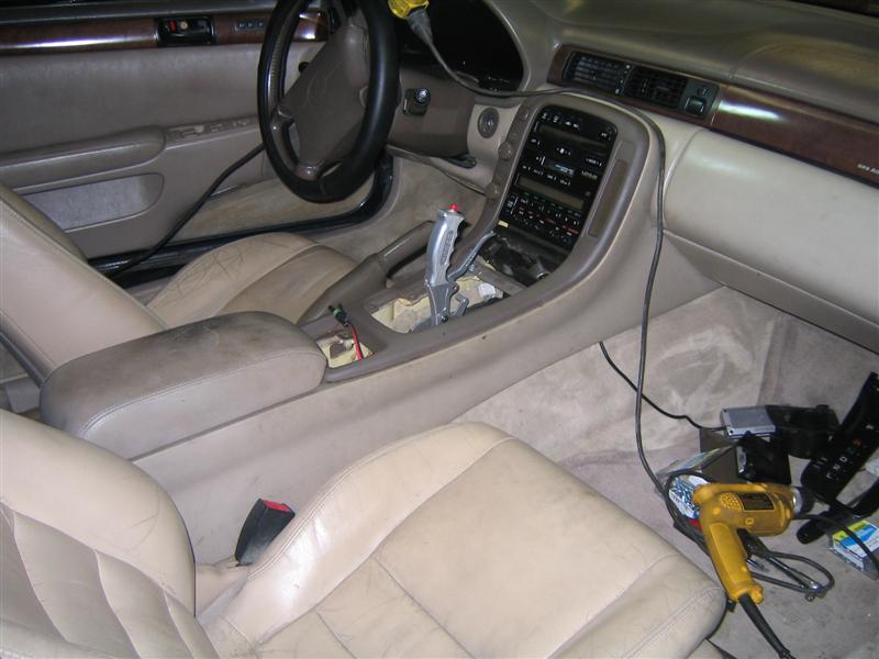

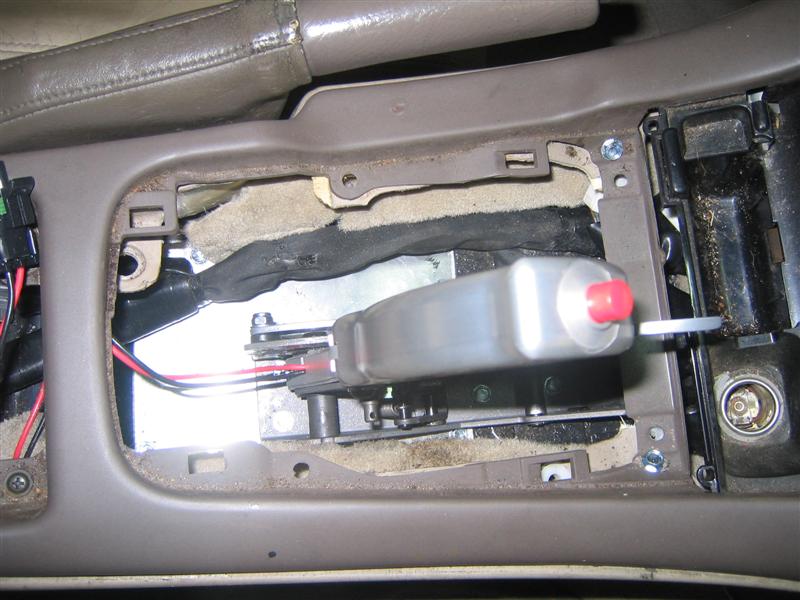

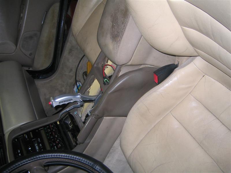

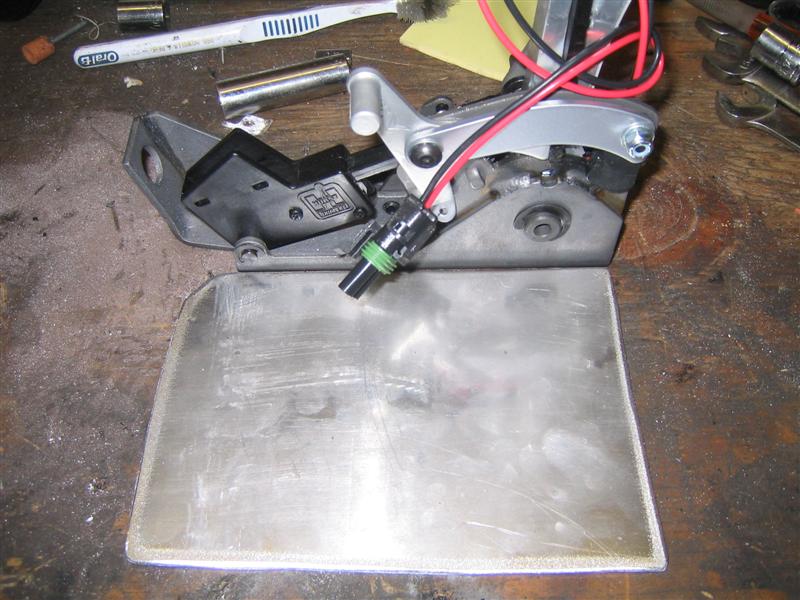

STEP 13:

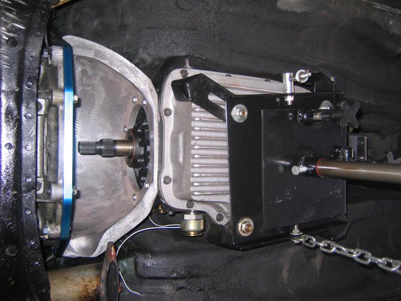

Install your TH400 shifter. I am using a Hurst pistol grip I picked up from www.summitracing.com
First, make a 7x5" aluminum or thin steel plate to cover up the stock hole. Then attach the new plate over the hole securely. I used self-tapping screws.
.jpg)
I then used self tapping screws to attach the shifter to the transmission tunnel. Here are some prelimary shots of the shifter setup.
.jpg)
.jpg)
.jpg)
.jpg)
.jpg)
