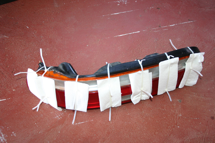

Step 5.
Reassemble the whole taillight and place it in the oven for 5-6 mins at 300 degrees, when glue is heated, ziptie the whole taillight together.
Let taillight set for 24 hours. Then remove zipties.

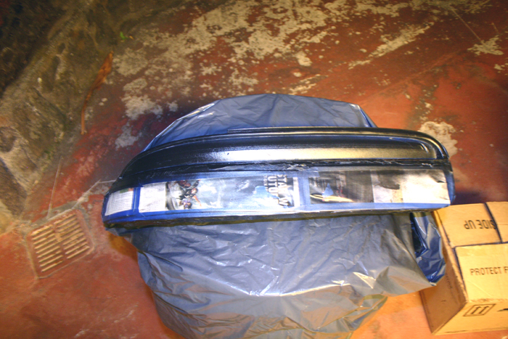

Step 9.
Place the plexiglass over the taillight and heat the plexiglass with a heating gun to mold it into the shape.
Step 10.
Place the plexiglass over taillight, Mask the plexiglass and use a dremel to cut out the shape that is needed.

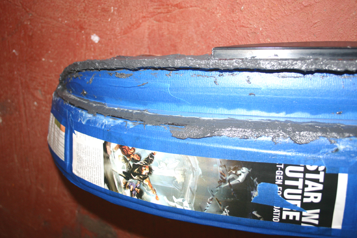

Step 11.
Mask area with painters tape to protect the area of the lens that you don’t want to epoxy.
Mix Devcon Plastic Welder and spread as needed (working time is only 4 min)
Mix PC-7 and spread as needed (I use this to cover the most) don’t be afraid to use a lot because we’ll be sanding it down in the next step.
(Let Plastic Weld and PC-7 Set for 24 hours.)

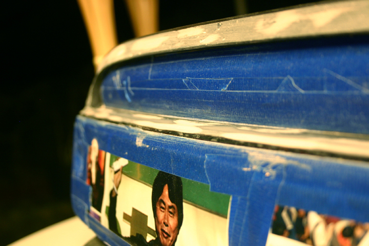

Step 12.
Sand and shape with 80 grit paper, I used a palm sander, dremel (for corners and details), then hand sand with 200 grit paper.
Step 13.
Mix Bondo Filler and spread to fill in cracks (working time is only 3 mins)
Sand with 200 grit until smooth.

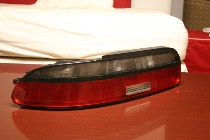

FINISHED RESULTS.
This was my first shot at it, so I’ll be cleaning it up alittle, still not where I want it but you get the idea. I think that the black border around the clear is to thick and it needs to be smoothed out more.

Great job dude. I did this last year, but I did not like the fact it still ended up looking like a DIY job so I never posted pics. I think you did it cleaner than I did though because after I figured it would never look factory I gave up and got sloppy. LOL.
I'd definitely make the black lines as small as possible. Also, use the plastic weld to try and mold around the bottom of the plexi to smooth it into the case better. I think the black lines are the only thing messing up the look right now.
