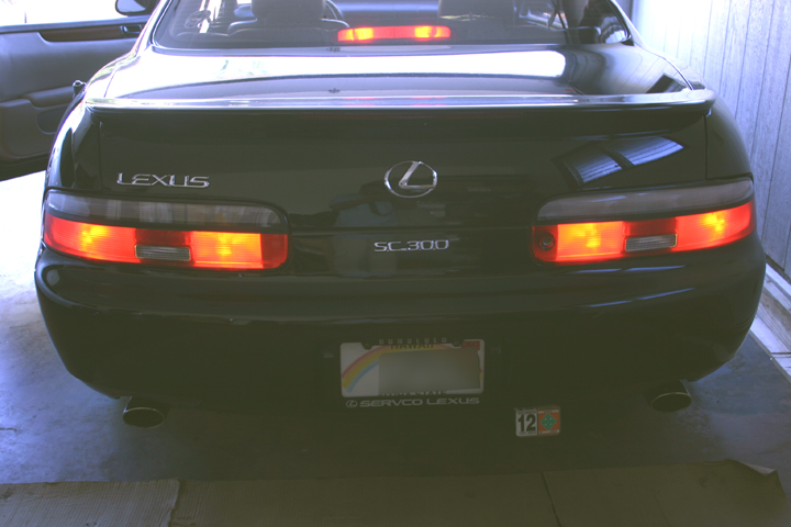

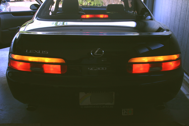

Blinker and Brake shots...I changed the 1156 bulbs from clear to orange.
