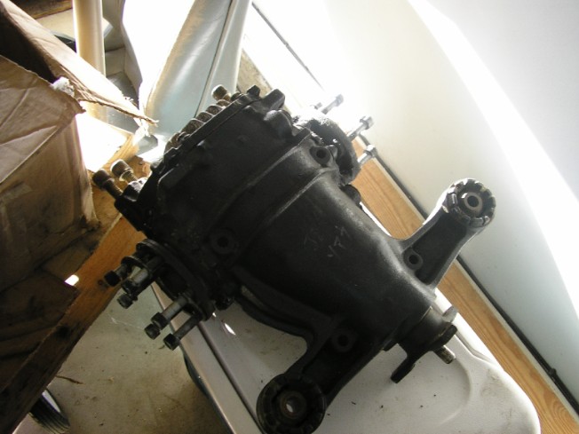

Is this one?

Mine is identical to that... so is that a Torsen?

a Torsen will act just like an open diff if there is no force on the other wheel.
the easiest thing to do is to just open the diff cover and look.
it's only 8 bolts to remove, and changing the gear lube isn't a bad maintance idea anyway.
inside should look like this
