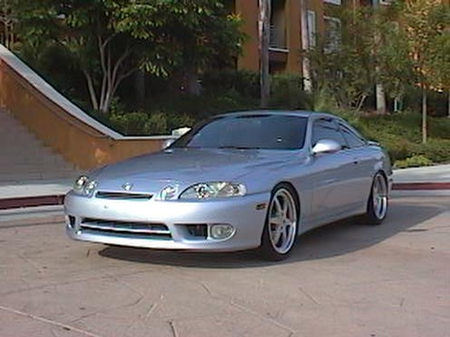

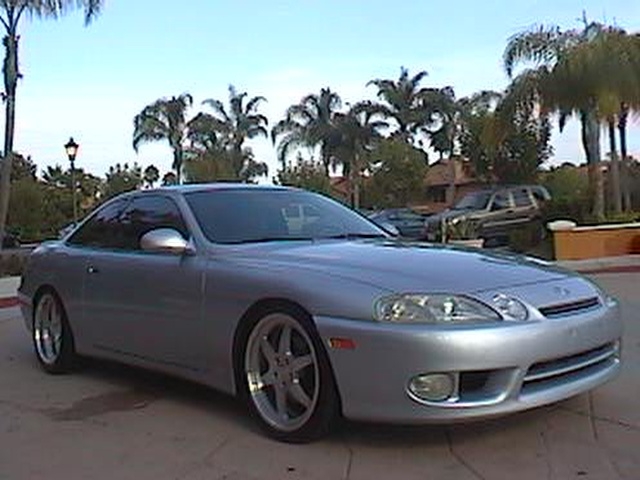

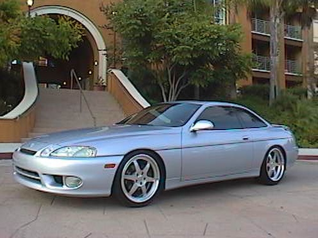

whats the exact sixe of your rims and tires? did you lower it and if so, what susp. setup

lookin good love the color, dropped nicely too!

Yeh, Post specs.
Wheel fitment is perfect.

Here are the specs, along with some wisdom I learned from Mike (aka Manaray)
19x8 245/35/19 +32
19x10 275/35/19 +44
My Setup
The rears will need the rubber moulding removed and either shave or roll (carefully) the wheel weels. They didnt rub that much but I didnt want any rubbing.
There are allot of different combos. Most people prefer the 275/30/19 in the rear. I went with the 275/35/19 in the rear because I knew with the 19x8 rather than 19x8.5 the front tire would be taller. I dont like the front tire being taller. If you completly shave the rear well you can do a 19x10 +40. Its very tight though. If they make it you can get the front in 19x8.5 +38. I didnt want the rivets so that dictated it to a 2 piece wheel and they only do whole sizes at Iforged in the 2 piece. I was originally gonna do the 19x8.5 +38. Once again if it wasnt for mike (aka Manaray) I would know none of this.
It is lowered with Espelir springs, and stock struts. The struts are starting to hate the drop springs. Its been lowered for over a year, so its time to upgrade.
