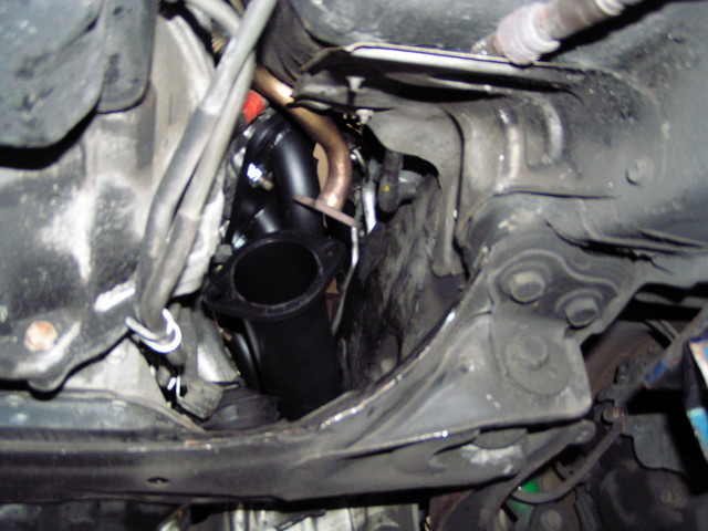

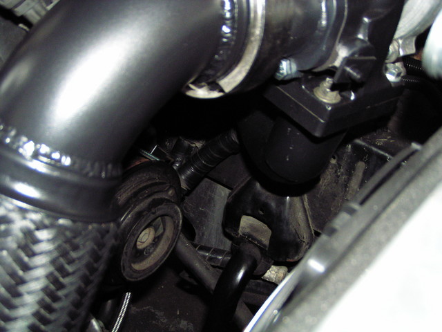

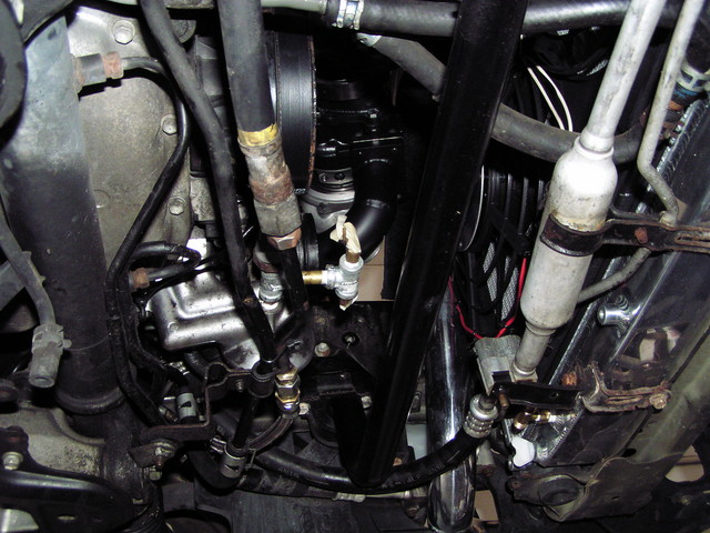

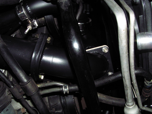

Here are some close ups of the down pipe under the car and its fitment...
Down pipe...Two-piece...
Down pipe under the Y DP flange, above the sway bar...
Down Pipe at the back of the engine...
Oil Tap...
Ryan

Sweetness.... I can't wait to see the intake piping from the turbos to the intercooler and from there to the TB. Is your intercooler a dual inlet single outlet?
What are the diameter sizes on all of the plumbing so far? looks to be 3" DP's into a Y that flanges to what seems to be a smaller diameter 90 bend before it reaches the actual downpipe. (or before the cat exhuast whatever you want to call it) Are my eyes deceving me from the pictures?
Also the DP isn't installed in the oil tap picture, correct?
I know this is picky but the oil tap looks like you got it from home depot, it looks like lead gas pipe T fittings. I know it works but couldn't look a little more professional/Cool like some aluminum AN fittings for all the money you've spent.
Yes
The Y Bend is not a smaller diameter, it is all 3 inch
[COLOR=Blue]I do not believe it was in this pic...I took many, so I have to check....[/COLOR]
Actually I agree with you, and those are being changed to the AN fittings...

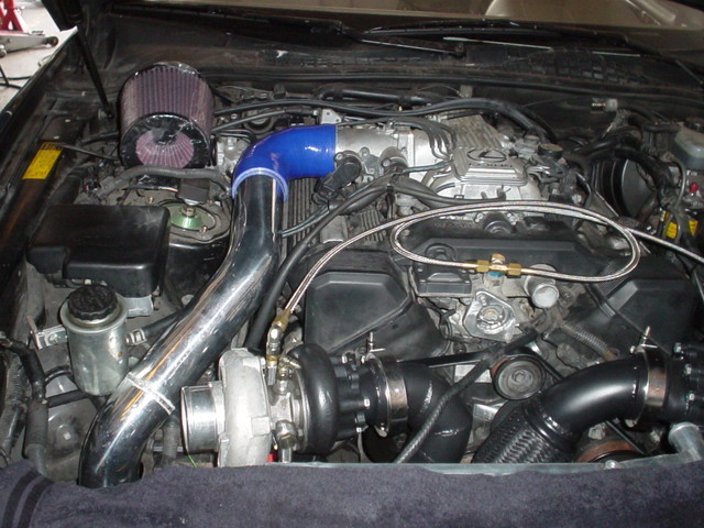

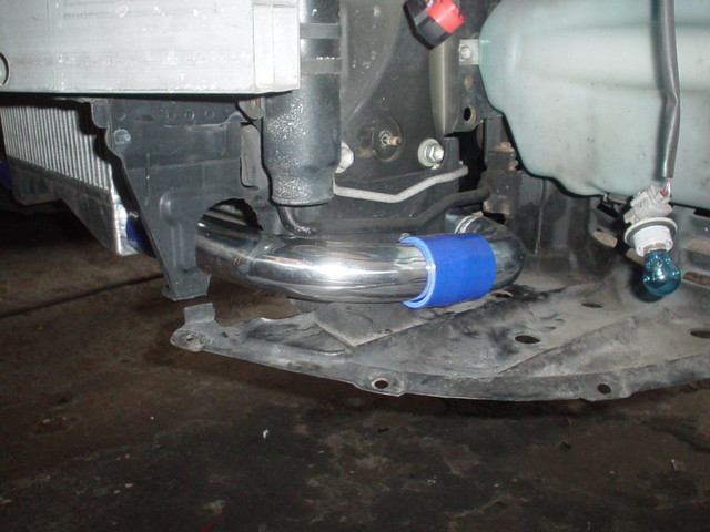

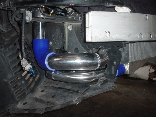

As promised, here are some more pics...The steel braided lines are only connected to account for all the parts for now...They will be resized properly.
Lower Intercooler piping and intake piping on passenger side...
Lower intercooler piping on driver's side...
Upper intercooler intake pipe...
More to come...
Ryan

Very shiny... oooooo.
Looks as if that pipe might be in the way of that intake?

It's not...just looks that way in the pic.
