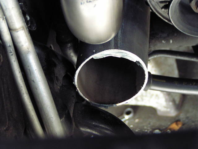

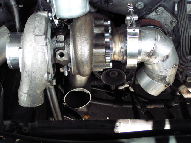

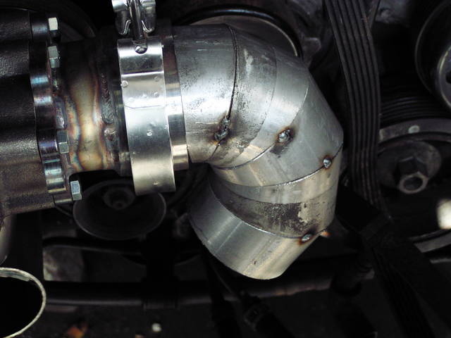

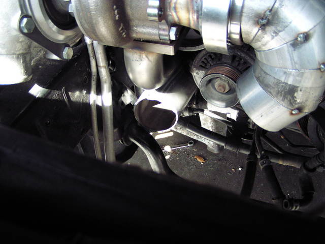

Well guys, went by and saw the passenger side downpipe today...Exciting!!!, it's almost done on that side. I took some pics and will post up later on today. BTW, we are going with 3" downpipes instead of 2.5" downpipes....
Looking good...I like his welding, he made very precise cuts for each piece of stainless...

OK Gang...I am tired...I fell asleep on the sofa, woke up a few minutes ago, and realized I had not uploaded these photos of the downpipe as it is being made. I snapped these about noon today, and I was told that by the end of the day he had finished the pipe going all the way down...I will snap some more pics tomorrow. Making more progress...There is Light at the end of the Tunnel...
Ryan

May I ask why you chose to do section welding instead of mandrel bending? I'm not a mechanical expert, but I would just assume that a bend pipe would be a more constant and smooth flow than the welds.

You can only mandrel bend down to a certain radius before you start to excessively weaken the pipe. Remember in mandrel bending, you stretch out the outer wall of the bend thus thinning it.
The shown pipe is 3" and the radius of the bend is VERY small. An equal radius mandrel bent pipe would have a paper thin wall at the outer portion of the bend. Obviously for a downpipe you do not want this.
Section cuts like Ryan's guarantee uniform pipe wall thickness and strength. It takes much longer and is more labor intensive but you also get any (and/or even variable) radius which helps a TON in an application like this where space is at a premium. That pipe needs to contort into many funky angles while retaining strength.
