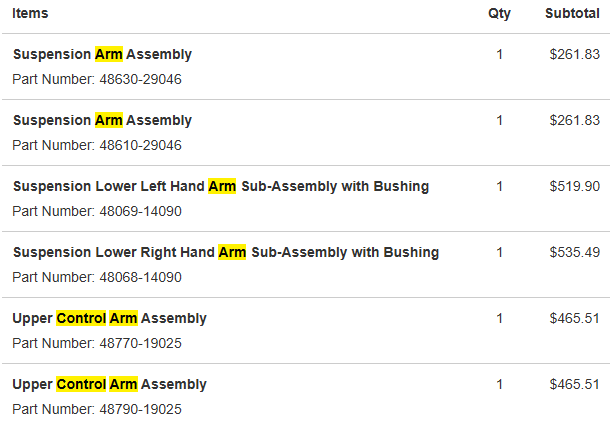

We go to Toyota for this. Just so happens the front upper/lower and rear upper from a 1993-1998 Toyota Supra fit onto our SC300/SC400 and include new bushings and balljoints. I recommend waiting for a 25% off sale and buying from an online supplier, I saved a lot of money by doing this.
For rear lowers, we have to go aftermarket like Figs or Ikeya Formula.
