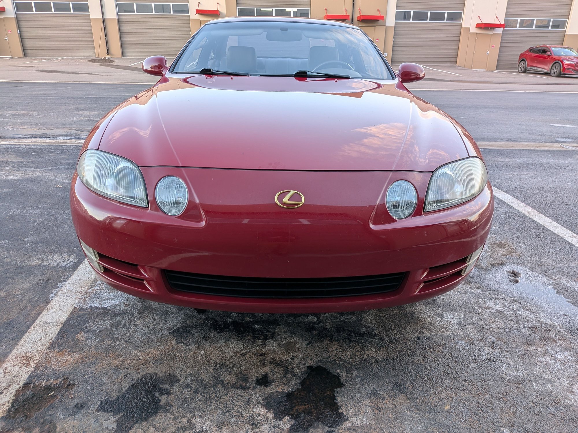

Just picked up this sweet 1995 SC400 with 144k miles. Really clean car, zero accidents, stack of maintenance records. Has a little scuff on the rear bumper otherwise it's pretty dang clean.
It's had some love put into it. I noticed the whole ignition system was recently replaced, had a timing belt done 6 months ago, good tires, good brakes, etc. I think it may have a valvebody or some transmission mods because it shifts hard as hell.
It is build date 6/94 and has square fuel rails, I think that means it's got the big rods?
Some issues: amp was fried. Gas cap cover broke off, gas filler drain hose had been pulled off the nipple, so water came in through the gas filler drain and dumped directly on the amp. Filled the inner fender area with 6 inches of water. Got a replacement coming off eBay. Driver's seat has something wrong with it, won't lean back fully and not all adjustments work and heated seat doesn't work. Probably will just go with a totally different make and model seat as Supra seats are impossible to find. I'd rather have something sporty than Lay-Z-Boy spec.
Coolant tank is leaking, ordered a replacement.
Short term goals are to install an LSD and 6-speed, convert to COPs, DIY something cool with the exhaust and some 17" wheels. It really pains me to drive it with the auto but for now it's a cheap daily.
Long term maybe supercharger and definitely suspension. Swap the brown interior for grey or black.
First thing I did was install my A.P.E. Flex Fuel kit I had from a previous vehicle. Then I filled the tank with E85.
Diagnosed the amp, ordered a replacement.
Glued the gas door back together.
Filled it with E85 and took it drifting in the snow and I don't even have license plates yet

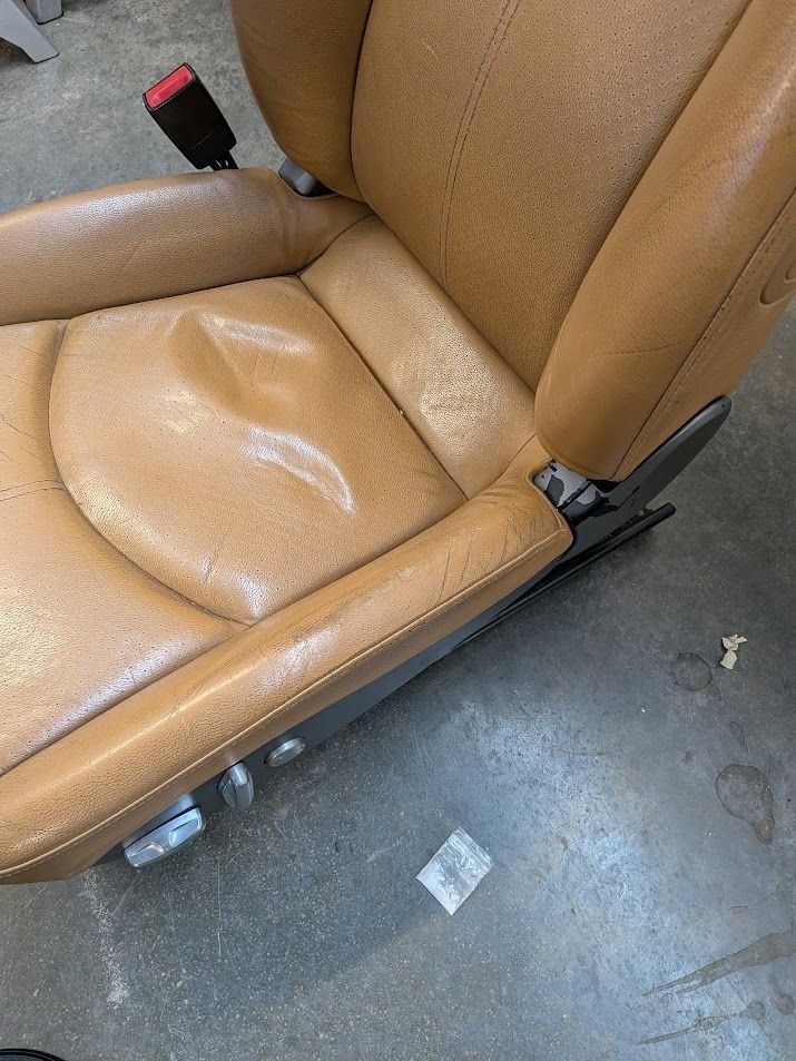

I also scored some '03 Boxster seats! $70 for the pair. I think they would fit in the SC, the mounting measurements are similar to S2000 seats but I'm going to put them in my Miata instead and find something different for the SC.

I happened upon those black Boxster seats a few weeks ago and I really liked them a lot. I test fit them in the SC400 and they fit pretty good which lead me to try and find a set of Porsche seats that would match the Lexus interior. I found a set of tan seats from a 2008 Cayman and went and looked at them. In the dark under sodium bulbs I thought the seats were pretty close to the beige/tan of the Lexus, but once I got them home I realized they're much more orange than beige. I think they still look ok and don't clash too bad. Long term I can either swap in some beige Porsche seats or get some replacement covers or whatever.
I ground the rear mounting brackets off the SC seats and used them to anchor the Cayman seats. I welded the inboard bracket to the rail and for the outboard side I welded a piece of steel to the SC bracket and a matching angle on the Cayman rail with a bolt. That way I can bolt down the bracket, then place the seat over the top. I reused one front bolt hole and installed a rivnut for the other hole. The seatbelt receptacle swaps straight over.
The Porsche seats are heated which was simply a matter of hooking up the power for the heating elements to the Lexus output. I did add a relay so I could pull power from the larger gauge 30A door fuse for the seat heaters, but still use the smaller gauge wire to switch it on and off. That part is easy and works great. The seats heat up really quick.
Wiring in the Cayman power adjustment to the Lexus is easy for the passenger seat but more complicated for the driver's seat. The Cayman passenger seat doesn't have memory control, so you simply power up the seat and the controls will move the motors and adjust the seat.
But the Cayman driver's seat does have a memory ECU in it. I either have to swap the seat ECU to the non-memory version and rewire everything, or I can use an Arduino to spoof the CAN messages and operate the seat. Apparently the Porsche community has tried this and the seat won't operate without the CAN messages and the Arduino thing has been done more than a few times.
For now I just used a 12v battery and some test leads on the motor directly to adjust the seat for mounting, and then set the final position.
Long story short: other than the color mismatch, the seats fit really well in the SC400. There is a lot of room on either side which does look a little awkward, but you won't lose your phone. The seats are super comfy and sporty. It also lowers the seating position a good 1-2 inches, no more bumping your head on the sunroof. They are lighter than the SC seats and I plan to remove the airbags to lighten them up some more.
