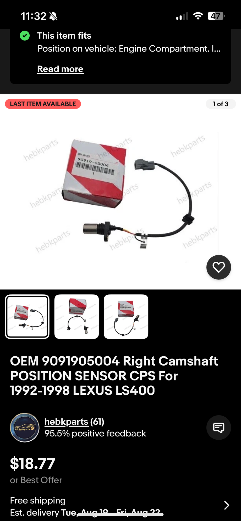

Ok so this sensor works? I know it says ls400 but should be same correct?
Well i do have to wonder if anything at all in that listing seems .. off in any way to you?
The part you shared is one of MANY Counterfeit listings that litter eBay and Amazon, here is a thread about it, chances of getting an Actually OEM part there on a whim, while not completely absent, are pretty close to it, hence why I always suggest to avoid those platforms as much as possible, and only purchase parts from Trusted Vendors.
Looking up both Part Numbers online, they are Discontinued at every place I've checked, goes to show that there really isn't too much demand for them. Right now, your best option in my opinion would be to source a Used OEM Sensor, again, they almost never fail, and chances of getting Counterfeit with a Used part are a lot slimmer, not to mention the cost benefits.
That said, if it's just the Wires that got damaged on the Sensor you have, I see no reason not to simply repair the Wiring, which will be just as durable, while even cheaper. Here is a thread that describes all tools and materials required.
