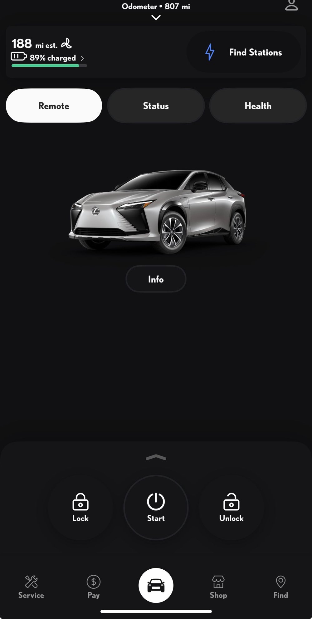

Why exactly do you want to "remote start" the RZ?
If your goal is to pre-heat or pre-cool the car before getting in, you can turn climate control on demand from the Lexus App, or pre-schedule climate activation 5 mins before you normally get into the car:

I was using the phrase "remote start" to preheat or precool the car in the app.
