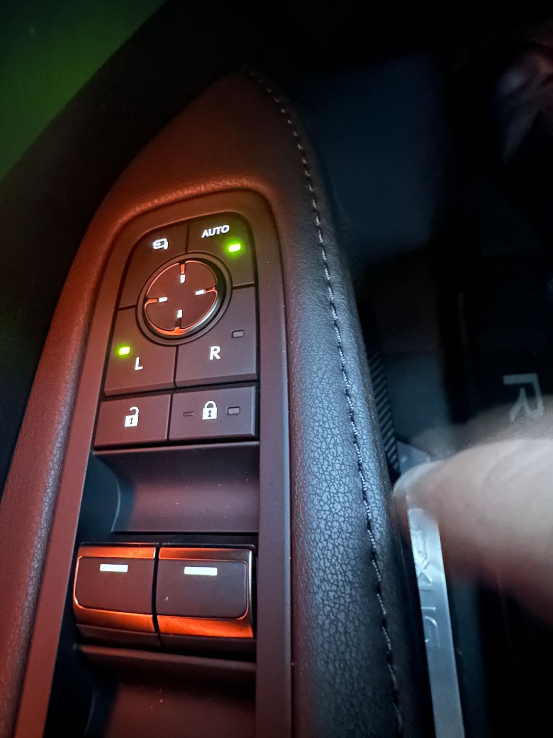

See these above photos. The mirror adjust can be for left, right or neither. If you hit the green “L” or “R” (one is green), it will turn off, therefore becoming “neither”, like the bottom photo above. That’s it! Leave that in “neither” mode and the side mirror tilt stays disabled.

You da man! I knew it was something simple. I didn’t think of hitting the currently lit button again.
