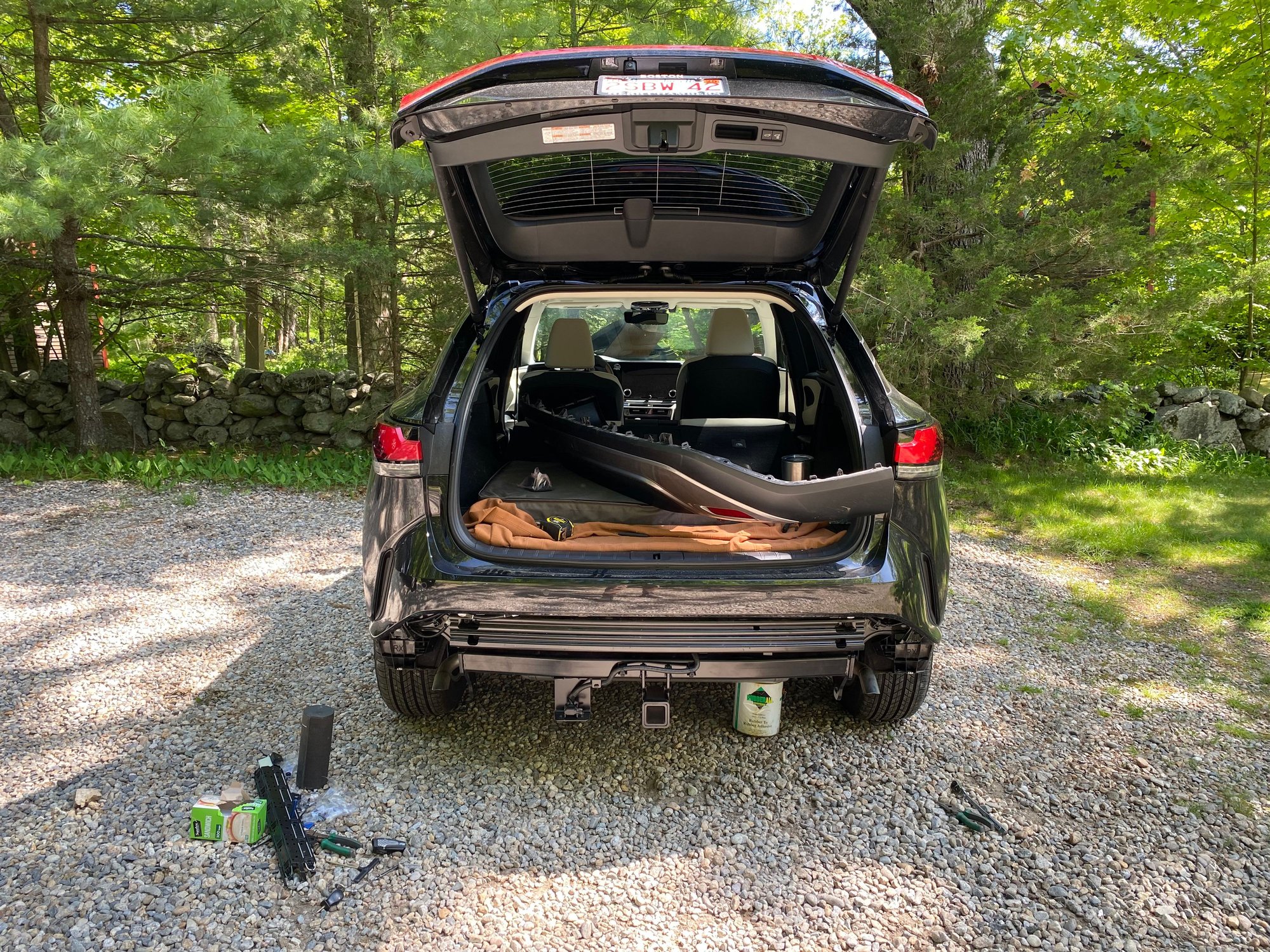

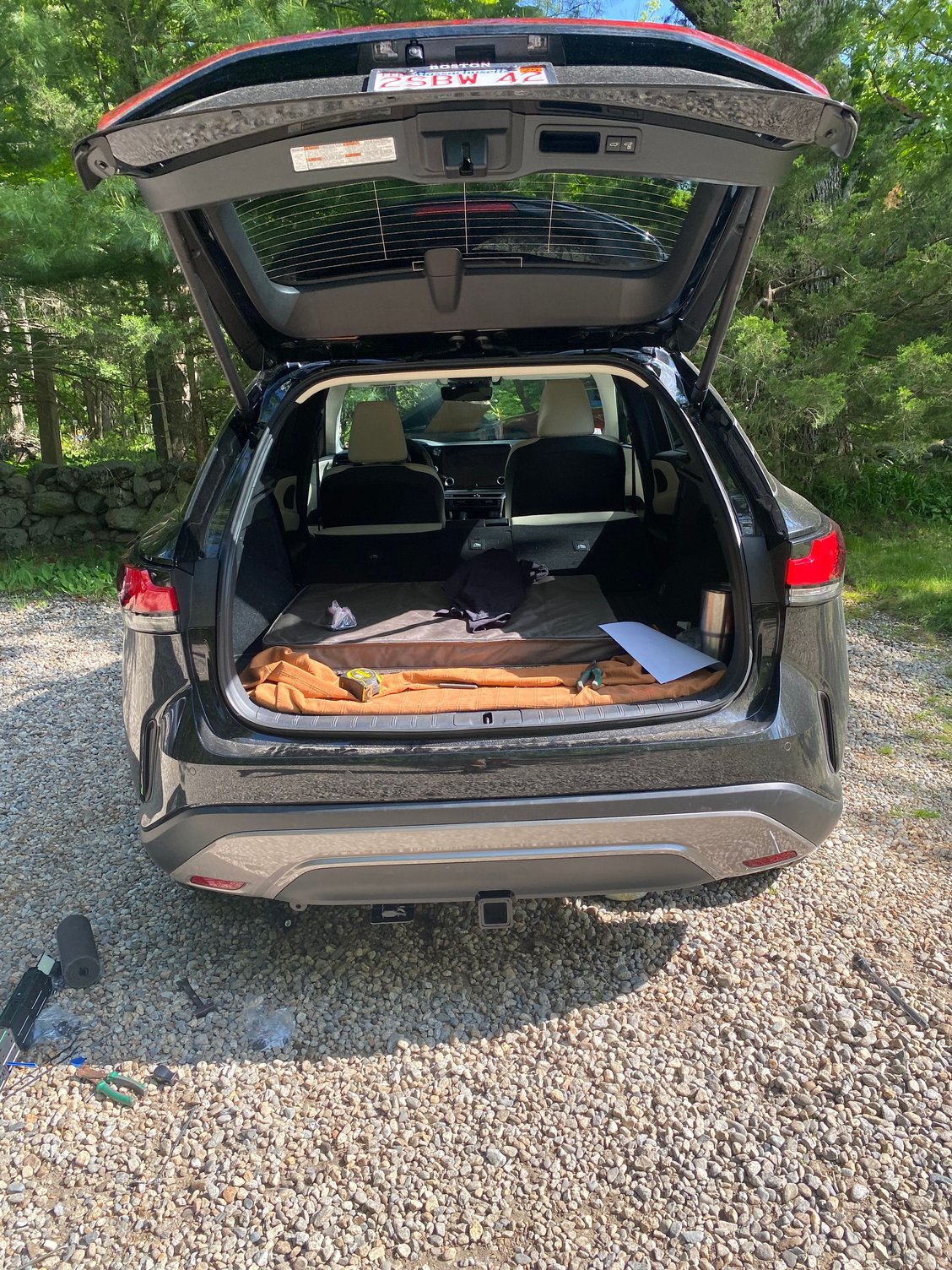

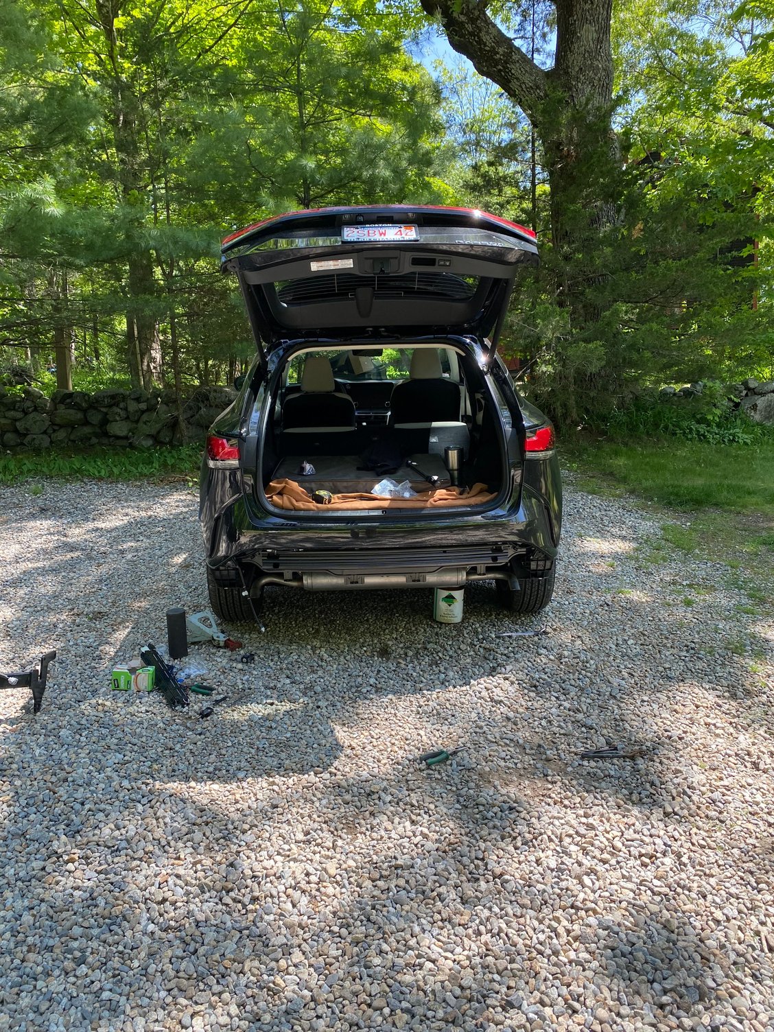

OEM Lexus Tow Hitch Install Guide
Calling this a guide is a bit of a stretch. But it worked for me. Happy to hear constructive feedback.2023 Lexus RX Hybrid 2” Receiver Hitch Install
Skill set: Easy/Moderate
Time: 2 hours
Tools needed ;
17MM socket
Torque wrench
Philips screwdriver
Flat screwdriver
Pick (body fastener removal)
File
Sand paper
Jack stand (or paint can)
*A kid with small hands
*Ice Cream
3-4 New England IPA’s

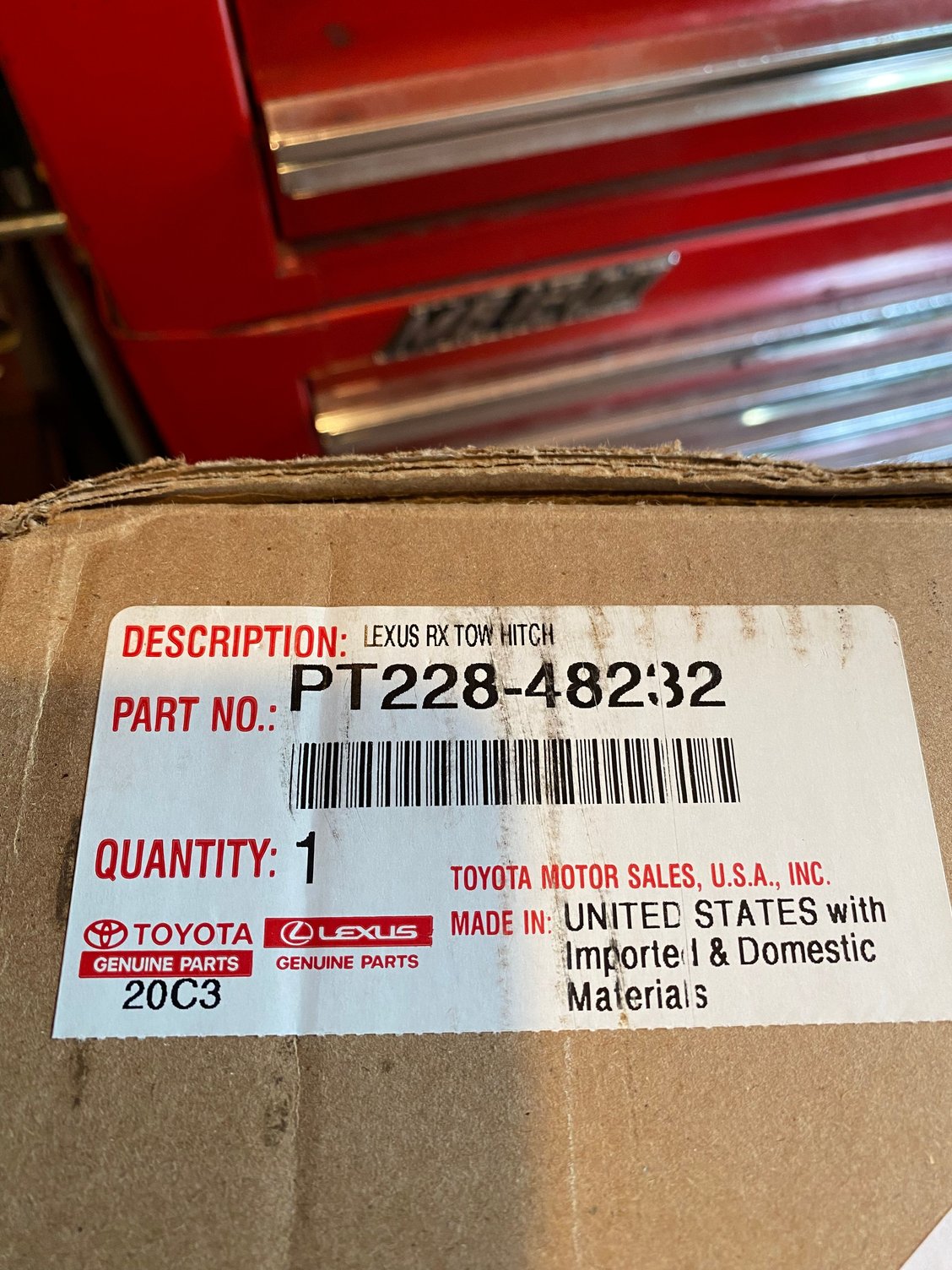

Lexus OEM Part number: PT228-48262
Overview: These instructions are for adding a 2” OEM Lexus Tow hitch to a 2023 Lexus RX350H (should be same for gas). If you call a Lexus dealer, ask if they have the above part number in stock. Do not provide VIN as you will most likely hear “There is not a tow hitch available for this model”. These instructions do not cover installing wiring. My requirements were for using a 1up Bike rack. I will never tow with this vehicle and would not recommend anyone else tows unless you want to install Oil and transmission coolers. I am 100% sure that cutting and altering the kick sensor will void the warranty for that part (mine works fine). I am also sure any fastener warranty on lower bumper skin will be void as well. Move forward at your own risk. Make sure your wife (or significant other) is not home (if this is their car) before starting.
Steps:
  1. Lower bumper skin removal.
  2. Lower bumper skin material removal (hitch cut out)
  3. Kick sensor (if applicable) material removal and wire re-route
  4. Hitch install.
  5. Lower bumper reinstall.
  6. Kick Sensor install
  7. Main Bolt torque
Step 1: Lower bumper skin removal: (put all clips into a bowl or bag to ensure they aren’t lost!)
  1. Open beer.

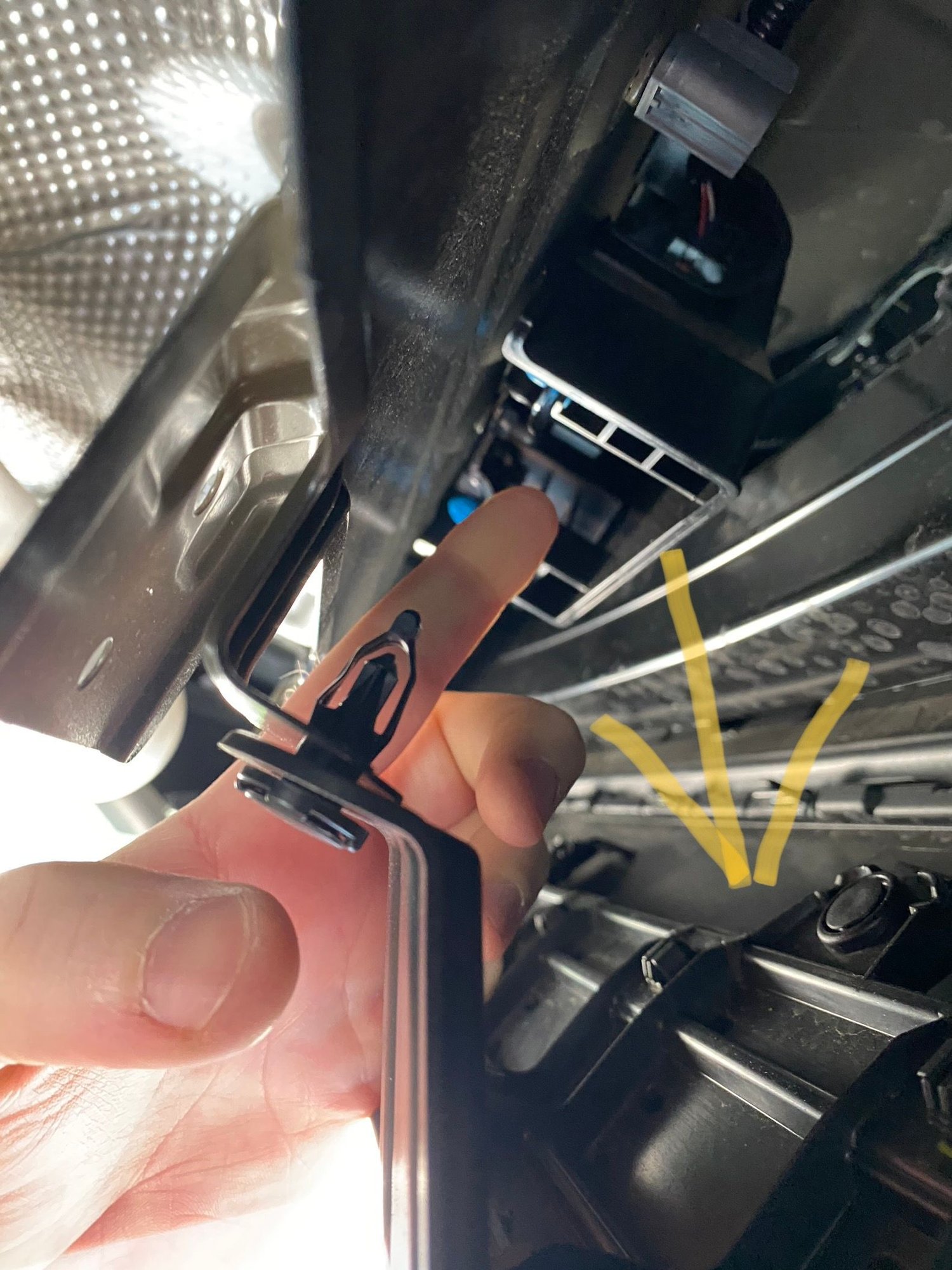

  2. Remove kick sensor. There is one philips screw and 5 black push pin fasteners (probably another name). Use a plastic pick, flatblade, or whatever you need to pop the center out. Never use force… massage it out. Pull it off gently and unplug wire connector (pick helps lift connector tab).
  3. Remove 4 plugs (two per side) on subframe rail (see picture 1). This is where hitch mounts Most likely you can remove by twisting with fingers. If not, use standard (flat) screwdriver. It will twist out counterclockwise.

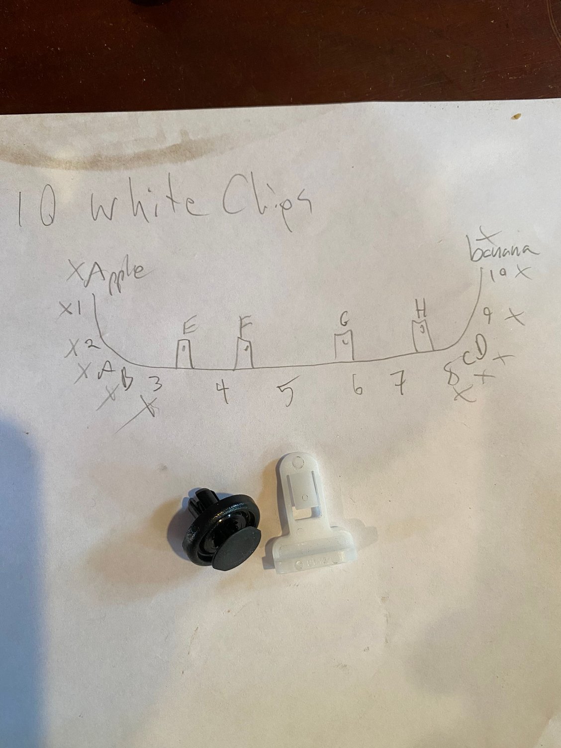

  4. Remove 2 Philips screws (you can use 10MM socket as well) directly behind each wheel (labeled +) on clip diagram.
  5. Remove all black push pin fasteners. There are a total of 8 of these (not counting kick sensor). These are labeled A-H on diagram.
  6. Remove white slide clips. These are tough. I used a trampoline spring tool (able to hold tab down sturdy). You need to push the center of white tab down while pulling front away from hoop. Start with the front ones near wheels as you can see how they work. There are 10 of these labeled 1-10 on diagram. On final removal, be prepared to support skin so it doesn’t get scratched by falling off.
  7. Pull skin down and out gently. There is a wire harness- push support tabs out of way using pick.

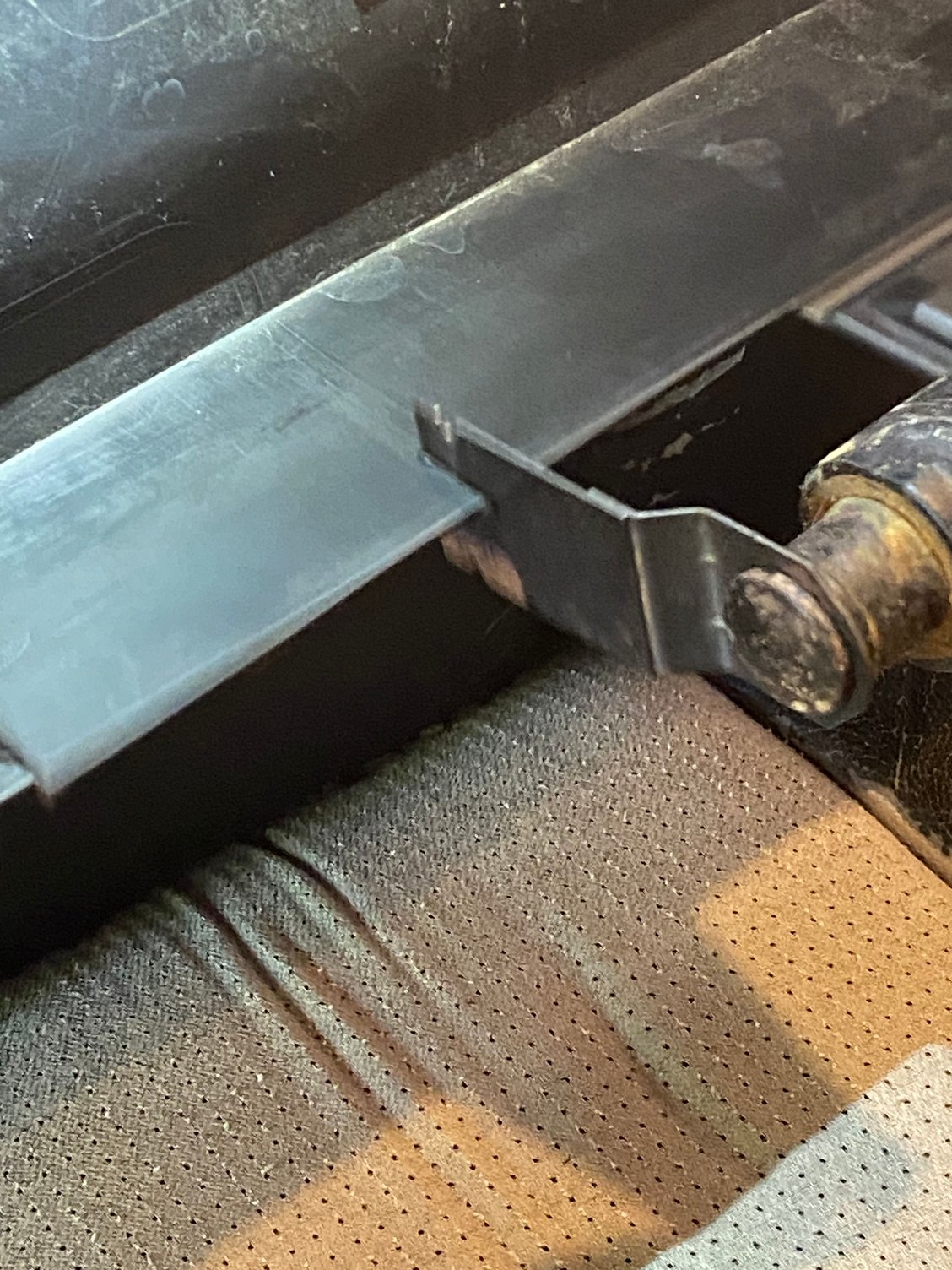

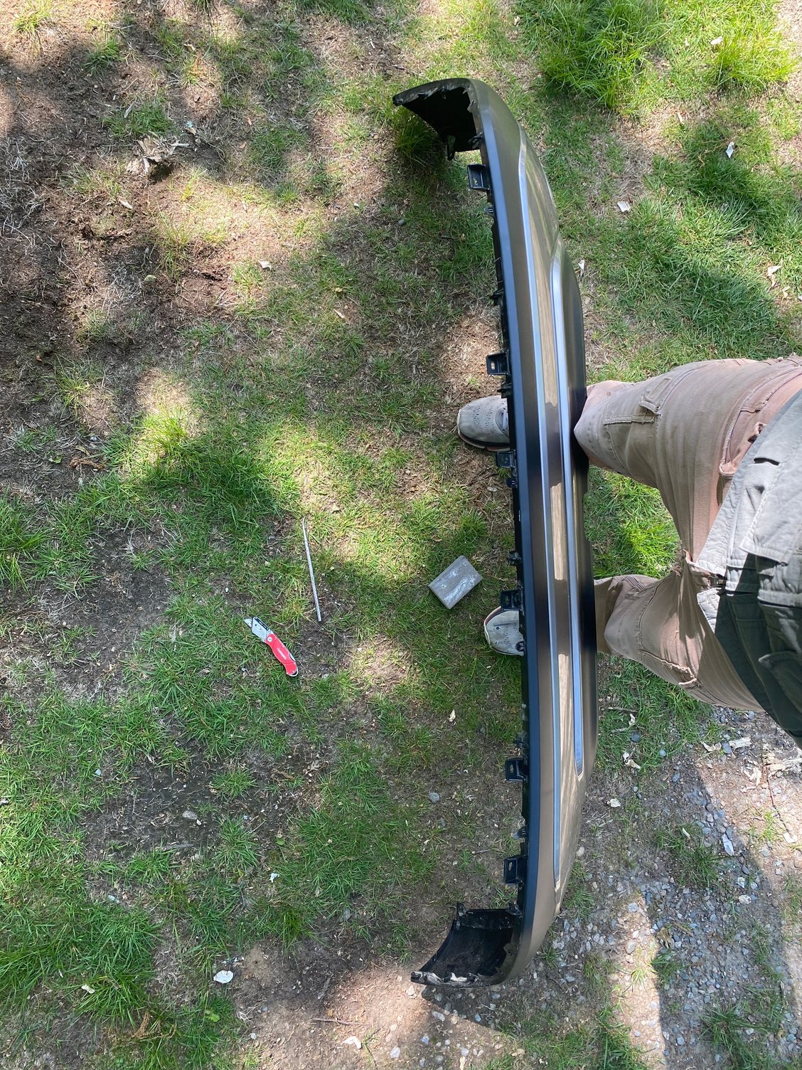

Step 2: Lower bumper skin material removal (hitch cut out)
  1. Open beer.
  2. Place bumper skin on soft material (I used shop chair). Blanket in yard or work bench would be best.
  3. Find faint lines (see picture) and use a multi tool to cut out. Use the smaller of the two lines. Take off the minimum amount. Go slow. The bottom up cuts are simple. Do a plunge cut under top line and trim up to line. Do not try to cut the corners by arcing the blade. Instead, do several straight lines up to the line. You will sand it out later.
  4. Use a cheap sanding block and slowly round off your cuts. I used a file too.
Step 3: Kick sensor (if applicable) material removal and wire re-route
  1. Pull 2 of the lower center black plastic square tabs out. Pull the 2 lower wires aside. Place back on the lower bumper skin (still removed) and mark the minimum material you need to remove from the kick sensor (its not a lot).
  2. Place 2 lower center black plastic square tab back in (without wires being retained)
  3. Cut the section out using a multitool.
  4. Remove 2 lower center black plastic square tabs and Place wires back in where the two squares were removed. Use quality zip ties to route the wires up around the hitch area. The wires should remain as close to parallel as possible. These are the sensor. (sorry for lack of picture).
  5. Place aside and move to next step (do not reinstall yet).
Step 4: Hitch install.
  1. Open beer.
  2. Place jack stand or paint can on either side of mounting location.
  3. Keeping 4 main bolts in hand or pocket, place the hitch on one side of jack and lifting into rough position on other side. The hitch has to be pretty damn close to bolt hole. Do not strip!!! Finger tighten first bolt into hole (at least a few turns). Repeat with next bolt. Switch sides. Finger tighten 2 bolts on other side. Do not torque yet.

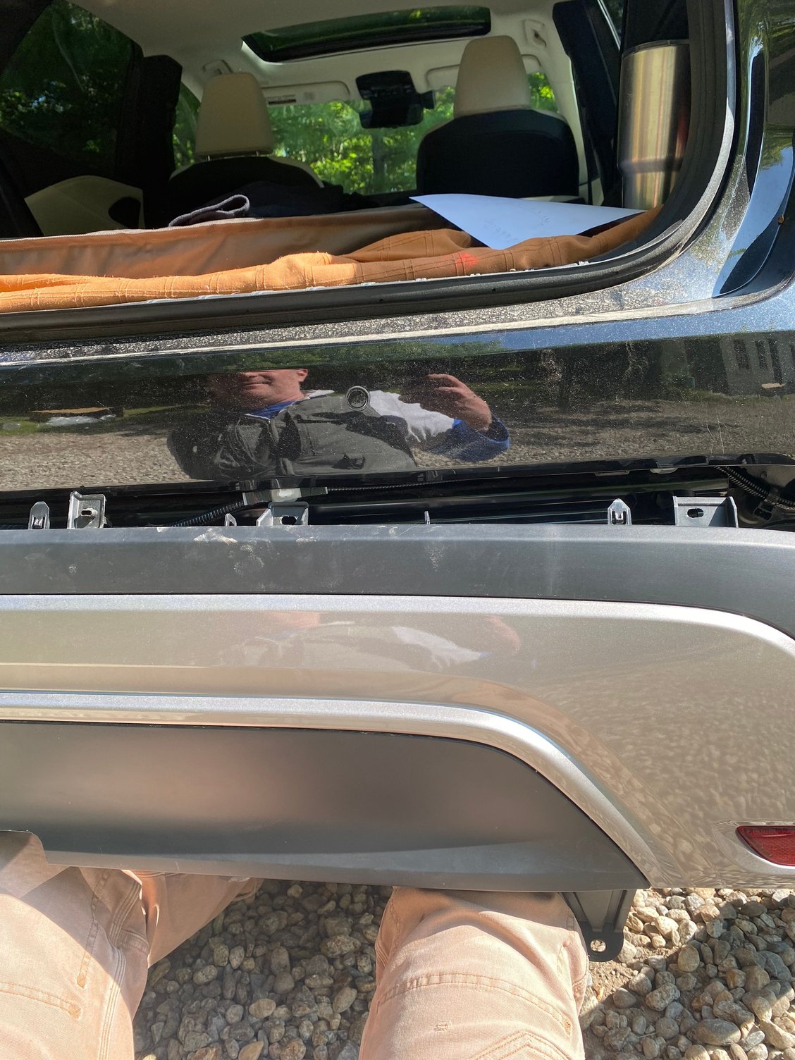

Step 5. Lower bumper reinstall (hardest part- need to be able to massage the lower skin parts in as well as wiring harness- also need small hands).
  1. With lower bumper skin in hands, sit down on ground with legs under car. Place lower bumper on thighs and use legs to support as close to upper bumper as possible. There is a wiring harness the supports the main wire to parking sensors. The wire has tabs that stick into the lower bumper skin. Snap them in (pretty easy to snap them in).
  2. Reinstall clips- The lower bumper skin should be slightly secure via the above step. Gently place first 2 white clips on each side (1,2,3 and 4 from diagram). I would then work by placing each of the clips and pins in alternating left to right. The absolute hardest part for me were 4 center white clips 4,5,6 and 7. I torqued my hitch on during step 4. The gap between the subframe and the hitch bar is tiny. I had to have my 10 year old do it… which was really hard to walk through. He rocked it though… lots of ice cream.
  3. Reinstall screws- screw in each of the two philips screws (you can use 10MM socket as well).
Step 6. Kick Sensor install
  1. Open beer (optional)
  2. Slide the modified kick sensor in above the hitch. It’s a tough fit, but will slid in on an upwards angle. Do not force, massage. Plug in.
  3. Test kick sensor.
Step 7. Main Bolt torque
  1. Torque 4 main hitch bolts to 77LBS (double check this- I pulled it from 3rd party site)
Uploading pictures from phone .. see next comment
Reply 5

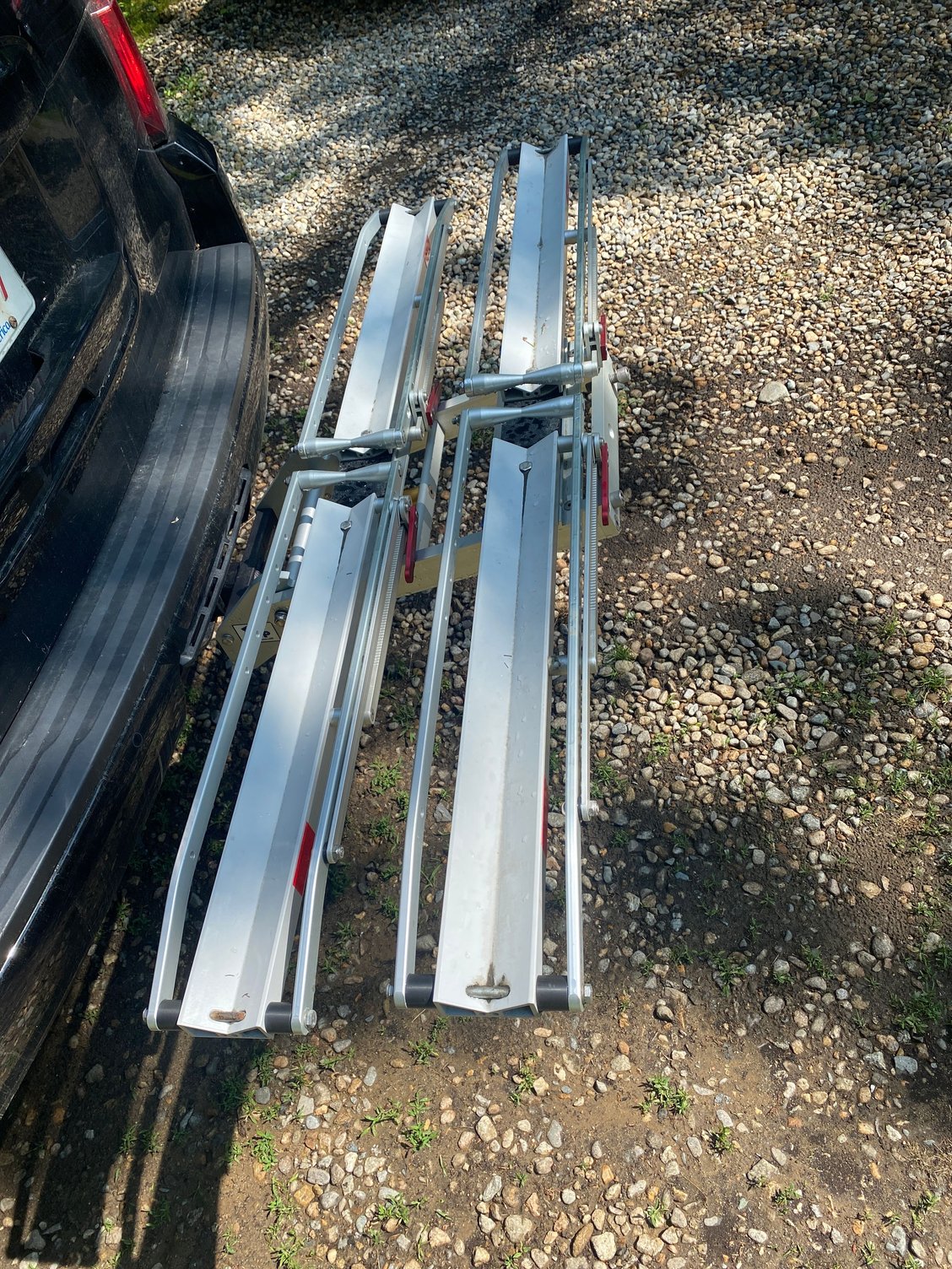

quoting myself… (ha). This is a 1 up rack in 2 bike mode for tjoses who are curious.
