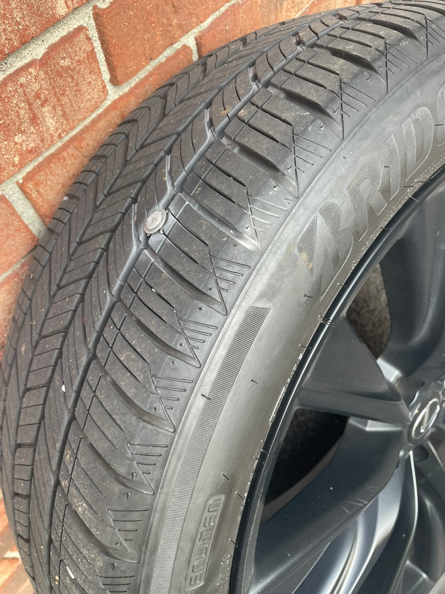

I noticed a screw in my tire a few months ago.
It took ~ 15 miles for the TPMS light to come on...at that point it was at ~24 PSI.
Ugh, I hate that discovery. Thankfully doesn't happen too often. Full disclosure I also hate the Bridgestones (at least on the wife's UX). But that's a conv for another thread...
