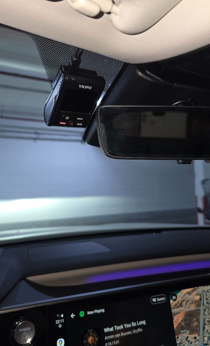

Take a look at this post from the Dashcam thread, and linked adapter. It worked with my 24 RX450H+ digital rear-view mirror and another reviewer said it worked in their RX500H. So I'm guessing it should work fine for a RX350H.

My RX has the digital rearview mirror, and I used the Dongar 10-pin power adapter for installation. It was a super clean setup, took 15 minutes, there's enough room to hide the entire adapter inside the casing, and the power cable is hardly visible. The camera turns on/off with power, and the digital mirror functions normally. Perfect solution.
