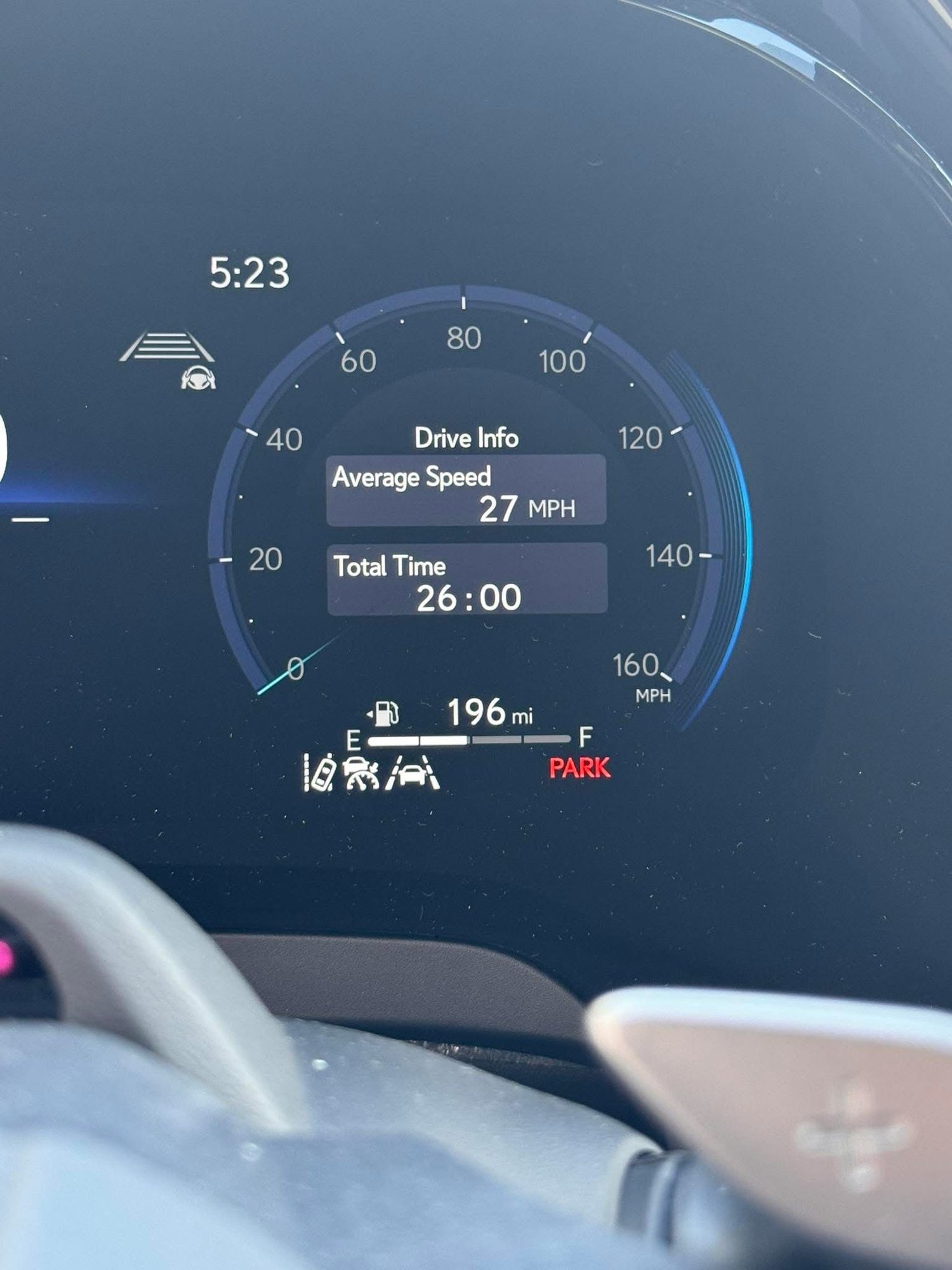

The “Average Speed” in this meter screen has not change since Day One. Every other guage works.
has not budged in the 700 miles since new. 40 miles per day, half at highway speeds. It never budges.
What’s going on? Is there a reset?

This post for the NX likely applies to the RX: https://www.clublexus.com/forums/nx-...otal-time.html

The TOTAL TIME changes? How about MPG?
Have you tried the resets in the Topic, above? We do that each fill-up and it resets the MPG, and speed averages. We never look at time, though.

The total time changes. In fact, it clicked on 26.0 hours just as I took that photo as I was idling at a drive in window. I’m not worried about the total time. It just happens to show in that meter.
MPG updates. Just not speed.

I got it, thanks to a video someone made for me on a Facebook group. (I’m a visual learner!) It was there in the settings all along but I was overlooking a link.
Vehicle (car icon) /Trip information/History)update or reset.
Still have no idea why the average speed never changed from 27 mph for over 700 miles since new.
We’ll see if reset to zero has an effect.
Anyone know the difference between “update” and reset” in this setting?

I only use UPDATE when fueling. I bet that RESET changes more stuff...
