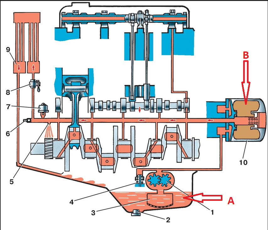

I have couple of questions for you and these are not trick questions.
Which parts did you collect for your oil sample, oil from part A or part B?
Do you think the oil in part A is cleaner, the same or dirtier than the oil in part B after 4,326 miles on it ?
Thank you for posting your UOA!

I took my sample from A, about midpoint of the oil drain. I really have no idea what the difference might be between point A and B as I am not aware of any tests done between the two. All I know is that the oil used for a UOA is supposed to come from the sump; either by extracting some from the dip stick tube or while draining the sump.

My thinking is an oil filter with a filtration of 20 - 25µ. Anything bigger than 25µ will be trapped in the oil filter and anything smaller than ≤ 20µ will pass through.
In order to have a clear picture of your oil analysis, one must collect an oil sample from the oil filter (part B) because your oil analysis report will not show anything that is bigger than 25µ.
I hope you and any others reading this thread will let me know their thoughts.
Thank you!
