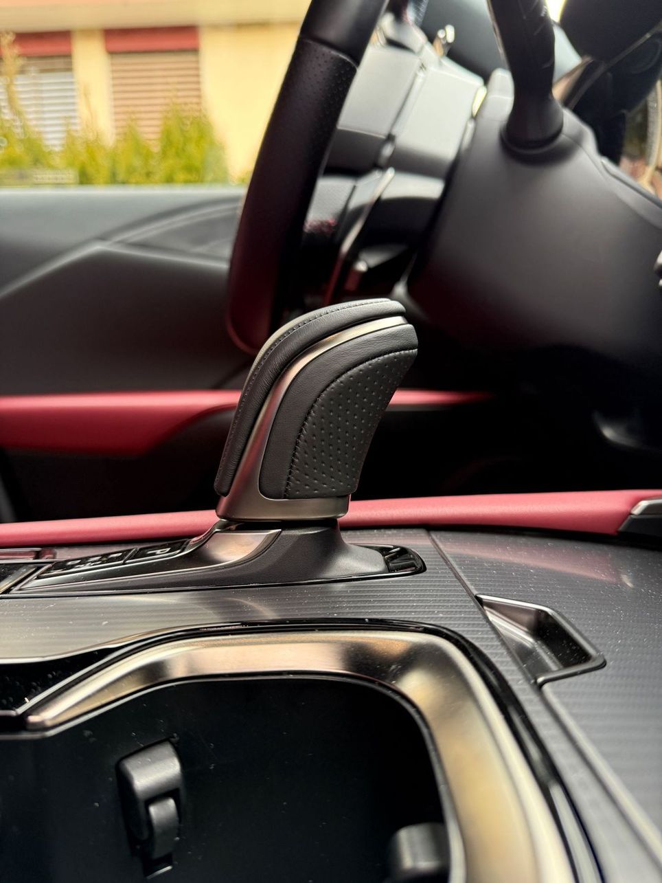

This is the original shift **** from the 2024 Lexus LC500
For me, the short **** was too small. I always had to shift with two fingers. Now... perfect handling.
Maybe someone else will like this too ..

How does the **** come off?

It unscrews counterclockwise.
Nice find btw.
P/N for anyone interested
33504-11010-C1

The LC500 and RX500 have the same thread in the gear ****.
Hint: While the RX500's **** has the same thread, it sits deeper. This means that on the LC500 Shifter-****, the thread (in the threaded hole) needs to be limited (using a piece of rubber or something similar) to prevent the **** from sitting too deep.
then, in my opinion, the LC **** fits much better in the RX.

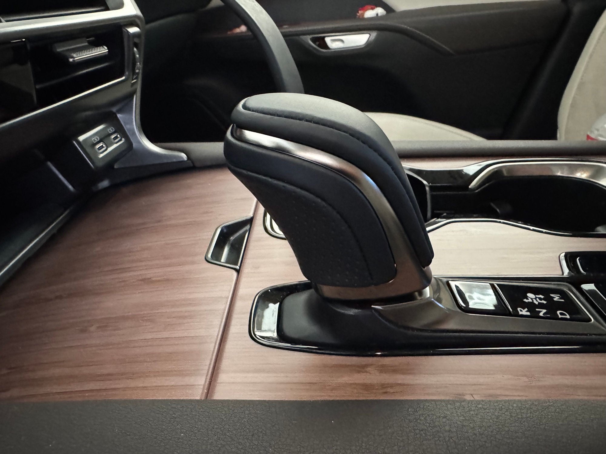

OMG I love this. It fits my hand so much better. I used a little bit of paper towel as a stopper to prevent it from screwing down all the way.
