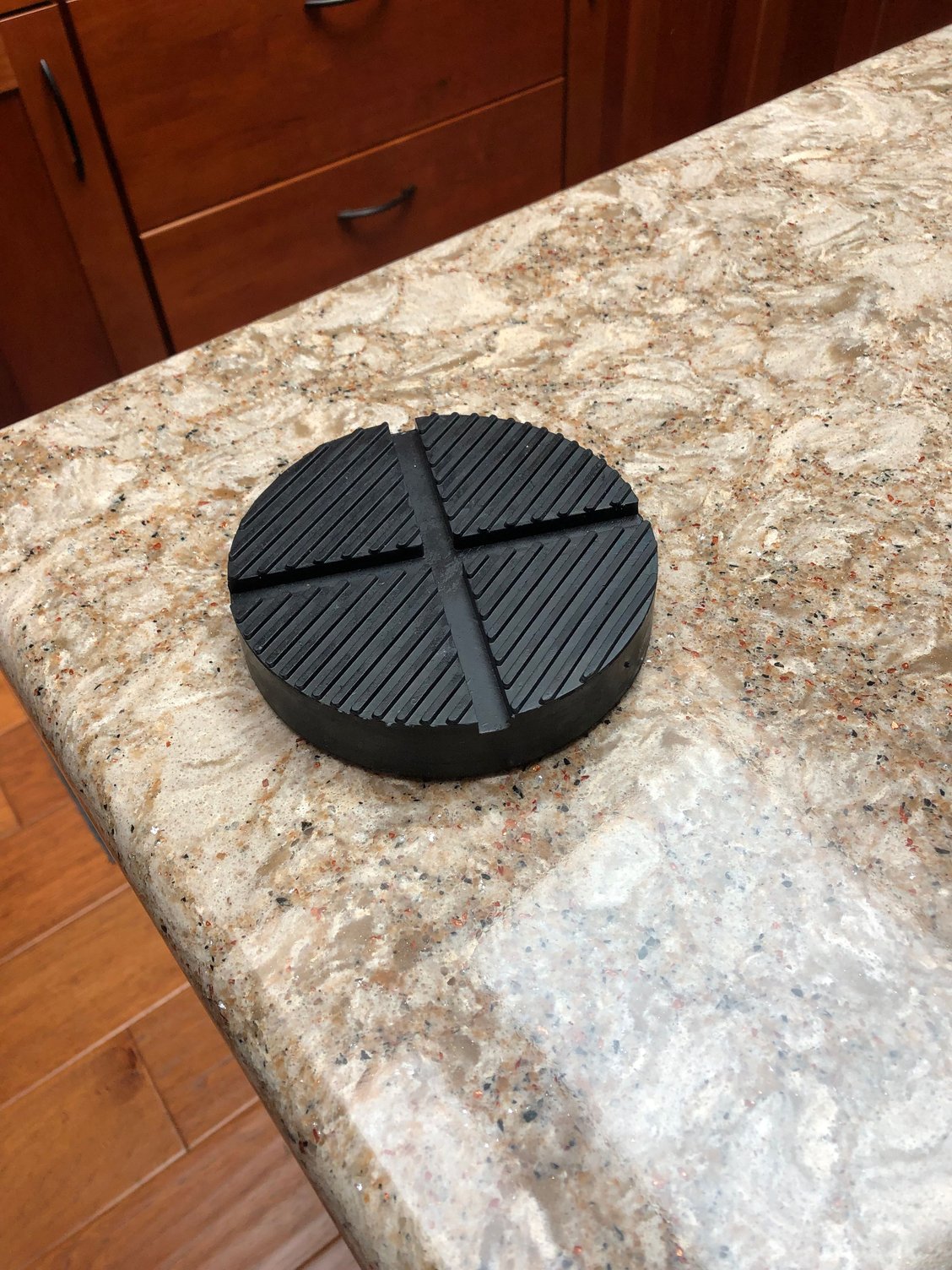

I wish that I had access to a four post lift when servicing my vehicles. Unfortunately, I don't have the space to install one in my garage, as it is far too small. When I do use my rolling hydraulic floor jack I use this type of pad on the jack. I am not certain if the shape is correct for your application but, this seems to work well. I bought a pair of these on Amazon.

Thanks much! I've found a few contenders from the Amazonians. I don't think I'll take a one-size-fits-all approach, but probably adapters for my floor jack, hydraulic lifts, and they even have some that fit the heads of jack stands.
