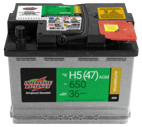

This is what Costco's Battery finder comes up with for my 350h
Recommended For: 2023 Lexus RX350h L4/2.5L Standard
PURCHASE IN WAREHOUSE OR ONLINE
Superior AGM Technology
65-47/H5-AGM battery
36 month Limited Warranty*
Group Size H5 (47) AGM
$179.99**
**Refundable core charge of $15.00 not included
Tooltip
Availability by location will vary
How To Buy
In Select Warehouses
Online and Ship to You
Tooltip
FIND A COSTCO WAREHOUSE
Your Battery Information
Item Number 1624798 Group Size H5 (47) AGM CCA 650 CA 750
They didn't have a listing for the RX450h+ but it listed this same battery for the NX450h+

Up here they sell the Energizer version. But much better specs and a 5 yr unlimited - 100 month prorated warranty. And better specs:
Battery Specs Energizer Group H5-AGM
Absorbent Glass Mat Automotive Battery Amp Hour 60
BCI Group Number 47-AGM
Cold Cranking Amps 680 Amps
Cranking Amps 750 Amps
Reserve Capacity 100 Minute Voltage 12 Volt
$10 core charge for total price $289 CAD.
The Kirkland one is about half the price - 650 CCA with 4 year full and 100 month prorated warranty.

The Costco Interstate battery listed above is a 60 A-H battery so no real improvement. The CCA rating is irrelevant in this application. The Energizer is listed as 100RC, so no improvement there either.
AGM will accept more current during charging, but is less tolerant of being undercharged than Flooded Lead Acid so it's a bit of a mixed bag. There is the potential to mask the issue by charging faster, assuming the charging algorithm will supply the extra current, while possibly having a shorter lifespan.
