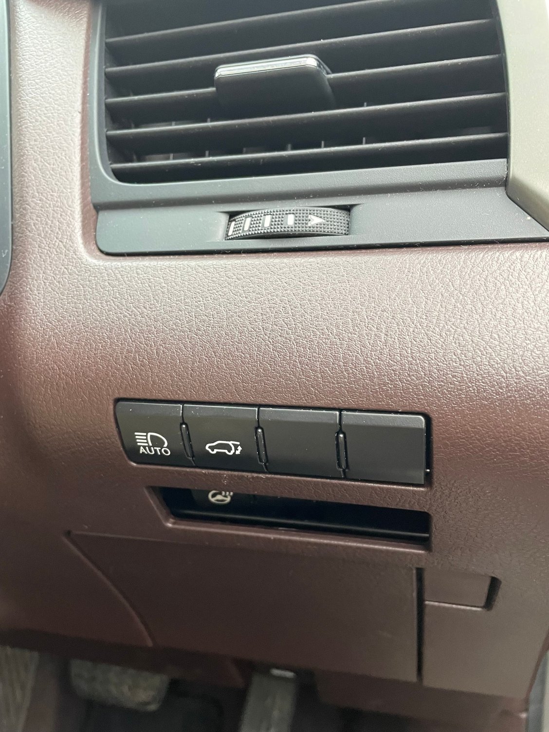

Hello All,
I've gotten a new-to-me 2016 RX450h with everything going great, expect this button bracket/holder is loose. The button works ok, and it seems like it's a clipped-in. Any ideas how to get behind the dash to re-seat this please?

Yep, I went via the side panel. Very easy, open the driver door, clip off the side panel and you can reach in a reset the clip!

Take a look at this thread: 2017 RX350 FSport Build Thread. I believe that you have to access this portion of the dash through the dash side panel with the door open and some fasteners along the bottom.

Thank you! Stupid question, how do I pull that side panel off?

By force, it's just clipped, so with the door open, find a corner, using a flat-knife/tool carefully unclip it (mind you don't damage the plastic)
