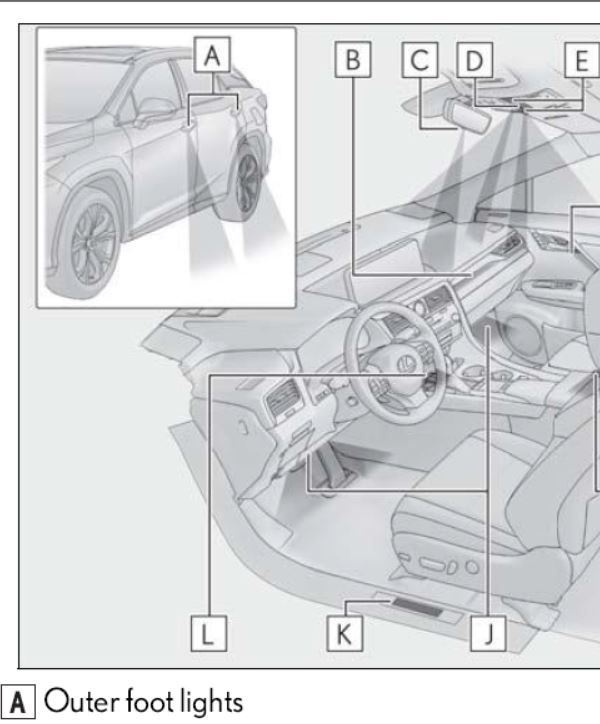

From the 2020 manual. There is no description other than what appears below. It does not look like there are any settings.
