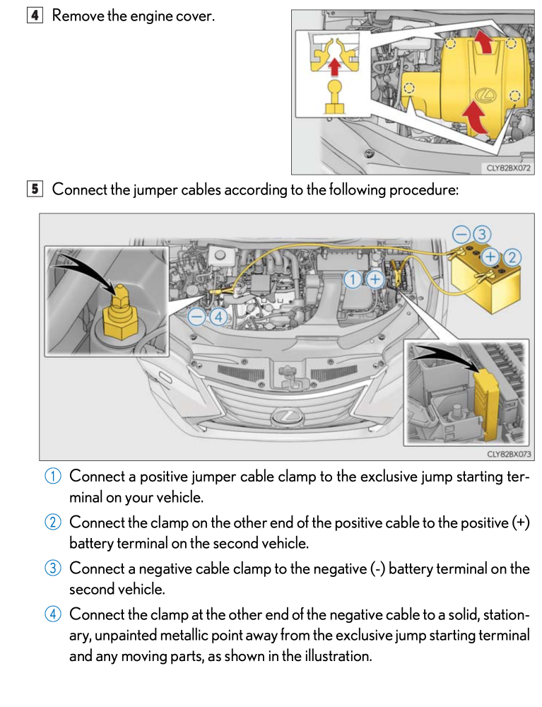

It's possible to jump start from the front like shown here (no crawling involved!)
I talked with one electrician who worked at Lexus, he suggested to jump start from the rear battery - for some reason it's safer?

My 2017 hybrid has these instructions for jump starting from under the hood
