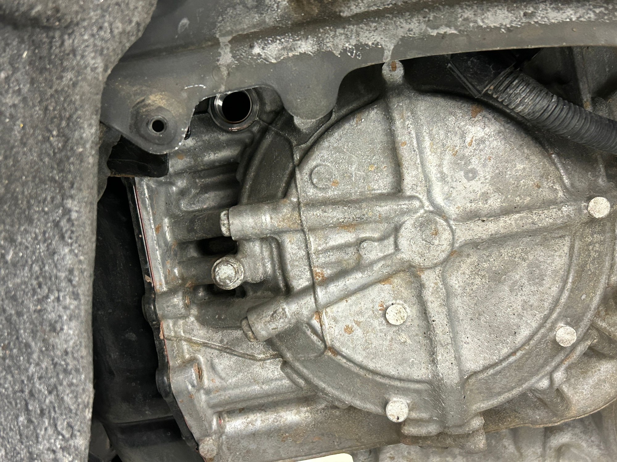

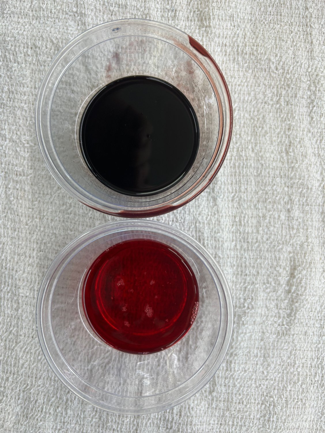

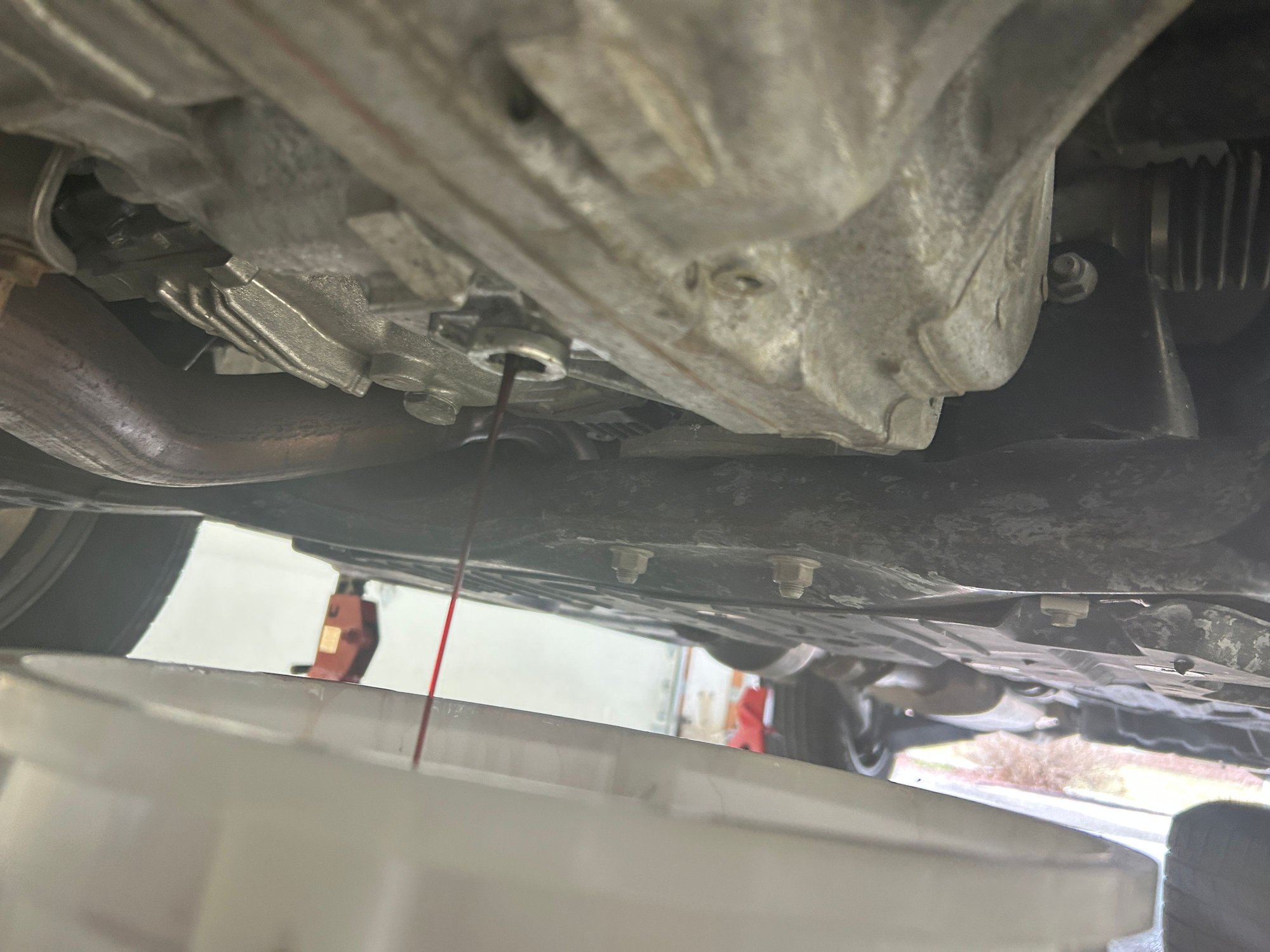

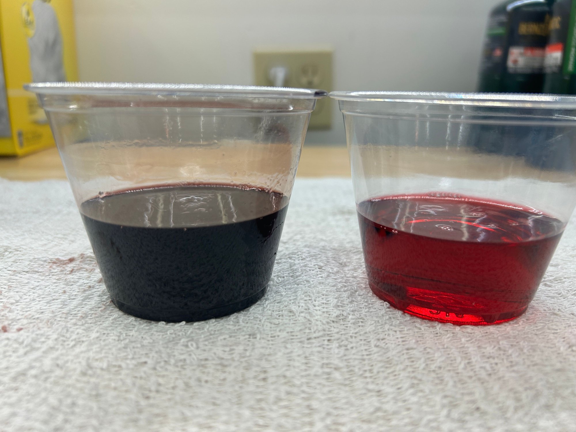

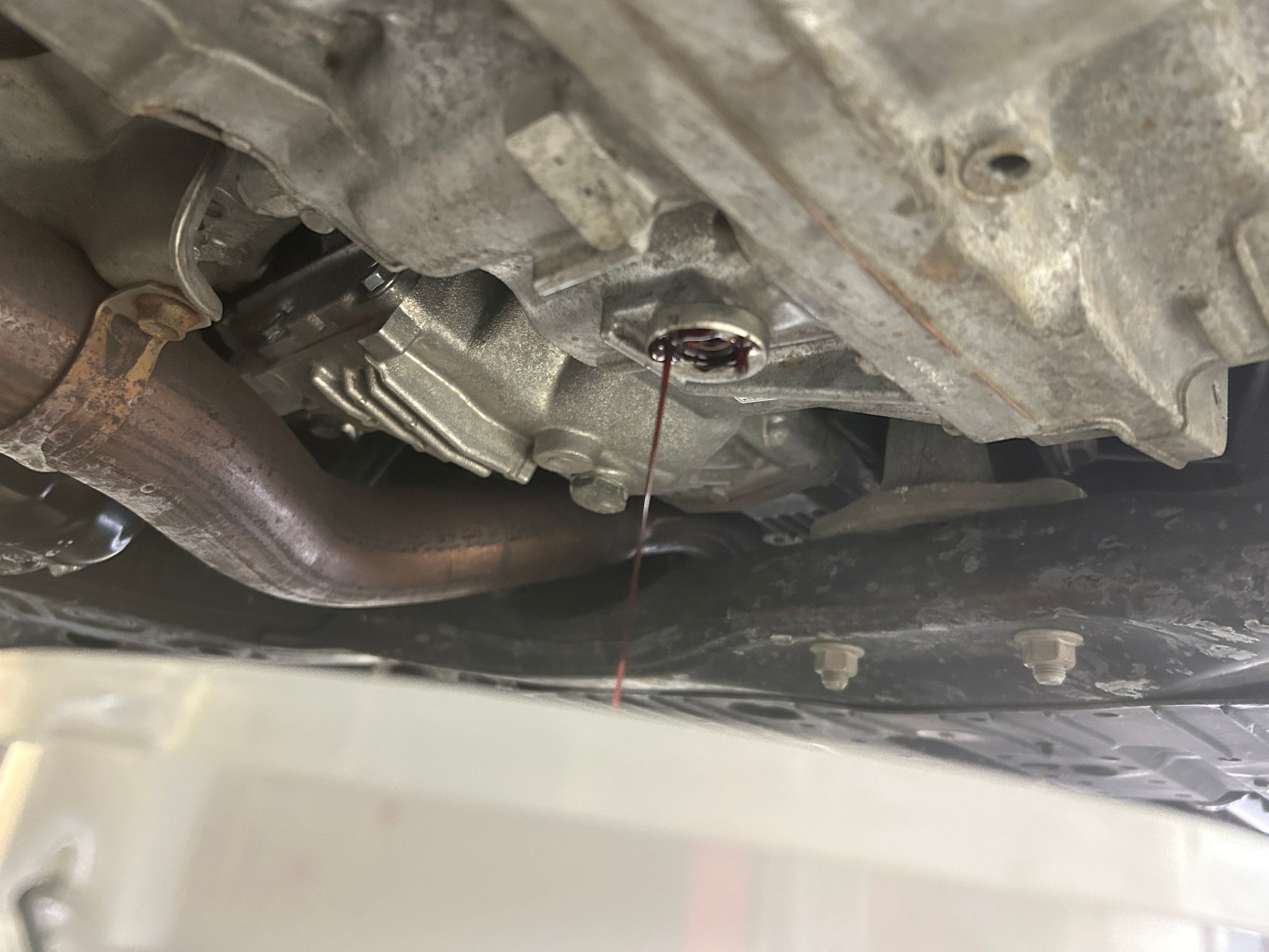

Well I just completed an ATF drain and fill on my 2020 RX350.
Vehicle has 57284 miles on it. Check out the fluid pics before and after.
Followed the procedure in the video posted by Viktor above and the Car Care Nut on his YouTube channel. They both recommend a one time drain and fill at 60,000 miles.
The procedure was relatively easy....would have been easier with a dipstick, but those days are gone. Slightly more complicated than changing oil but not difficult with the correct tools.

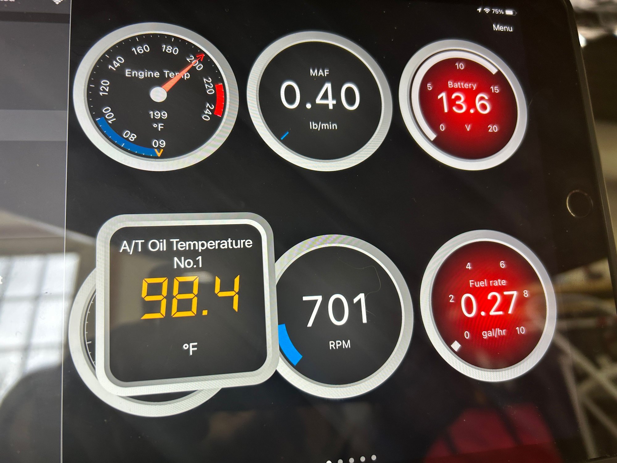

I used my OBDii that can read ATF temp on Lexus and Toyota. Need to do the overfill procedure between 95F and 113F. The OBD and Fusion software worked perfectly. I actually have an infrared temp gun and used that to compare. It was consistently 5 - 8 degree F lower than the sensor....just an FYI is you try that method. Make sense since the heat must conduct through the metal housing. I was surprised by how much time I had to do the overfill procedure. The AT temp does not rise super fast, so you have plenty of time to complete the easy step within the window.
As discussed at length previously, many choose to not do the ATF drain and fill. That is your own decision. We owned a 2010 4Runner that the dealer refused to do the ATF. Said that it was "lifetime". At just over 200,000 miles that transmission began to slip. They said that it was not covered b/c past the PowerTrain warranty. So don't expect Lexus to replace your transmission if your fluid causes problems. I will do this for my Lexus and our NEW 4Runner every 60k or so. We keep our vehicles for many miles and many years. My Acura TL ran to 305,000 and I did the ATF drain and fill about every 50k with no issues.
Attached are a few pics.
If you are DIY and have access to an accurate temperature method with OBD or the other method that Viktor showed, then don't let the procedure scare you....very straight-forward.
Fill plug...mine was angled up a little. Would recommend a pump vs gravity fill from funnel.
Draining the overflow
Fusion software using Verbeek OBD....IR gun was about 5 - 8 degrees lower.
I like the one on the right better.
