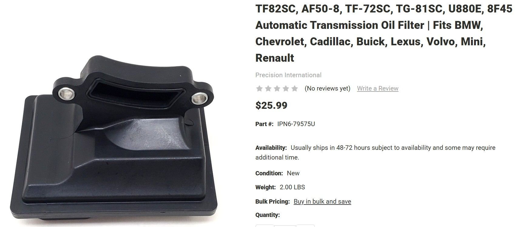

There is an internal transmission filter for the 4th Gen RX350's. However, the transmission cases have to be split to access it, and that is why it is considered a non-serviceable item.
The AISIN 8-speed transmission used in the 4th Gen RX350 is used by Lexus, BMW, Volvo and GM. Since the same transmission is used by several auto makers, that is one reason why some people are not married to "use only Toyota WS ATF".
