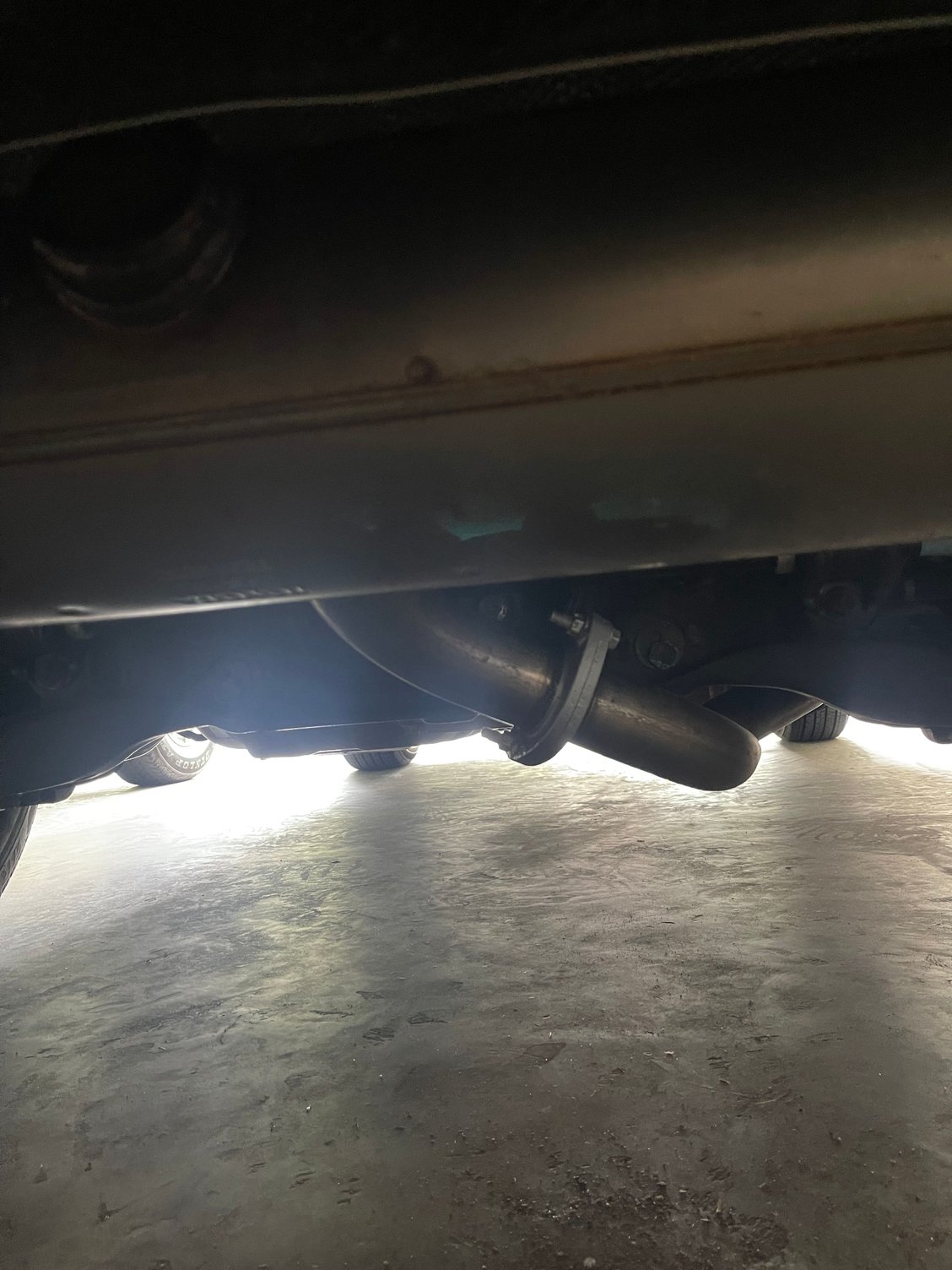

Hello,
I noticed the pipe flange underneath the car looking rusty. Is this normal? Should I be concerned. Less than 12K km. Maybe I'm being paranoid.

Normal as normal can be

I would be alarmed too, but I checked and mine is like that too.

Mine is almost like like that from Day 1. Normal. I sprayed a coat of Rust Check for peace of mind.

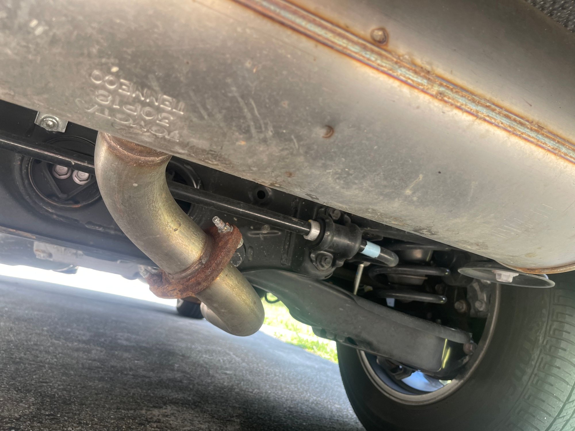

just noticed it on mine too in the past week. 14k miles. looks crappy...apparently not stainless. let us know if dealer does anything.

Mine looked the same, even after 8000 km.

Hi there. Did you receive any feedback on this? We just purchased a 2021 RX350 and it looks the same. 18K on it. We noticed it a couple days after picking it up. I thought with the Lexus pre owned certification that something like this would have been addressed.

That’s absolutely nothing to worry about. It’s gonna happen on any car. It’s structurally sound and will be for a very long time. “Something like this being addressed” is like expecting them to clean the inside of your exhaust pipe to make it look new or put the the little rubber nubs back on the tires so they look new again.

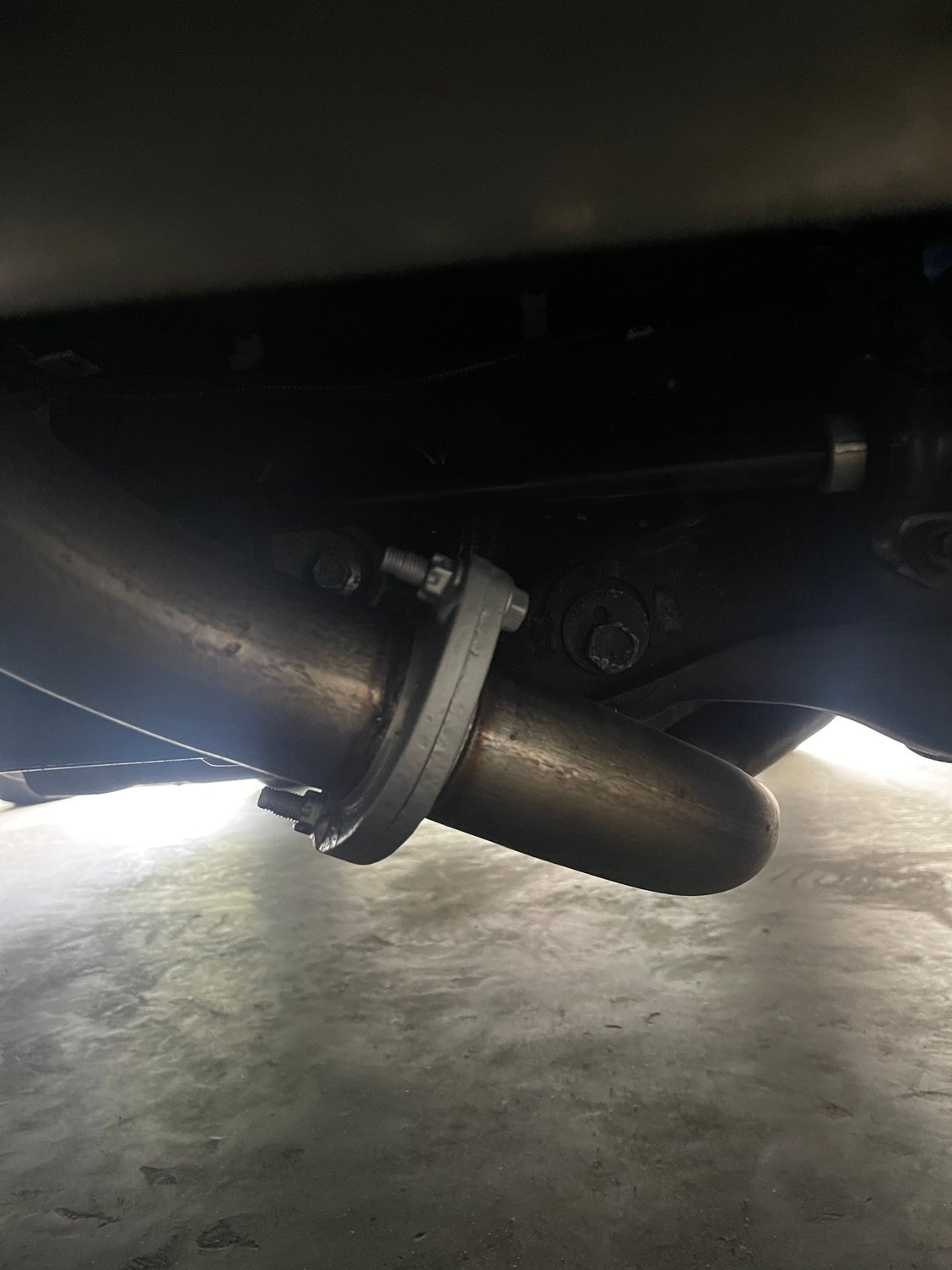

In case you haven’t fix yet or this can be useful to anyone else
take 50 or 80 grit sand paper and sand off most of rust, then clean with rubbing alcohol let dry. Mask off area and only use High temperature Muffler Manifold Spray Paint that is Fire Proof !! (Do Not !! Use Engine because it could catch Fire)
(Do Not Use Engine Paint)
