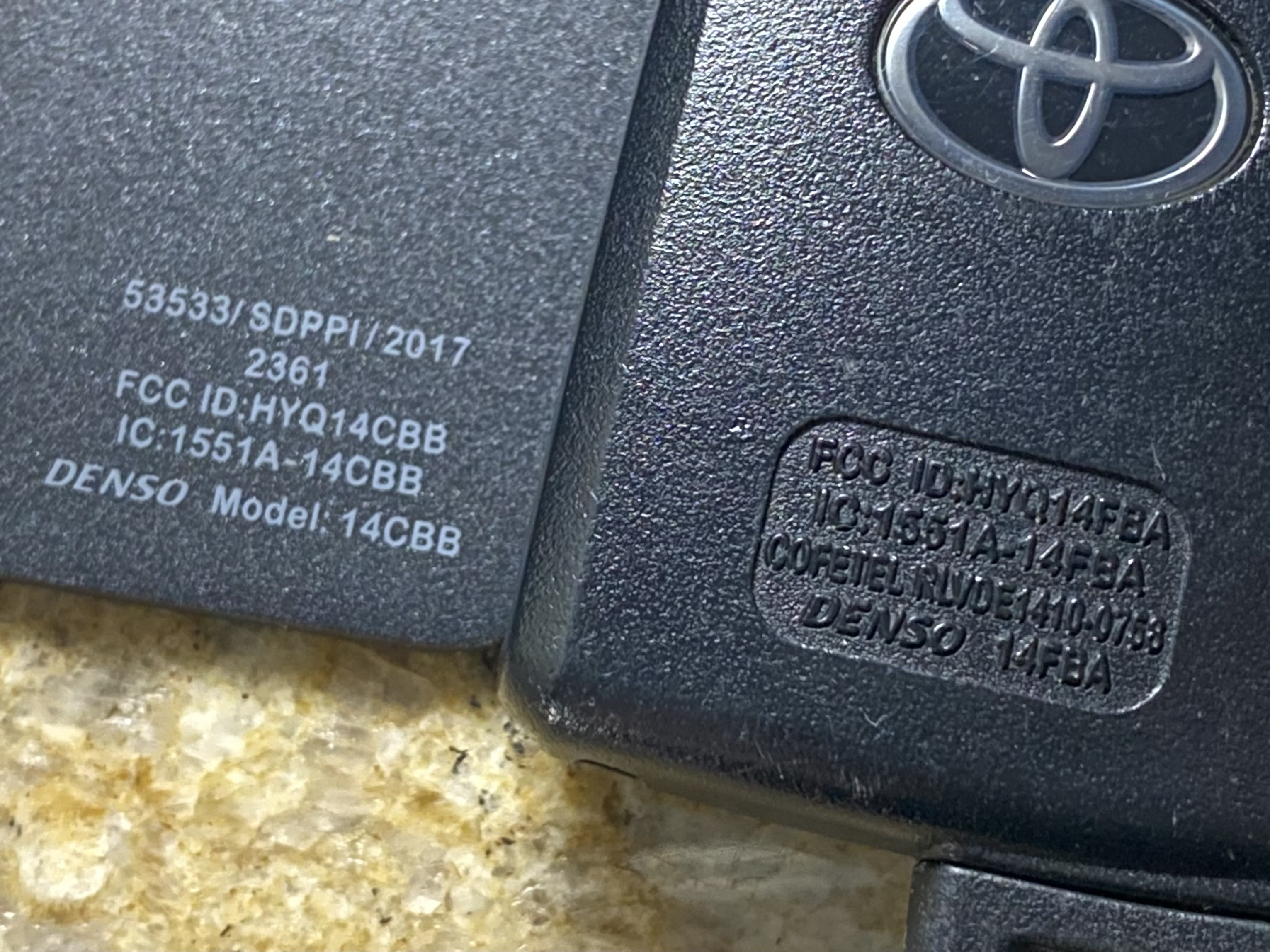

Originally Posted by na1ddo
Hi all,
Luckily for the toyota land cruiser forums, they have been having issues finding a smart key for their 2020+ land cruiser heritage model which has the same FCC ID as our 4th gen RX350s. I decided to take a small leap and buy the key in hoping it works, and it did.
Here are the part numbers I've ordered.
89904-48Q90 Smart key69515-30350 Physical Key
Here is the pic of the keys. They had no issues programming it at all. Nice and easy.
Thanks for reading! I hope this helps a lot of y'all!
na1ddo
Hey na1ddo, thanks for posting this! I purchased a used key with the same FCC ID. I will need to use an unlocking service to reset the key to 'virgin / new' status so I can register it. Will update if it works for me once I get around to doing it. Thanks again for your help!

Originally Posted by wSoL
I'm crossing my fingers for you and hopefully it goes back to the 2016 models!
2017 Land Cruiser owner here, Lexus card key programmed via techstream. Card Key p/n 89904-53512 and Blank key 69515-50220. This setup works for 2016-2019 Land Cruisers and I would bet this would work for your model year RX. FCC ID did not have to match for my application.

Default Key Card Success on 2020 RX
So I did some more research on this, and ordered a key card for my 2020 RX 350 and can confirm success. I ended up ordering a key card with FCC ID HYQ14CBK. I decided to go with this FCC ID based on na1ddo's success above. While I'm not sure my methodology is correct, this is how I believed I had ordered the correct card key:
I looked up the Keyless Entry Module part number for my 2020 RX (899900E190). I took that part number to eBay and found a picture of the part which shows the model number is TMLF15-2, with an FCC ID of NI4TMLF15-2, which matches to the same model number/FCC ID as the 2017 RX keyless entry module that na1ddo has. I wasn't sure if mine would match or not since 2020 models and newer got a slight refresh. Based on this information I decided to give it a shot and ordered a key on eBay. I figured if it didn't end up working that seller (virginkeys) offers a 30 day return window. Programming was very easy in Techstream and took about one minute. I haven't used the card key much since programming, but I didn't have any issues with range and can unlock/lock easily with the card in my pocket.
I was initially going to purchase the key Kenvin had posted (FCC ID HYQ14CBM), and am not sure if that one will work or not. I messaged that seller (unlimitedpro13) asking to confirm if they do indeed program with the RX. I received this response: "Hello. We list our keys only from our experience. We successfully program these keys to 2020 and 2021 RX models" So it sounds like the CBM key may work, but unsure. Either way I'm happy knowing that the one I ordered is working, and thanks to na1ddo and Kenvin for posting and providing their assistance/success!
Not sure if this helps anyone, but the factory key fob that came with my RX, that FCC ID is 1551A-14FBB. It appears that the FCC IDs do not need to match in order for the key card to function.
