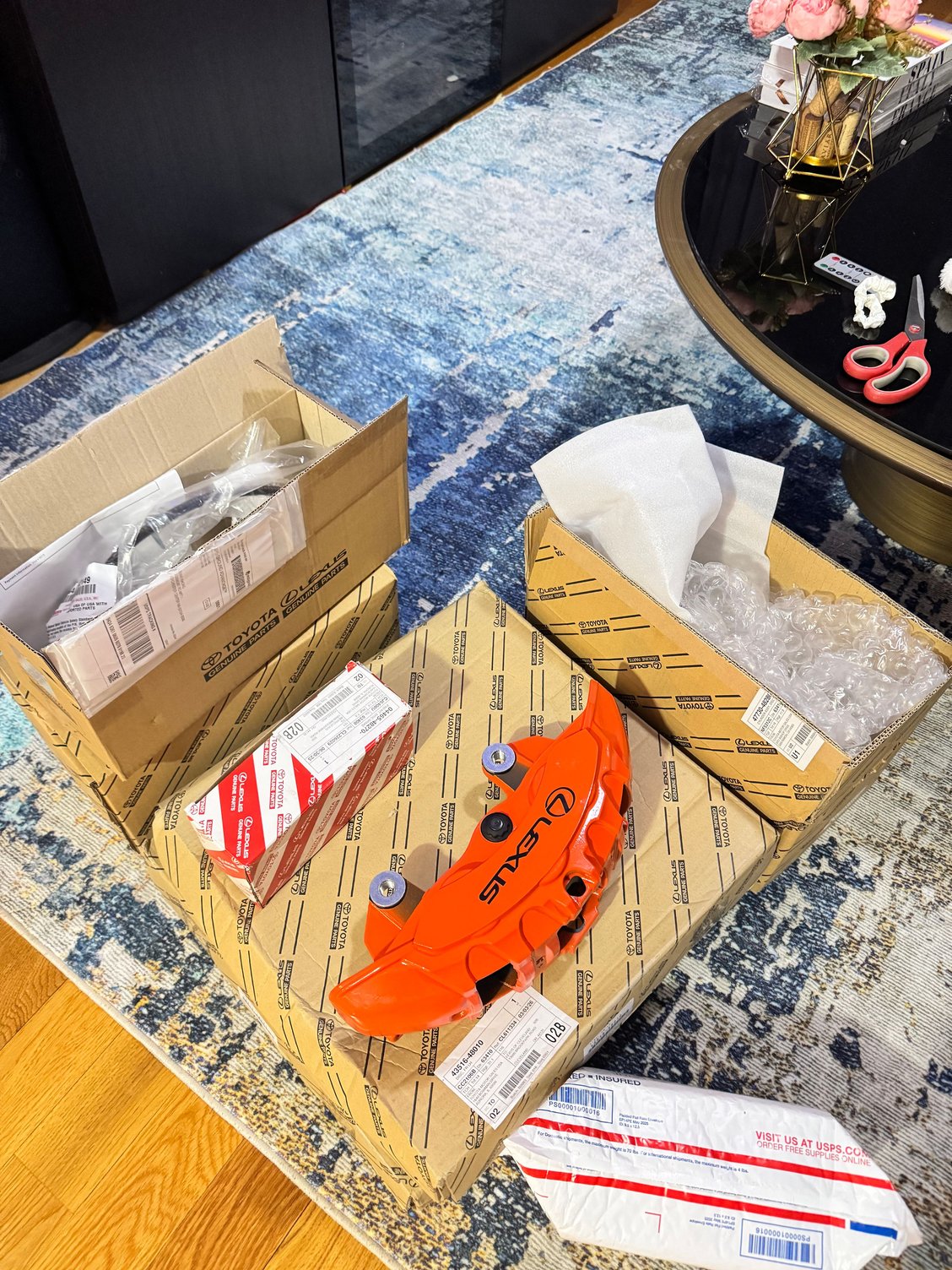

anyone in here doing the BBK upgrade? My 21 F sports requires all new brakes and rotors at 55k miles so figure to spend a little more and upgrading to the 500H BBK. These calipers are the orange for 2026 limited edition.

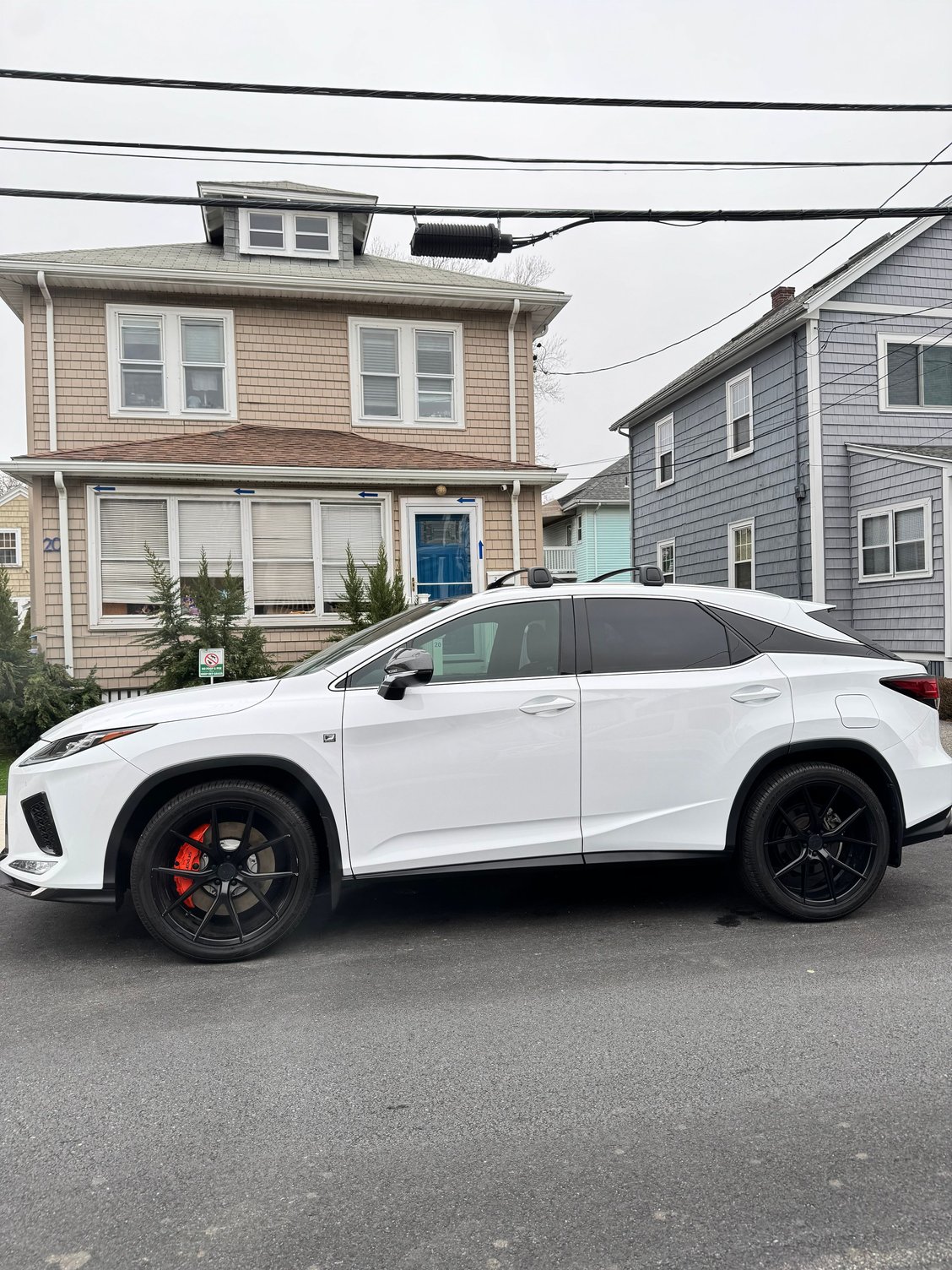

Just installed them today by a buddy. I’m very happy with the result as I plan to keep this car until it dies

Mar 31, 2026 | 09:36 PM
wow so 5th gen calipers are a direct fit? how big of a performance upgrade did you notice?
Reply 0
Apr 1, 2026 | 05:57 AM
Quote: wow so 5th gen calipers are a direct fit? how big of a performance upgrade did you notice?
Yes it is direct fit. Just need wheels size 20 at least. Braking is noticeable difference, especially my old brakes were already almost next to nothing left.

Apr 6, 2026 | 04:13 PM
Where did you order the orange calipers from?
I'm trying to go for the same look!
Reply 0
Apr 7, 2026 | 06:42 AM
lexuspartsoutlet.com, good luck getting them though cuz it was a struggle since these orange calipers are very limited. The black ones are widely available and you can paint them of course.
