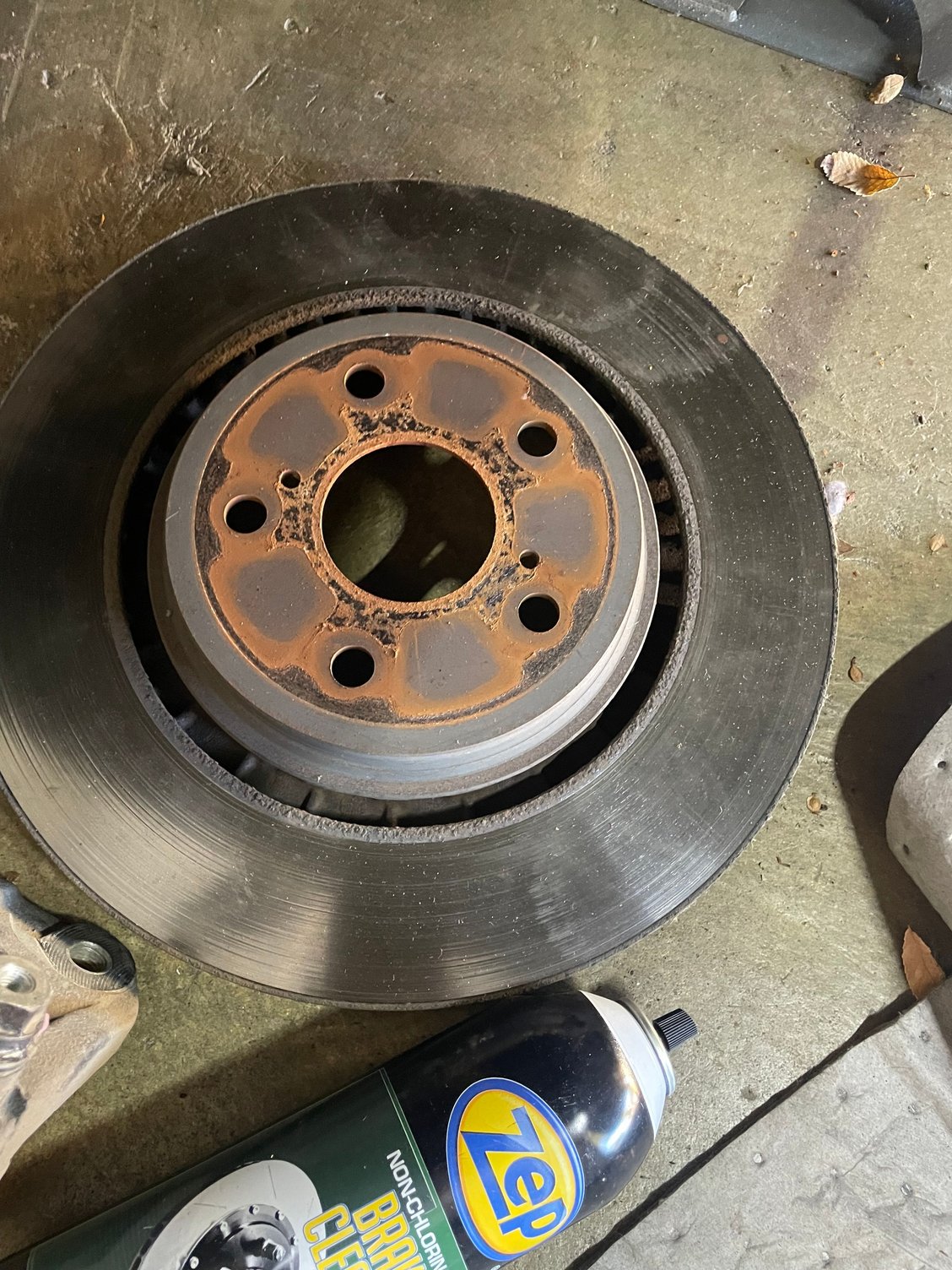

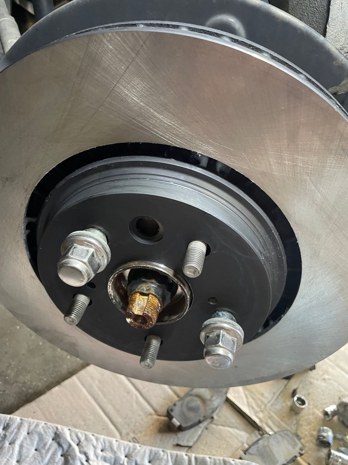

I just got time to change my front brake today. saw one of the rotor have extra hole in it. i thought that hole is to adjust the rear brakes? i checked both box same part number. one rotor don't got the hole and this one have hole. the old ones doesn't have a hole in it.

where did you get them? could have been misboxed. looks like a rear rotor to me.
is it the same diameter and width as the old one?

My Lexus RX front rotors do not have a hole as shown in your top pic. Look like your lower pic.

Bizarre.. I would measure the thickness and that would give you an idea if it's front or rear. Fronts are usually thicker by design.
Specs from RockAuto for reference:
-Front nominal thickness 28 mm
-Rear nominal thickness 18 mm

I have seen the extra hole in OEM replacement brake rotors several times. I think that during the manufacturing process the equipment is machining the hub sections of some brake rotors the same for front or rear rotors.

Multiple different vehicles might use the same rotor but require the use of a mounting bolt (BMW use them). The Raybestos rotors I just put on have the hole also. Not a big deal and does not affect the capability of the rotor.

I suspect these rotors might also be used in newer RX models that use lug bolts instead of lug nuts. If that’s the case, this hole is designed for a screw that holds the rotor in place until the assembly is complete.
