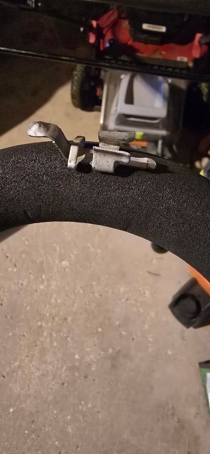

Old Jul 26, 2025 | 05:58 PM
Gerard73's Avatar
Gerard73
10th Gear
Joined: Jan 2025
Posts: 11
From: WI
This is what the clip looks like. I did not put mine back on. I replaced the plastic housing with part number 15620-31060.
