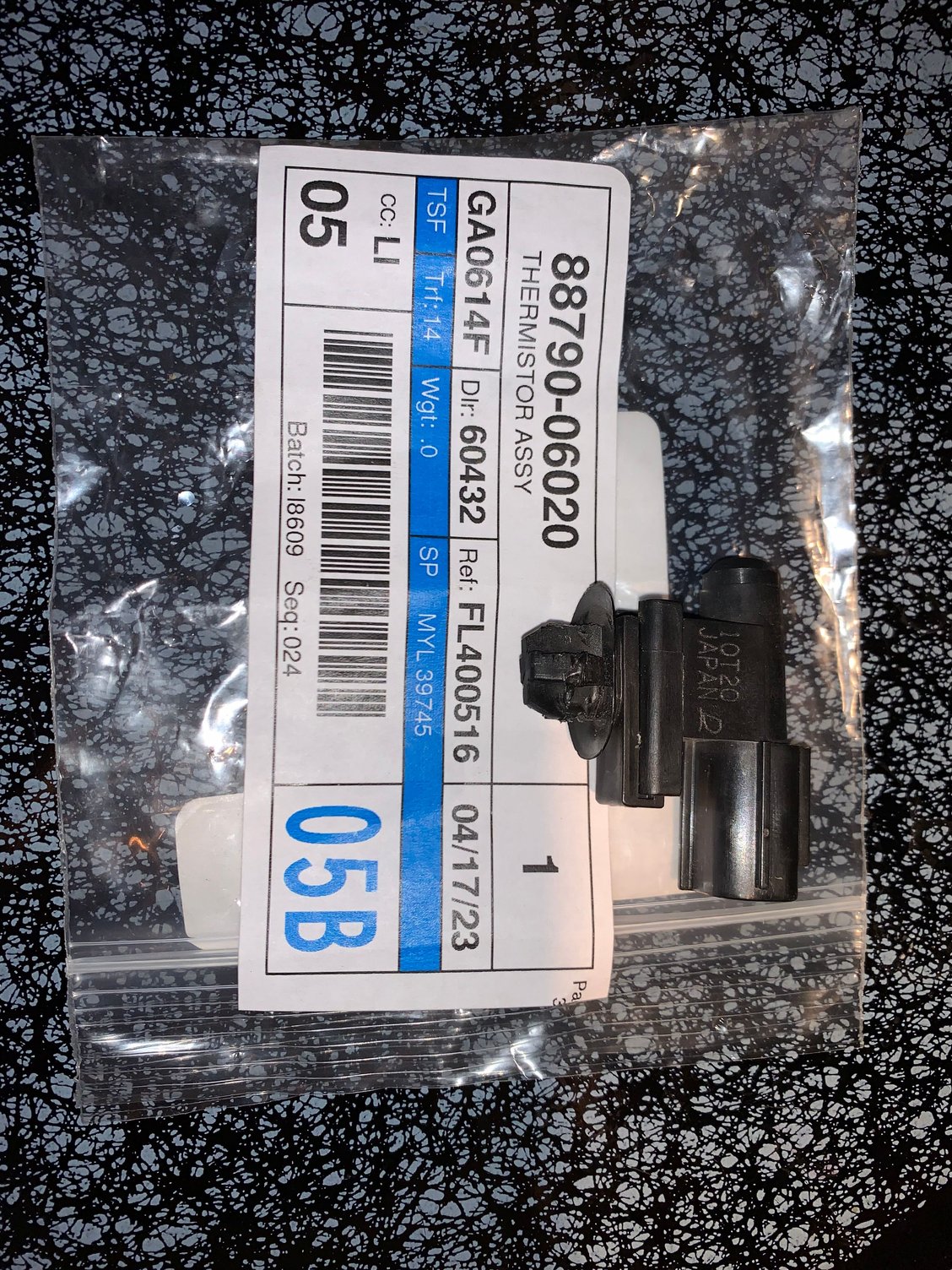

I needed a very small pliers to remove the old one since you need to press in the 2 small plastic tabs to release the unit from the metal hole. It's located in front of the radiator, but lower down. It is an OEM part. All it has imprinted on it is "1 of 13" and "Japan" (reminds me of seven of nine from the Borg). It was identical to the one I removed (see picture of removed part and the new part package). I haven't driven the car yet to test it but will let you know if it does not work.

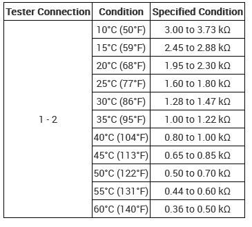

thats odd. have you tested the sensor? heres the chart if you need it. I would just grab one from a junk yard, you might get an older (better quality) part. just cross ref. the PN.

Looking at the chart that was posted…that’s a pretty significant tolerance. Like plus or minus 10 percent resistance for a given temperature.
If you have contact cleaner like Deoxit, it’d be worth trying to clean the connection there. Put a little into the female side, then plug and unplug a few times. Then before the final reconnection put some silicone dielectric on it (avoid the pins or female holes, if possible) then plug it back in.
