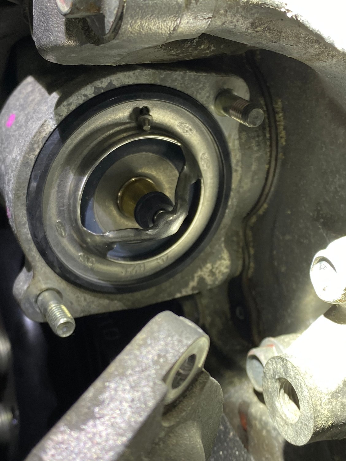

Found the thermostat was stuck open and wasn’t moving at all in hot water. Got that replaced, tomorrow I refill the system and find out if it fixed my issue.

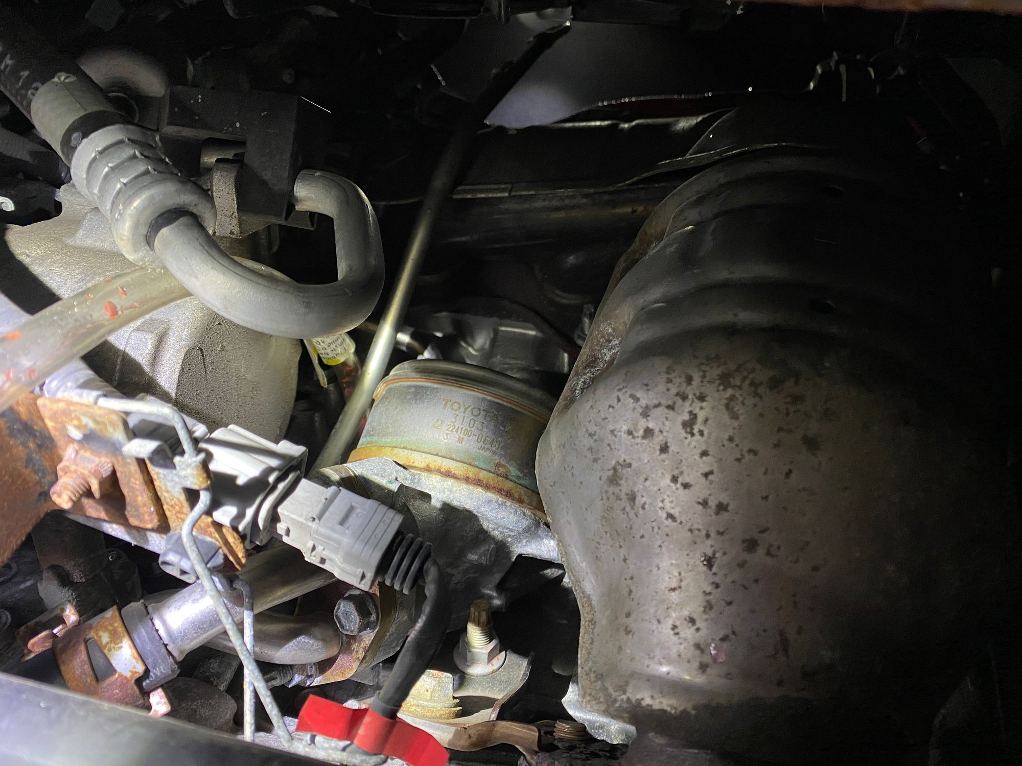

Getting to the thermostat required the removal of all the engine bay covers, disconnecting the main engine harness and moving the connector out of the way. The thermostat housing is tricky to remove with one blind nut, and limited access with a hard AC line in the way, so having a small inspection mirror helped understand where everything was.

Engine harness disconnected and moved out of the way. Plastic bag is covering the computer and a latex glove is covering the harness connector.
Thermostat housing
Old thermostat stuck open
New Denso thermostat
New thermostat in place
Intake piping and engine bay covers removed. ECT sensor is right behind the inverter.
ECT connector unplugged. Located right in the middle of the V at the back of the engine next to the heater hoses.
Old sensor removed. 19mm wrench required. My deep socket bottomed out and couldn’t reach the nut.
